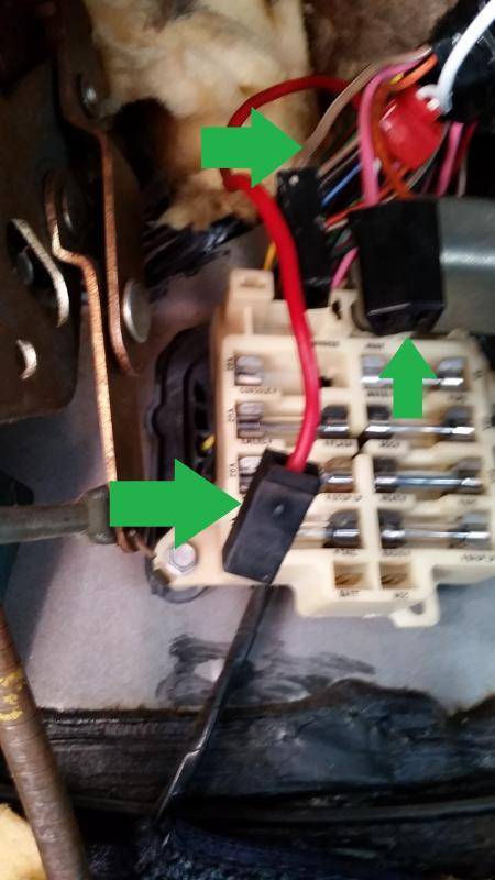

Feb 24, 2015 #1 M mickfl New Member Joined Jul 11, 2014 Messages 16 Reaction score 4 Location Fort Lauderdale Good morning, Does anyone know what these are for? I'm hunting down a lead to connect my gauge's illumination to and these were tucked up into the harness. Sorry if its a little blurry.
Feb 24, 2015 #2 68-300 Active Member Joined May 6, 2014 Messages 287 Reaction score 180 Location Herkenbosch, Netherlands The dual pink/orange connector is for a console, pink in continues 12V and the orange is switched 12V from the light switch, that's the one you need.
Feb 24, 2015 #3 M mickfl New Member Joined Jul 11, 2014 Messages 16 Reaction score 4 Location Fort Lauderdale Thank you Sir! I'm not a mechanic - I'm learning a lot and having a great time with my dream car!
