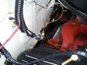

i extended off my existing oil pressure gauge hookup spot on the top rear of the block by the firewall. I got a brass T and a 6" long 1/8" male/male brass tube. the bottom of the T with 6" extension goes to block, one side goes back to my regular oil gauge, and the other side is where the pressure kill switch is.
switch:
(S) = i wired to starter solenoid. This will run the pump when you are cranking.
(I) = i wired this to the heater fuse in the fuse box. Something that comes on only when the key is turned and you are driving down the road.
(P) = this is going to go to the relay #86

oil-pressure-kill-switch.jpgoil pressure kill switch and brass T fitting

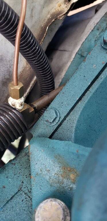

this pic is for furyus67 - he wanted to see whats doin at the T -
if you think of a capital letter T, I have the T on its head / upside down. left arm has a 6" threaded brass tube extended down to the oil hole in the top rear block back by the transmission. right arm of the T under the wireloom, is the P/S/I oil pressure kill switch. The stem of the T | is what you see with the Teflon tape and brass tube going upwards and out to the interior cabin wheres my cheap oil pressure gauge. Take the plastic tube that comes with the oil pressure gauge and throw it in the trash and then go buy 25' roll of tube and swap that out.
