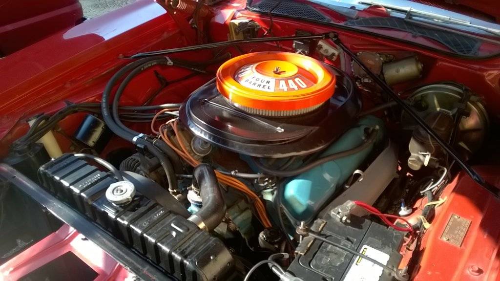

I went this route cause I didn't want a bunch of modern lookin stuff in plain view. BTW, on my hippy van with a /6 when I bought it was told that it had points. I bought a complete electronic ignig system for it and I couldn't get it to work worth squat. Van ran like crap, looked at the stock distributor and found that Pertronix was installed in it. I ripped out that electronic crap and put it back the way it was when I bought it, and never have looked back. Good Luck
