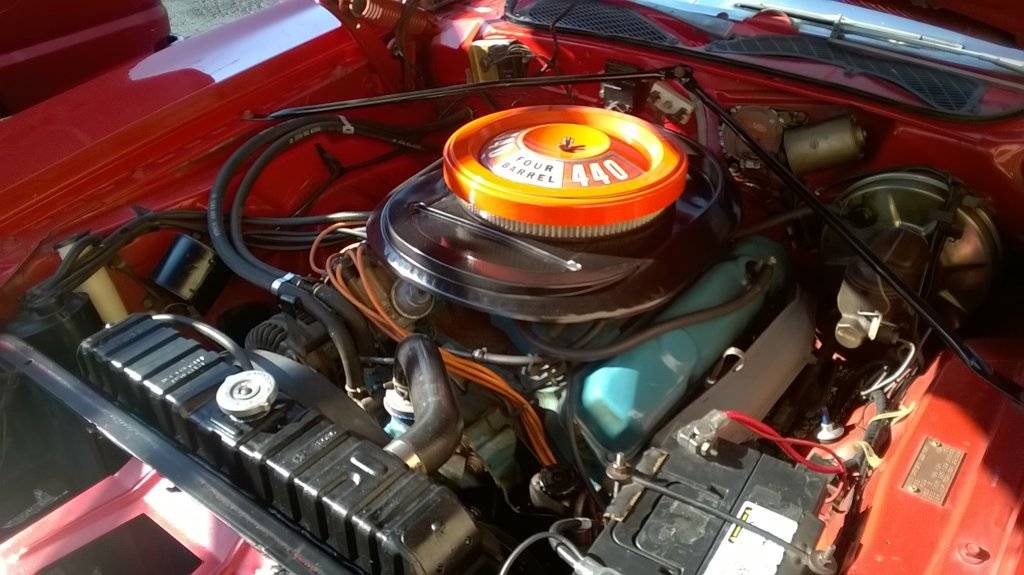

Any ideas on the ideal mounting spots for the ECU and updated VR?
Indeed, it is a great idea. I wrestled for a year on the 413 in my 300L because of 'pinging'. After the conversion, with its new distributor and advance systems, car was docile as a kitten. Hid the orange box under the battery so it didn't show. Also, after more than a year of owning a 300F with it's factory tach drive oem distributor, I was surprised to find the restorer had replaced the oem points platform with the guts of the EI from Mopar and put the orange box under the battery tray. Clever!
