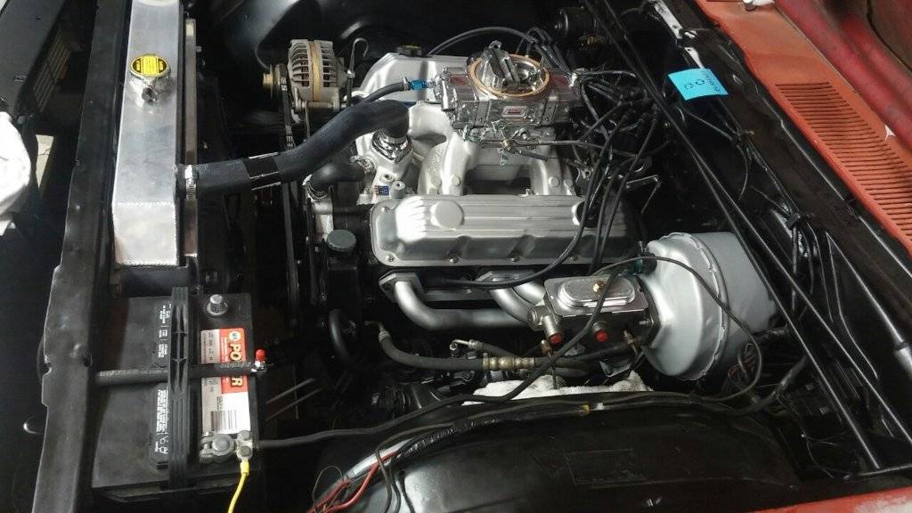

This is my " 318 " now closer to 331ci and trust me no STOCK big block wants any of this screamer. Best advice drive it enjoy the hell out of it and don't worry about what other people think. BigBen

Wow. I didnt see your post, my apologies for not getting back to you in timely manner. The Sanderson DD-7 p headers I ordered were listed as best choice for A body Car with 318.
But I took a chance and ordered them figured if a tight spaced A body would accept them then surely the biggest Dodge of the day should be an easy fit. As the man once said " I love it when a plan comes together"

I never started a thread. My car was basically a rolling unibody with a hole in the block. Shattered front suspension from what appears to be hydraulic hopping, ruined interior and half the mechanical parts missing.
The only reason I saved it was the body had absolutely no cancerous rust. It has a little surface rust from some nut sanding and never priming spots. But I hit those with rust convertor chemical and put an end to that.
My friends and others that worked on it or parts for it are all people that I grew up around.
The engines rotating assembly was done by Mr. Gene Hurst who built engines for my Dads repair shop. We started with 318 block .060 overbore.
With Keith Black hyperkenetic pistons, the block was zero decked to the pistons a forged steel 340 crank. Late model rods block line bored. Balanced and blueprinted.has a comp cam extreme energy cam. Gene guarantees its good for 7000 rpm. Gene is still hot rodding and he is 82 years old.
The heads are magnum style heads by engine quest out of Australia. They rework the valve angles open the ports and eliminated the cracking problem inherent to magnum heads.The valve train and minor port work was done by my best friends son( Jordan Betts of Betts custom fabrication Anaheim CA) Who learned flow benching and porting at a school for NASCAR mechanics. The transmission was " Bulletproofed by my friend Keith Betts of Kenne Bell Buick. He used to make The Turbo 400 switch pitch transmission for them. He is a walking transmission Genius. The rest of the repair.replace. rebuild and fab work was done with my great friend Jim Betts.
From front to rear bumper EVERYTHING..EVERYTHING! under that car is new or rebuilt down to the smallest rubber suspension bushing. It haa 4 wheel disc upgrade, Custom built exhaust. Coilover rear shocks. 2400 rpm stall convertor. Quick silver shifter. And lightened considerably. Carefully chosen 17 in rallye wheels on 275/40zr 17 sumatomo. Tires all the way around.I took the time to make sure every part was custom matched to compliment each other and provide trouble free power. This is a sleepy looking Super cruiser.
Designed to own and embarrass big block cars of the era.
