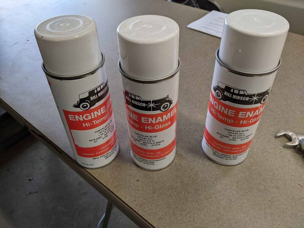

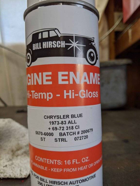

Regardless of whether it looks good, I won't like it. It does not match the original paint. I ordered the Petty Blue Bill Hirsch paint that you and @ayilar co-recommended.:thumbsup:
Bill Hirsch Paint. So is the turquoise right for 1970-1972 non-HP Big Blocks?

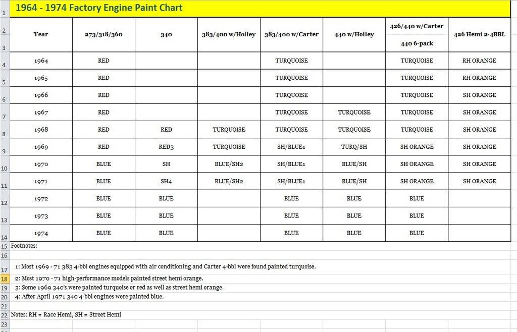

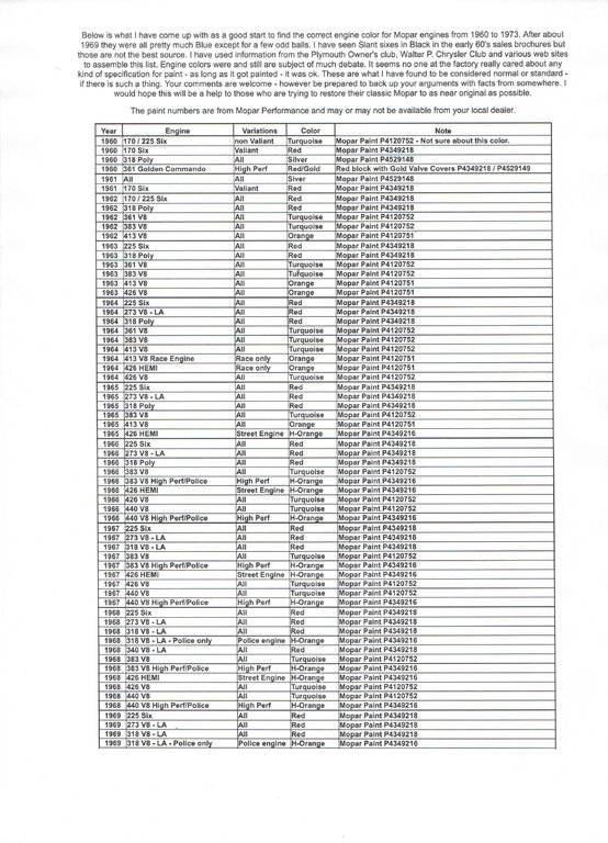

Found this on FABO by Halifax Hops
1964 - 1974 Factory Engine Paint Chart
1970 BB is Chrysler Blue. That is why I got the Bill Hirsch paint even though the manufacturer's cans and website mistakenly say it is for 1973-1983 engines. I spent a lot of time on researching the issue, I am confident that I have the answer. I am not saying to get Bill Hirsch paint necessarily, but the color is (close to?) the correct one.

Since you have disagreed with 3 of my posts in this thread, but haven't commented. What do you think of the charts above and below from FABO? Both disagree with Bill Hirsch on when blue was used on small blocks. They say red through 1969. For BB, the chart below, also from FABO, shows turquoise thru 1971. Don't care if you disagree with me, as long as I learn in the process. Ben

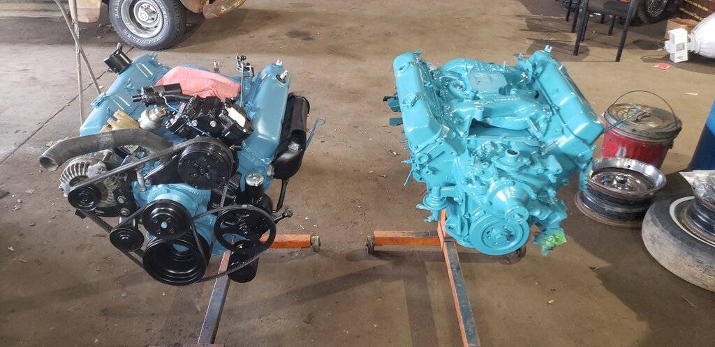

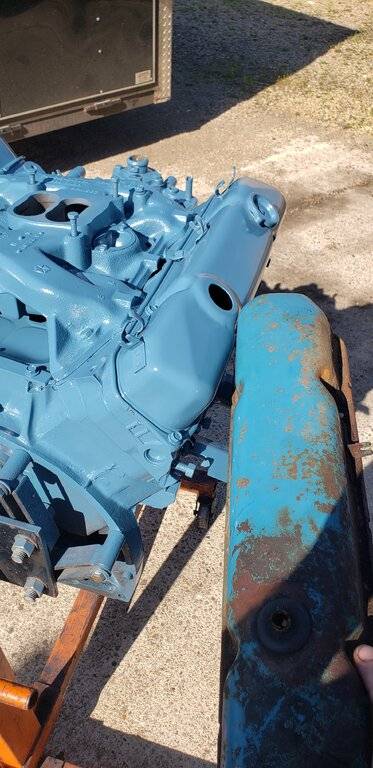

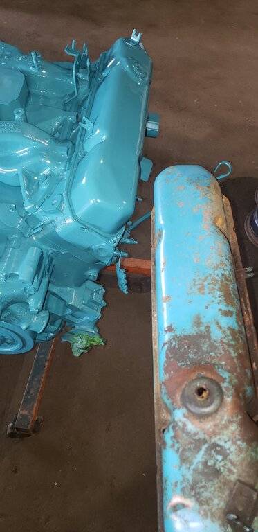

To me VHT is the closest match to the original color used on 70-71 engines, and at half the cost of the other stuff it is a no brainer. Sprays nice and even. No complaints about the product, and will continue to paint my engines the "wrong" color.

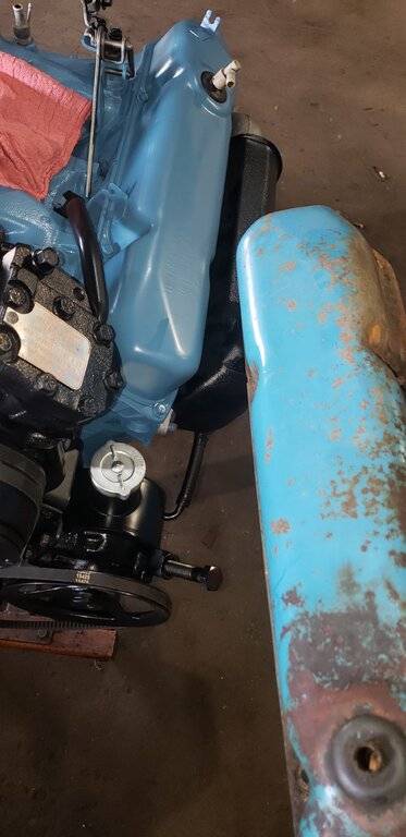

Hirsch stuff is good but ends up too pale, however the VHT does not and ends up looking closer to the valve cover used for comparison.
I wish I had a 3rd engine in progress during this experiment to test the Mopar paint side by side with these two.
At the end of the day the beauty is in the eye of the beholder, both paints are good quality and do the job. I recommend and prefer the VHT SP126 because the availability, price, and finished result are unmatched and resembles the original look especially after its all dressed up and in the car.

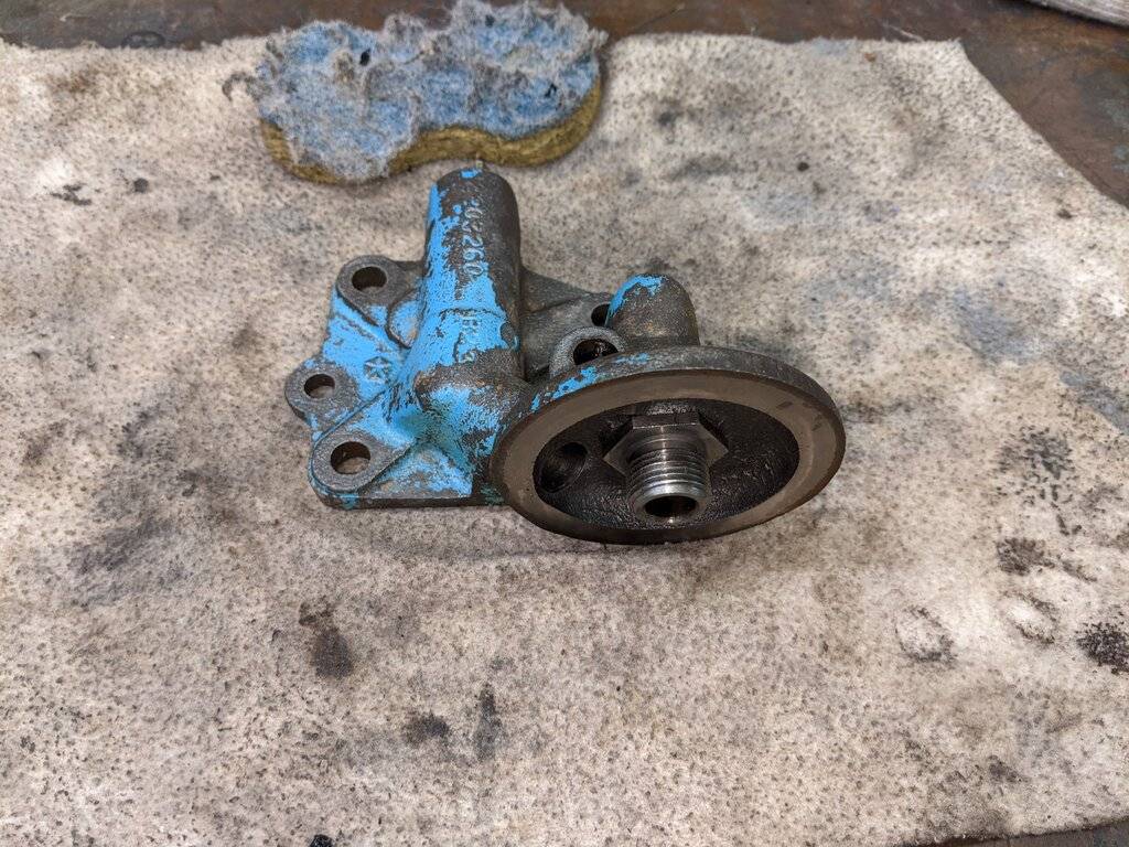

I guess it is lunacy of me to expect the paint to match the color I can see on a valve cover now, because the color changes with heat and age. In this case it becomes a brighter blue with less gray or green tint.
Here's a 1968 big block piece that was covered with oil. Doesn't look turquoise after 43 years.

In the directions for Bill Hirsch paint it says: “wait at least 2 weeks before starting up engine. Starting up an engine where paint has not fully cured or where there is too much paint applied, may cause wrinkling of the paint.” This is the 1st time I have seen a paint that requires 2 weeks to cure.
In another place it says: is Bill Hirsch engine enamel resistant to gasoline and oil? Yes, unlike the others, Bill Hirsch engine enamel is resistant to gasoline and oil. It takes about 2 weeks after the paint has fully hardened on the engine and cured for the finished to be gas and oil resistant.
My question is: have you ever used Bill Hirsch engine enamel without waiting 2 weeks?
I had intended to spray the engine enamel on an intake manifold, install it, and install the carburetor. Then start up the car. I didn’t realize on buying the paint, that I needed to let the intake manifold sit for 2 weeks before start up.
