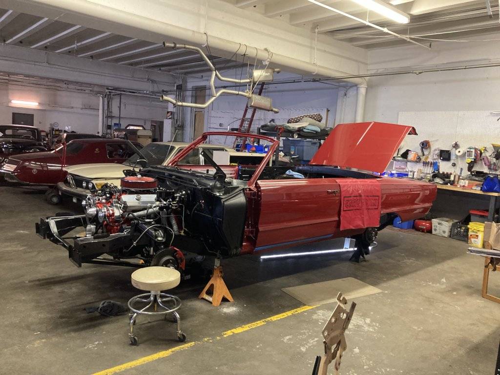

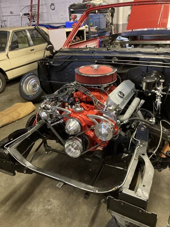

Hey CBODY67 thanks for your input… I did not get the Rams refurbished. I took the car apart in 2015 and left all of the lines and everything charged with fluid…. I bought new lines and recently got all the grime off of the cylinders and then blew out with air all the old fluid which looked to be ATF… cylinder seals look to be great and the ram actuates with air in and out just fine, but I totally hear what you’re saying. It really does boil down to what’s compatible with the seals…. thanks for the comment about the car. It’s coming along. Will be putting the front end back together where it will look like a car and then it’s time to start doing new electrical stuff… as you might notice from the pictures I am not keeping her original. She is getting updated with fuel injection electric fan fuel pump for said fuel injection disc brakes in the front and modern LED lighting… I have spent many hours looking into a sandblasting booth, standing in front of my bench grinder wire wheeling, and holding a Dremel tool in my hand, but it will be worth it when I’m done with it…cheers!

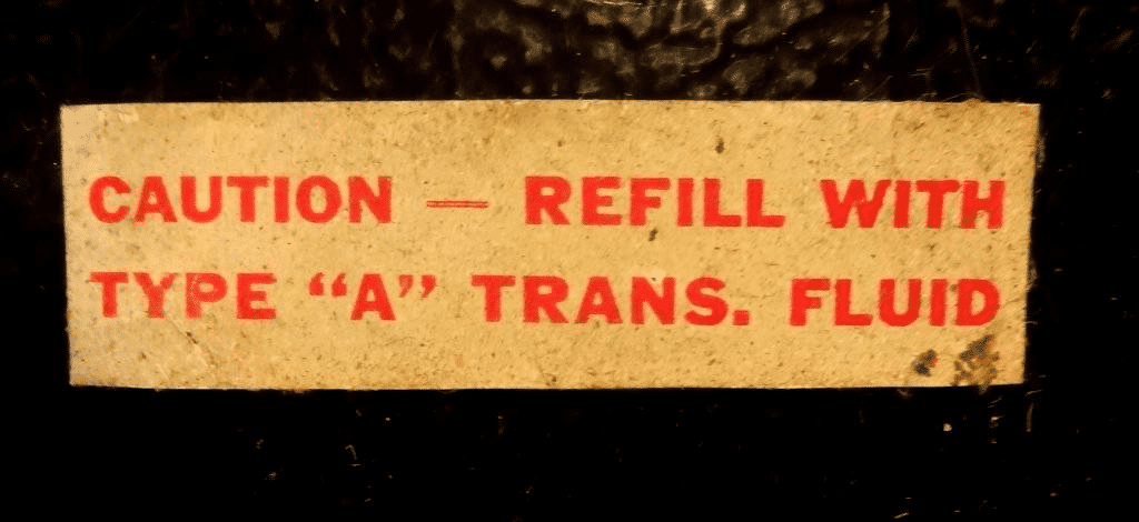

Usually there's a label on the pump. This is from a '67 Dodge. Type A superseded to Dexron and you can go down the rabbit hole of what superseded that.
