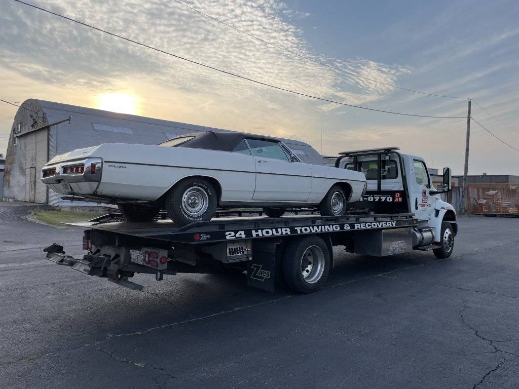

@71Polara383 can fill in more details, but hopefully this will be the explanation. Here is a photo of Snow White on the tow truck.
