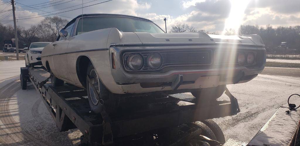

Meet Snow White, my 1970 N-code Dodge Polara Convertible

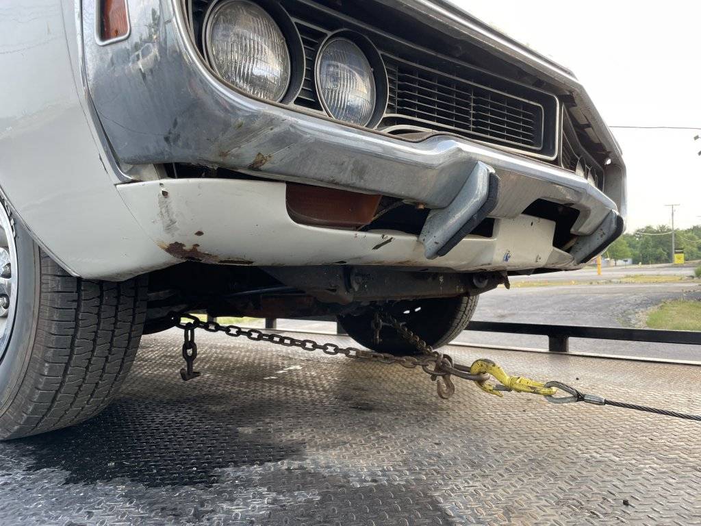

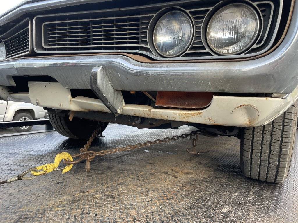

In related matters, Snow White's front and rear valances need replacing. The front valance is bent, as seen in this Dec. 11, 2019 photo taken by @71Polara383 (when the car was delivered for R&R):
(Edit, 6-25-2023: here are two photos I took yesterday, at the end of the Volo return trip)
The rear valance, in Wyatt's words yesterday, "is kinda beat up and it's got an 1/8" to a 1/4" inch of filler on it."

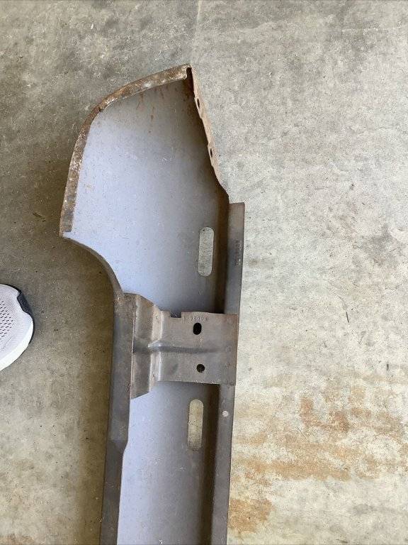

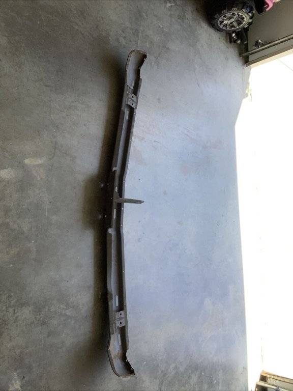

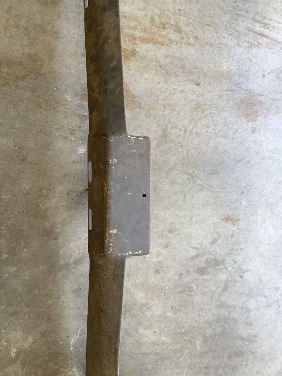

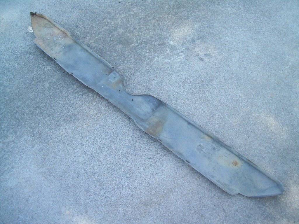

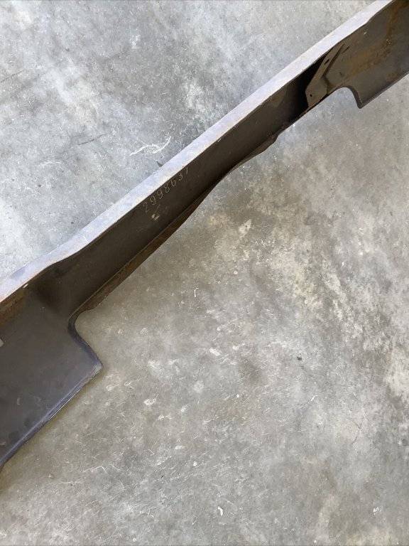

Wyatt and I had been looking for years for better valances, to no avail. Last week, however, Wyatt found two NOS valances for sale on eBay and I bought them. Here are some photos:
1. front valance P/N 2998637 (eBay):
(notice the slight wave, Wyatt tells me that it is easily fixable)

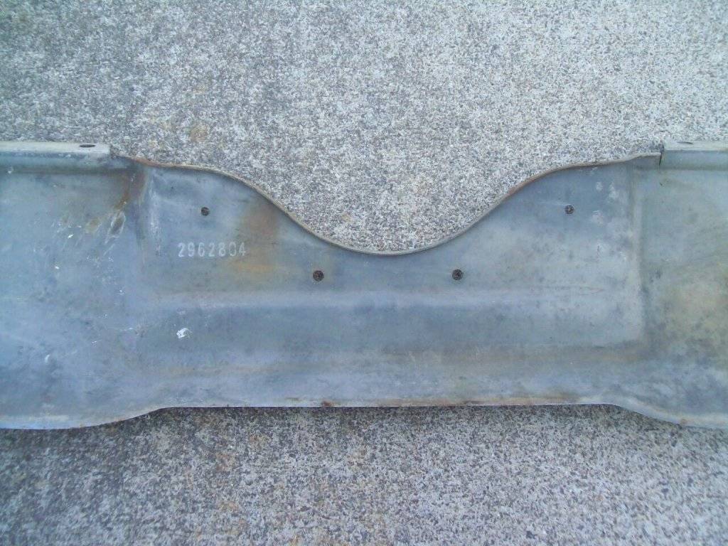

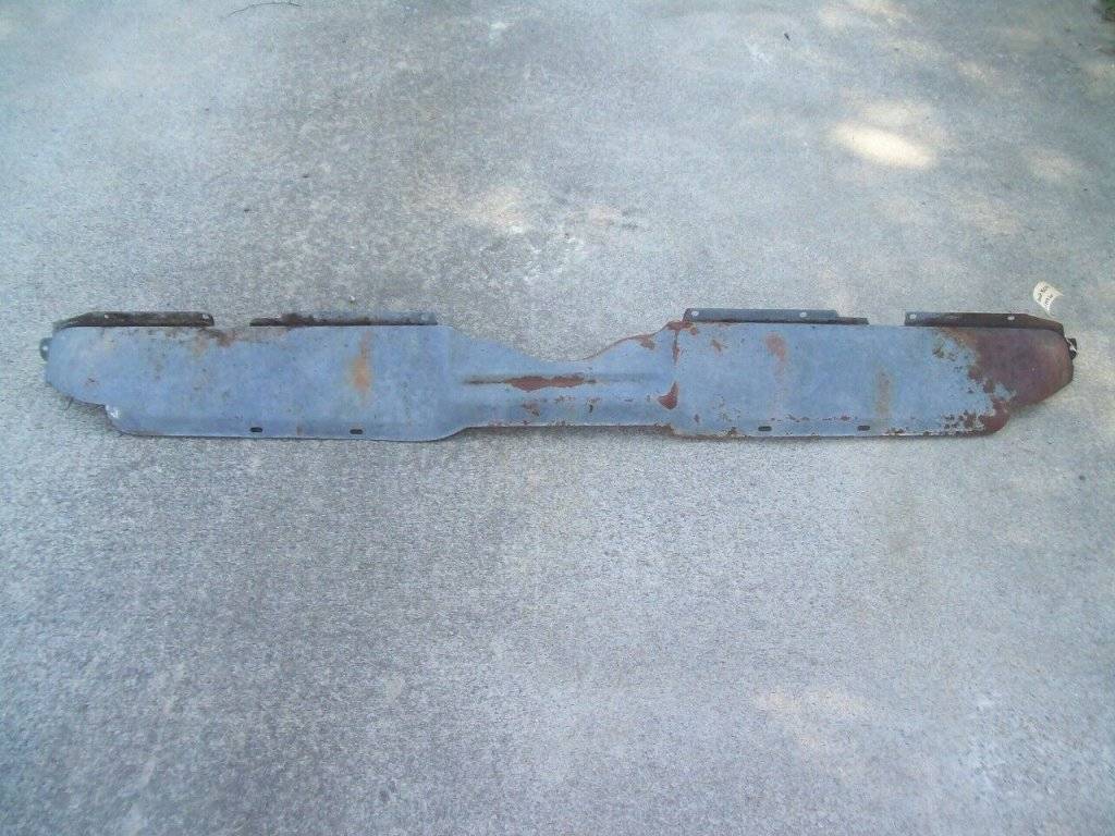

2. rear valance P/N 2962804 (eBay):

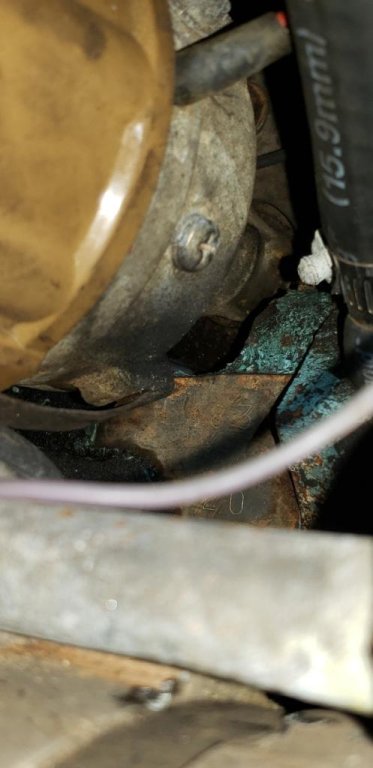

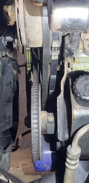

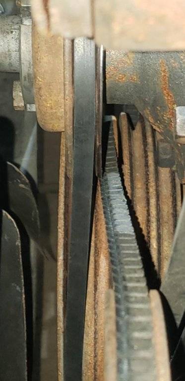

@71Polara383 has been chasing a vibration that was never fully solved/addressed on Snow White. A few days ago, he changed the harmonic balancer (using one he had saved from a car that he'd parted out, after Wyatt triple-checked that all the BBs with forged cranks use the same balancer) because it appeared to have slipped -- causing a misalignment of the pulleys. Things are lined up better now, so that was definitely an issue resolved.
Before (with the water pump pulley almost touching the power steering belt):
After:
Unfortunately, a vibration still persists. It's felt in park/neutral/gear, suggesting that it is engine/rpm-related and not coming from the driveline.

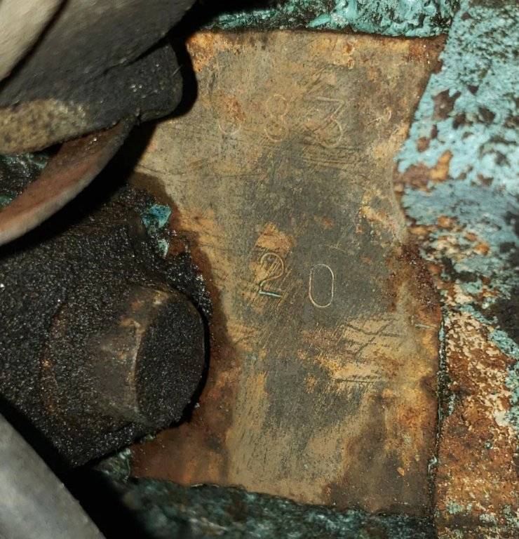

Is it the original engine? It was mentioned that the engine was rebuilt in it's past. Not unheard of shops grabbing a reman short block, maybe it has a cast crank.
Numbers matching.

I confirmed, when buying the car, that the engine is numbers-matching -- here are two photos taken by Wyatt on Dec. 11, 2019 (when he receptioned Snow White).
PS: I am adding two photos below, confirming that the engine is an F-date (1970) 383.
