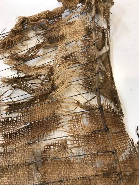

First, the wire stays going through the burlap (first layer). It is like spring wire, thin but wanting to retain its shape. I did some internet searches, but not sure how to narrow it down to find some. I don’t really know what to call it.
Any ideas?
Any ideas?
I'm guessing here, but try searching for: listing wire
The bows in a headliner are called that as well.
Hope the input helps.
John

I went to the local MACS Hardware, which has about 100 years of upholstery experience if you go the right day. I took in my spring wire burlap
To find out where I could find the spring wire. She had no idea, but they used to sell the burlap pre- made with the spring wire. But when they remodeled about 10 years ago they quit carrying it. She then called an upholstery guy who actually took the last ones she had to see if he had another source or a source for the wire. Nothing. The best part is nobody knows what this damn thing is called. The closest I got was burlap seat cover with spring wire. The measurement of the wire is .047 which is about 18 gauge. I googled 18 gauge spring wire on amazon popped up with high temper spring wire. I believe it is used for jewelry. I ordered 2- 46’ rolls for $11 each. I will see what I get.
Right after I ordered it I googled burlap seat covers with spring wire, and did find some burlap with inserted wire, but for a corvette bucket seat (too small).
Hopefully the wire I ordered will do the trick.

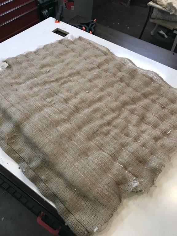

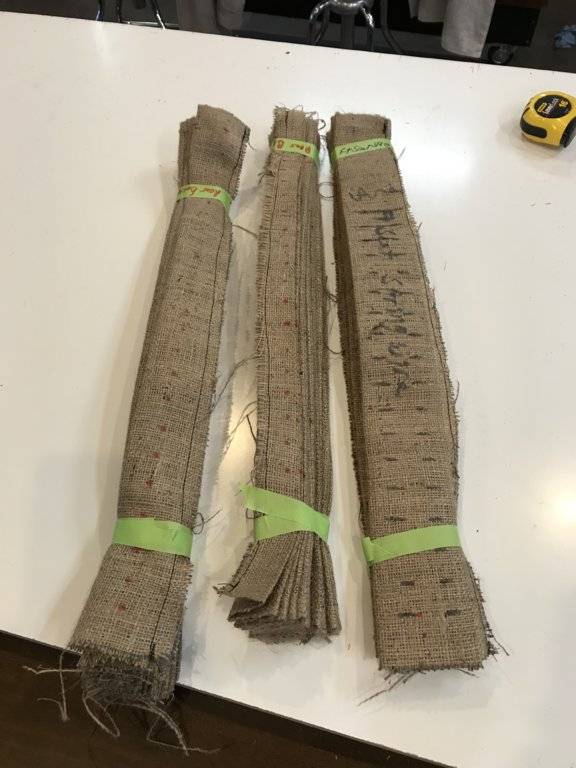

Cut out burlap for the wires. There are a lot of wires. 273’ of wire
I pleated and marked the burlap. I should be able to cut the wires to length and thread them through to get an even pattern.

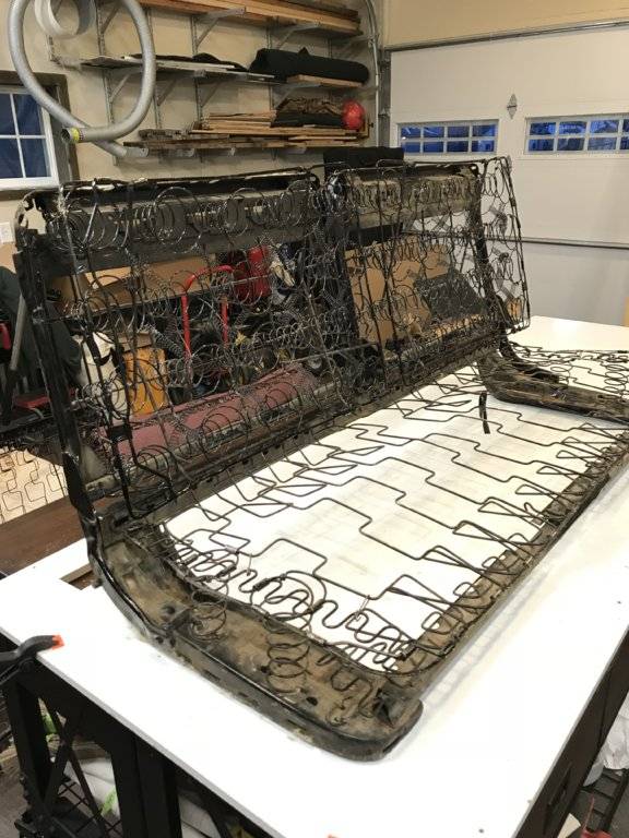

Seat Frames ready for blasting.

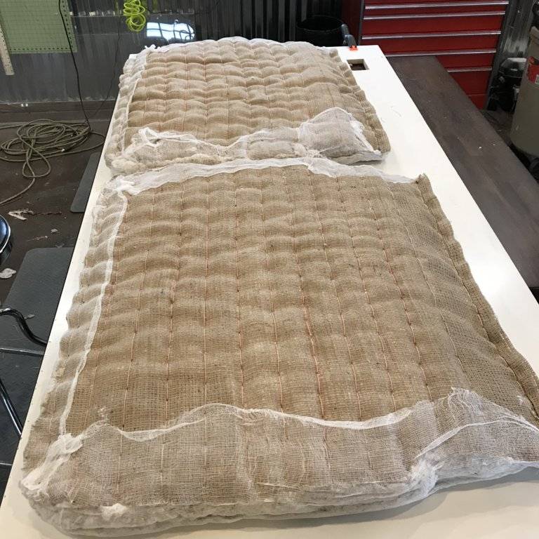

Finished one front seat back cushion.
47 hours in.

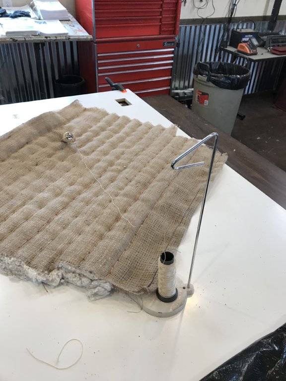

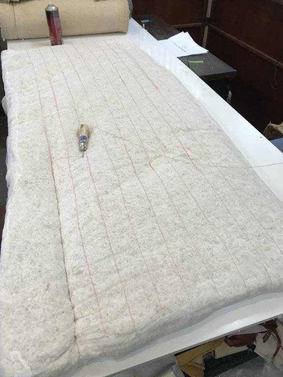

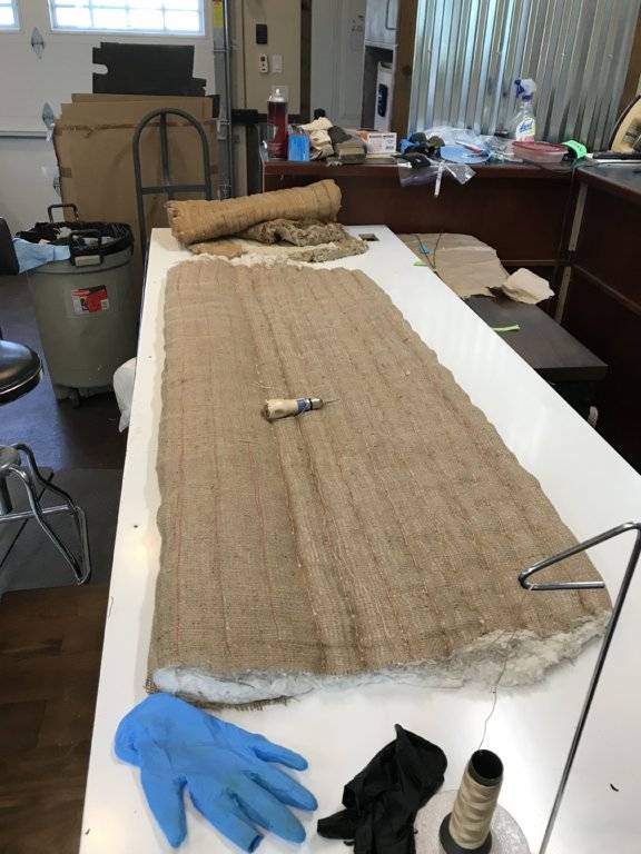

Front seat back cushion made up with burlap stitched to a couple of layers of cotton batting with another two layers covered in cheese cloth. I have a little more stitching left around the edges, but seems to be coming along. I would rather have used my sewing machine, but 2” thick is a little much. The tension would have been too tight and too small of stiches. I had to invest in a sewing awl and learn how to use it. $7 Harbor Freight.

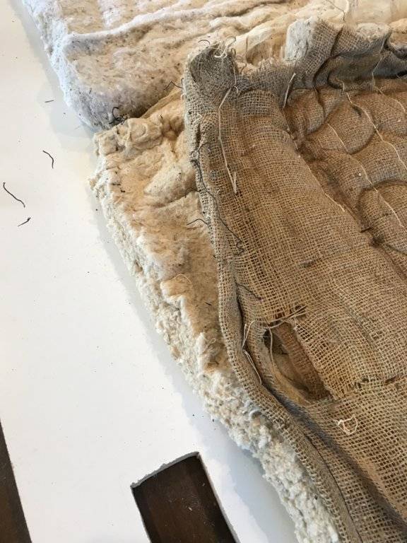

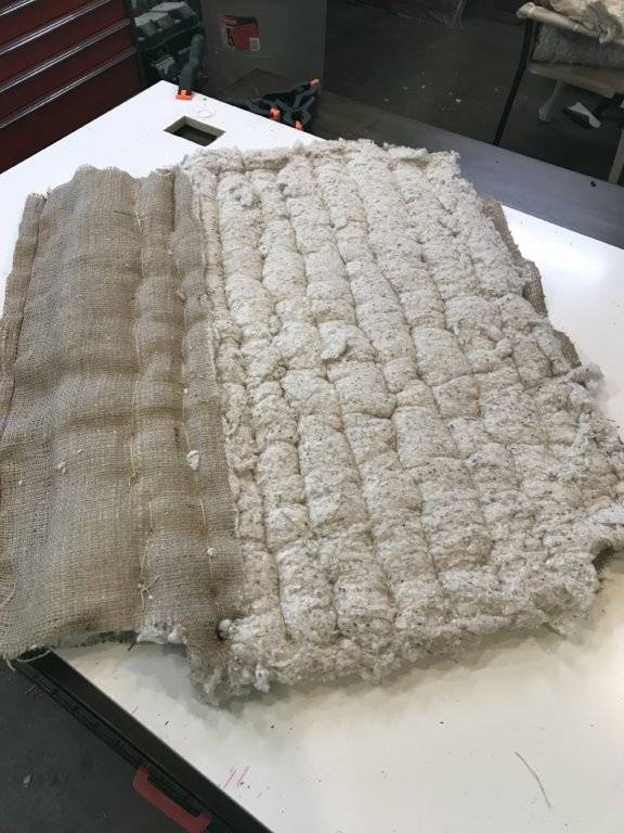

Tearing old apart for patterns
Using a sewing awl to loosely stitch the burlap to the lower layer of batting to keep the batting from migrating and getting lumpy. Used #77 spray adhesive to attach the batting first. The sewing awl is an art, but now am pretty quick with it. Although I need a spool winder to reload the thread. It takes for ever to reload by hand.

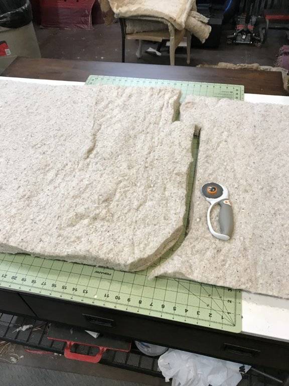

I found the perfect tool for cutting out the batting. This rotary cutter is perfect. Kind of spendy for the cutter and pad, but Joanne’s Fabric had them for 40% off. They also usually have a 50% off coupon as well.

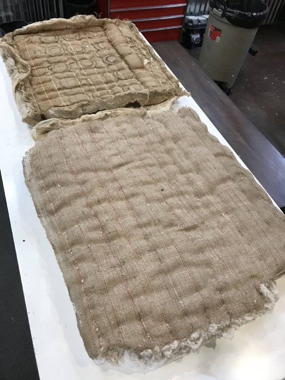

New and old. The topside is covered in cheese cloth to help slide the covers over the cotton batting.
A little more stitching around the edges and then in to the second front seat back.
Other front seat back complete. I wanted to start the front bench, but ran out of cotton batting. Had to order more.
When stitching with the awl I found that it was much quicker just to run the thread from the big spool through the awl. It took too long to hand wind the small spool that goes into the handle.
Getting better with the awl and is going faster.
Finished both front seat back cushions. Second one turned out better, but both should sit fine.

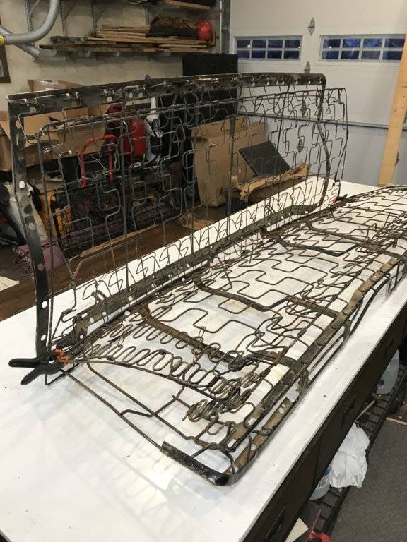

Took my seat springs to MRC (same guys doing the paint) to get them blasted and epoxied. I was going to do it, but would have spent more time getting my equipment set up than it’s worth. Plus it is still too cold to paint outside. Took a couple of pictures of the car in final paint. Plan on color sanding next week.

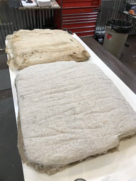

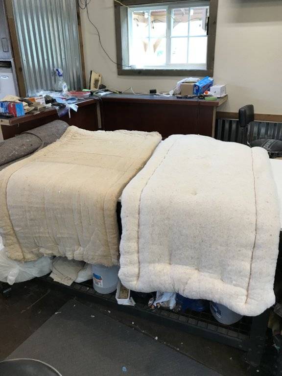

Stitched the front bench seat pad that goes under the foam. Cheese cloth over about 2” of cotton batting with burlap wrapped around the bottom. And light stitching to stake the batting.

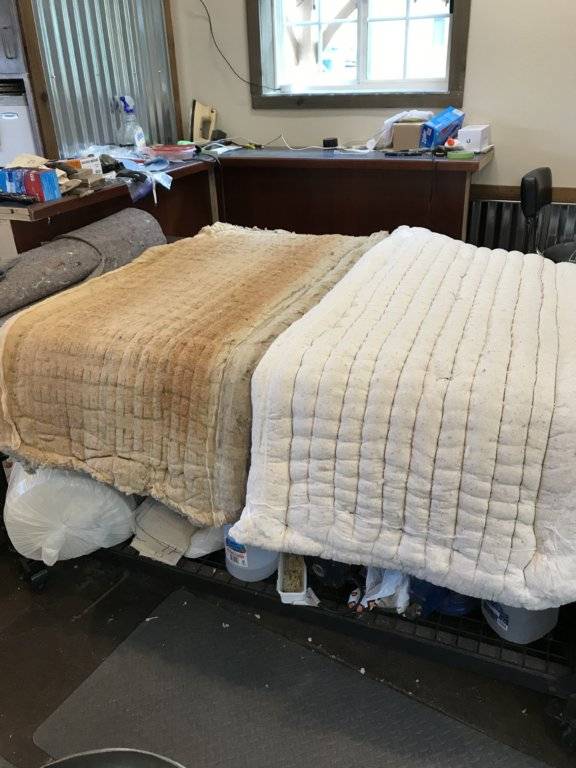

Also did the rear seat back of which this is the only cushion. There is no foam. Only Cotton batting with cheese cloth wrap. Original cotton batting was a little more dense than new batting. It is constructed in two layers. Bottom layer is about 2” thick with the batting stitched to compress it and stake it from moving. Top layer is also about 2” but the batting is wrapped in cheese cloth with just the edges stitched to the bottom layer and a couple of random stitches to stake the batting, but still leaving it soft.
Old and new.
