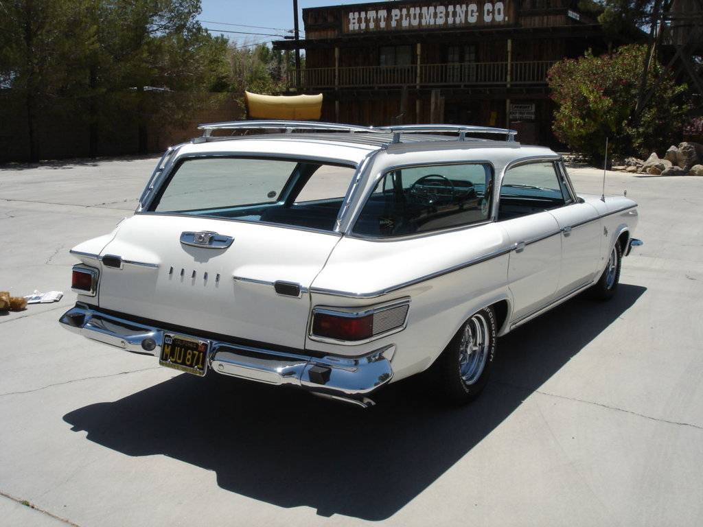

so yours is already pointed to the side? How far and is it turned down?
The tailpipe has the 45 degree bend and turndown tip like FuryGT's pic. I don't have a great photo but these may help...

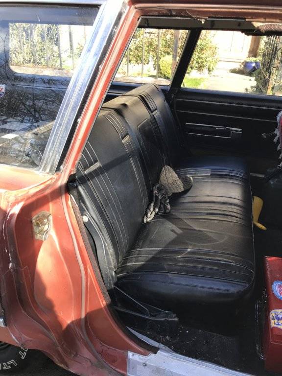

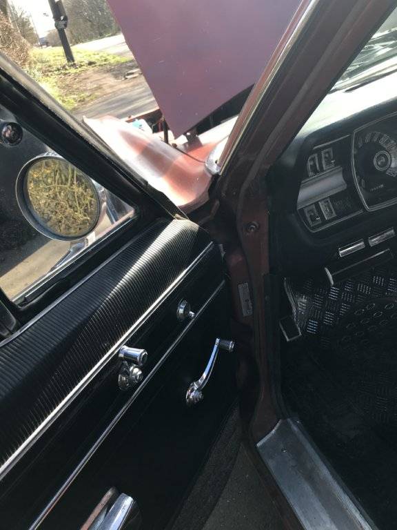

Great! Any pics of your wagon where you applied it? Thanks :)

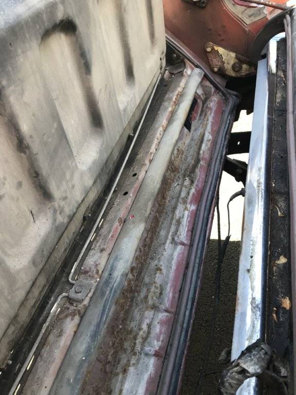

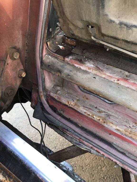

Hope these pics help - purists will hate me, but hell its a quick, cheap & easily reversed solution! I only get fumes now if I have the windows open due to wind swirl from my lake side pipes.
This is under the tailgate flap:
... and so is this:
Hope these pics help - purists will hate me, but hell its a quick, cheap & easily reversed solution! I only get fumes now if I have the windows open due to wind swirl from my lake side pipes.View attachment 269555
View attachment 269557View attachment 269558
... and so is this:
Very nice..thank you for the pics ... I don't think it looks bad. In your case the brown kind of blends with your body color... mine is light blue but I'd rather be able to enjoy the drive than worry about purity for now.... I'll be giving it a try

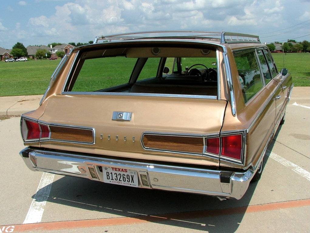

My Formal's pipes...by the way the deflector was never meant to deal with fumes...it was to prevent dust from accumulating on the tailgate glass and impeding rear vision.
