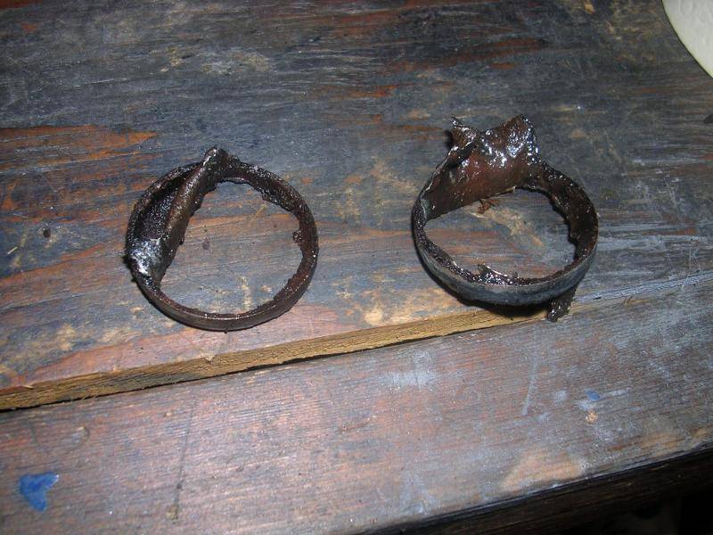

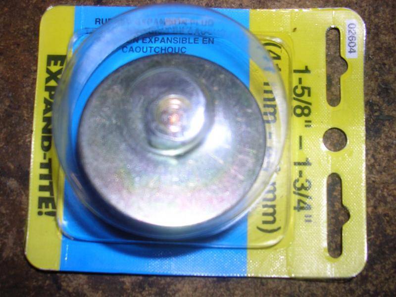

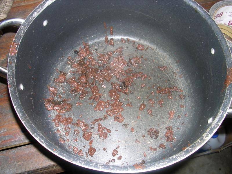

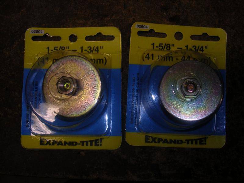

Within the last year all 4 freeze plugs on the sides of my 1970 318 block have rusted out and started seeping coolant. I considered replacing them with stock freeze plugs, but the holes are behind exhaust pipes, engine support struts, oil filter, etc. Hard to get an angle to hammer them in straight. I found these Dorman 02604 1 5/8 expansion plugs at Advance. 4 of them cost $13. They can't misalign because you just knock them into the hole until the washer is seated against the outside to the block. Then it's just few turns with a 1/2 wrench or socket to tighten them against the block, add anti-freeze, and your driving again. (at least until something else rusts out or breaks) Note old freeze plugs and rust that was keeping them from healthy coolant contact.
Be sure to wash the block out good. I would take the time to install the stock freeze plugs, use a little sealant on the edge. There is a installation tool just for soft plugs. Good luck
It looks like your block had been fed a healthy diet of hose/tap water with minerals in it and never ran antifreeze for years.........
I know prob since you owned it you ran antifreeze. It was already corroded......... That's what rots out freeze plugs.
I agree. Plus the car was only started once or twice a year for the past 12 years. The owner never used the car, so whatever was in it had plenty of time to deteriorate and cause rust. I took it for a drive today, top down, with my family. Very enjoyable, although the poor 318 has knock if I accelerate too hard. This engine is original, but only temporary, until I get my 440 built and installed. The expansion plugs were an easy temporary fix.
