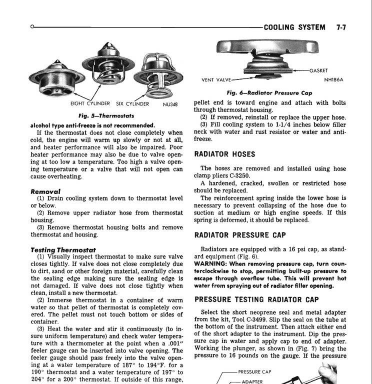

Now, have you any specific source expressly warning against flapper type thermostats, or are you assuming an interdiction based on this FSM quote alone?
Welp I see that we are dealing with a 383 engine and what I've read and learned over the past couple of decades specifically applies to the 440 engine thermostats, I really don't know what the difference between the 383/400/413/426 engine would be, thought they all had pretty much the same type water pump housing. I did find my old bookmark about it that was dated back 2 decades ago where they went into 'skirted' vs 'non-skirted' that activated some 'bypass' but this was all for the 440 motor so may not apply to your motor.
One thing about your testing picture that doesn't jive with the FSM and what I did different is, don't leave the thermostats laying on the bottom of the pan in contact with the direct heat source as per the FSM. use a rod and wire to suspend the thermostat in it's operating position. Also the FSM over the years spec that you try to insert a .001" feeler gauge at the certain temperature, earlier years they spec'd .003". I tried doing this and it's a PITA, everything is steaming hot and you try to hold the thermostat with needle nose pliers... BHAH! What I finally just ended up doing via information gleened from a senior mechanic back in the day was suspend the thermostat via a rod & wire in a large pot of water, bring it up to around the spec temperature, then lower and raise the thermostat in and out of the water half a dozen or more times and watch it's operation. What you are looking for is a 'Mid-point Hang', even a brand new thermostat can be be junk as by a old nutjob friend of mine (ex-Navy Jet Mechanic>ex-GE Jet Mechanic (via divorce)>QC Inspector at a USA Thermostat manufacturer), he said a lot came off the line and was boxed up as junk even back in the 70's, he was constantly fighting with management over quality control.
So recheck your thermostat's for sticking in a mid-point 'Hang', if you see one that has smooth operation for 6 to 10 time of 'dipping' from full open to full close that would be the one to use.
The flapper valve (disc to some) is to only to be used on the 6 cylinders via a later Dodge FSM illustration. (see below)

Welp I see that we are dealing with a 383 engine and what I've read and learned over the past couple of decades specifically applies to the 440 engine thermostats, I really don't know what the difference between the 383/400/413/426 engine would be, ....

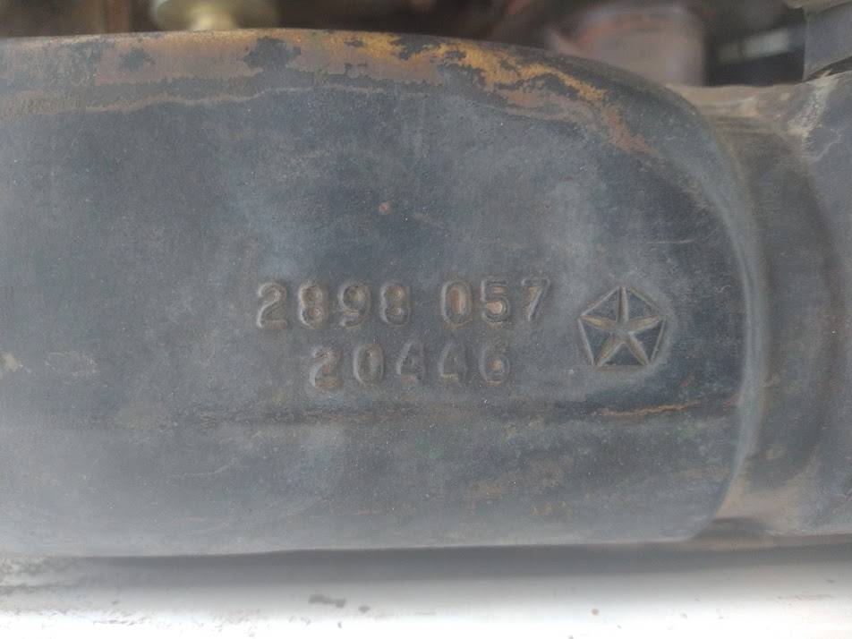

This radiator lists as follows: 2898057 1968 C 22 383 MANL HTR
That's consistent with other quirks of this car; the starter relay meant for a manual transmission and the transmission cooler bolted in front of the radiator as an afterthought. Be that as it was, the hoses and clear age of the rust on the bolts all tell that these parts went off the assembly line as they now are.

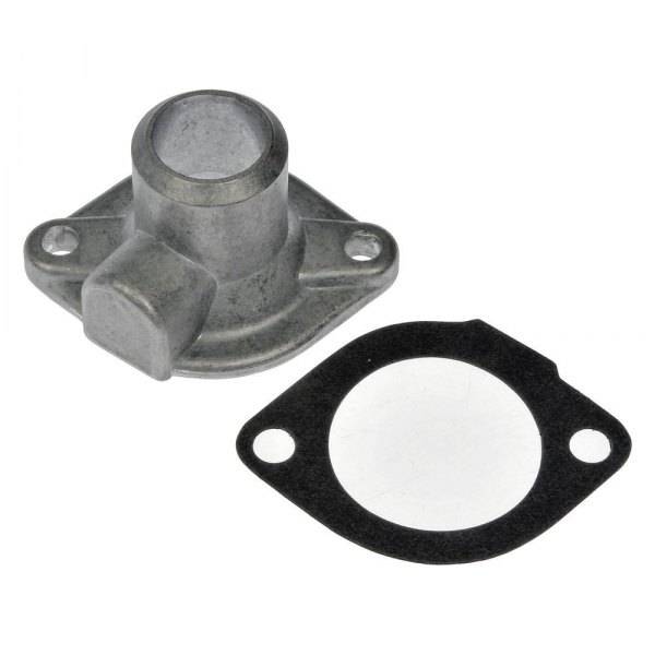

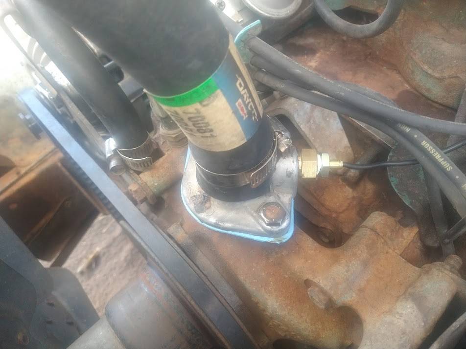

The water pump housing doesn't permit any extra temperature gauges, so I got clever and bored out a Dorman thermostat housing of this sort:
Its VERY EASY to drill and tap for 3/8 inch NPT into the flat spot facing diagonally out. I did so.
The capillary probe doesn't block or interfere with the thermostat. I made SURE of that before tightening down, taking some pains to rotate the thermostat to assure that it opens on the side opposite where the probe enters the housing. Admittedly, until the stat opens, the temperature reading from this arrangement might lag a LITTLE behind what the block coolant temperature is, but it doesn't lag much. This engine warms up to 180 F in under 5 minutes at fast idle.
