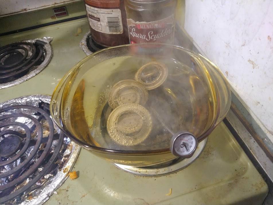

Put the thermostat in a pan of water on the stove with a thermometer in the 150-212 range and watch the thermostat open. You may have to go through 2 or 3 to get one that works correctly.
Yep! Exactly what I thought of last night. Hell, I'll go boil up a big pan right now. I can pick from quite a few here actually. Hording is GOOD, if you know WHAT to horde....
20 min later....
DID IT! ALL 3 OPENED SIMULTANEOUSLY, like clams in good water....

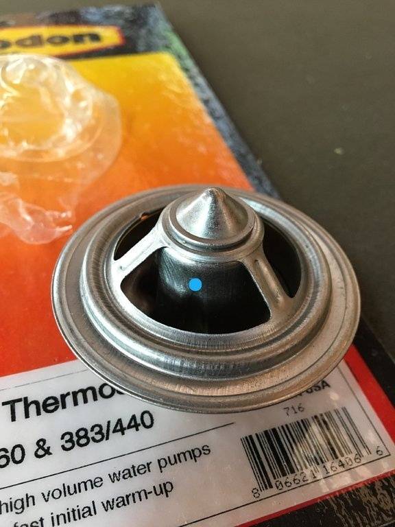

Ummmm I thought (and read) that the flapper type thermostat was a no no for the big blocks, especially the 440 and the poppet valve was the only one to use.
