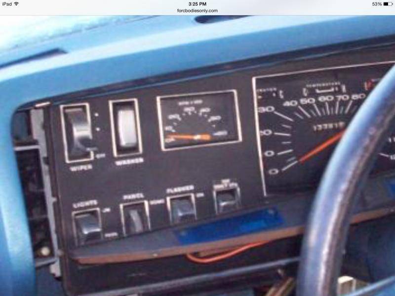

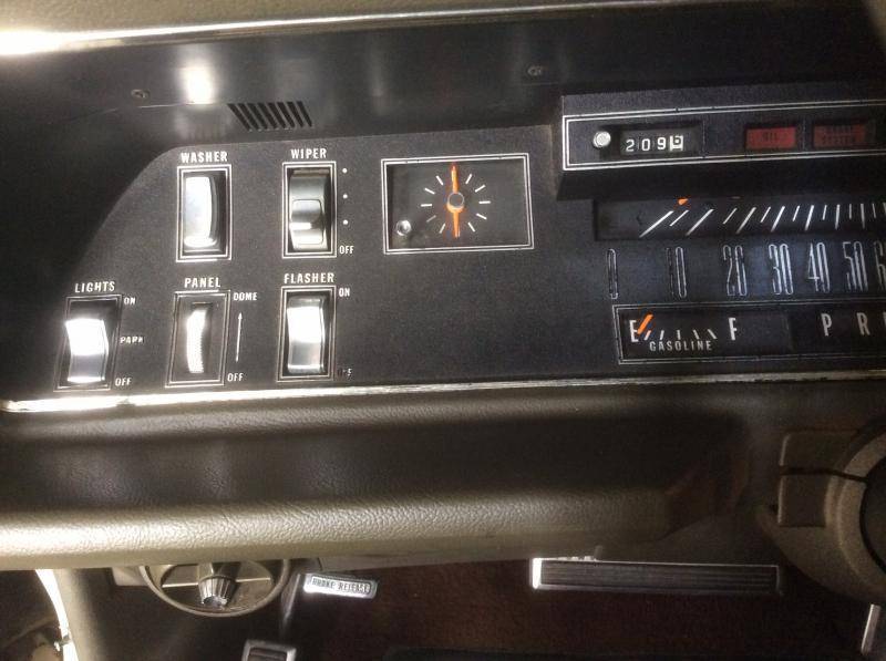

after looking at the clock on my '69 300 and scaling the measurements off the width of the dash switches it appears that the tach is about 3" wide, the width of the clock is 2-5/8", so you would have to cut the dash panel. And also the warning/ idiot light bar would also impede on the distance needed for the tach. Look at the pic Ironwolf provided, the width of the tach is is the width of two switches plus about a 1/2". The clock opening is the width of just two switchesI was thinking if it will fit where the clock go`s on the 69` 300 or is it too big
