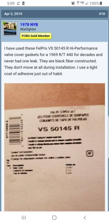

Done & done. Let's see how these work.
I like that they say they're reusable.
That's confidence.

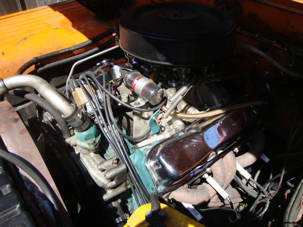

had what i thought was a rocker cover gasket leak , change them over n over again , cork , rubber , silicone , rubber coated , ect..... , even changed rocker covers . and still oil everywhere . what a ball buster it was being . then a bud of mine ask about my pcv valve in that cover . changed it and no more leak . it seems that pressure from the crank case was blowing up oil up the dip stick tube and the fan was spraying it all over the side of the engine . i also put a seal on the dip stick end . wa'la , no more oil everywhere on the cover or side of the engine or compartment as well . this engine made alot of oil pressure 70-80 psi on the run .
I will check the dipstick. But I doubt it. My pcv valve is new as well. My oil pan is almost as leaky as my valve covers. I torqued the bolts, a week later all bolts loose as the gasket shrinks or crushes. Torqued again, loose just three days later. The leaks are getting smaller but geez how many times. I can't get to the timing cover bolts unless I take the water pump off. At least the fuel pump is sealed.
old gaskets don't tighten up . you need a thread sealant (rtv) to get them to stay tork'd , its seems a never ending cycle . just spotted , the passenger rocker cover has a leak . at least the driverside is not , yet lol ! when this motor was in my dart , you couldn't see the leaks , you could smell the oil burning off the exhaust manifolds , it did get some altering from time to time , eddy rpm was the end for intake changes . now in my p/u with headers , plenty of room to see the leaks . this engine has been in three vehicles so far . and still goes far it !

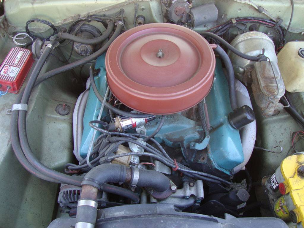

:) Do you have a 400ci motor? My prior C-body had one and I fought the oil seepage from the day one. I won't have another 400 as it is a common problem thanks to the excessive heat from the exhaust manifolds running adjacent to the valve covers. Or so I remember reading. People have gotten their 400ci motors to behave, but most had quite a battle to get there. My cars have always been unrestored originals with factory design/defects.
My 360ci has been an absolute dream! No drips, no leaks, no seeps.
