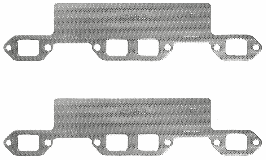

Are you talking about the FEL-PRO MS90425? I have those on my 1971 T-code Monaco. No issue after almost 10k miles.
This thread @ayilar is pertaining to the valve covers to top of head interface.
What you are referring to is the exhaust manifold to head interface gasket. Those that you are showing though are great for that application and I use them as well with good results
