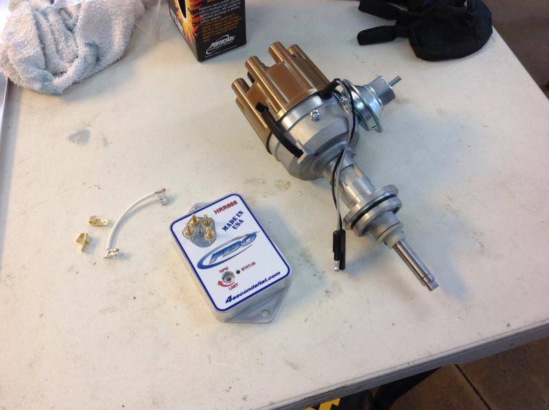

Here is the ignition system I will be using. It allows me to bypass the balast resistor. The distributor has been curved for my application. I have used this system on a couple of other projects with good results.

Nice stuff, Do you have any info on that IGN. system....? looks interesting. I still run points in my vehicles just because I never have any problems with them. But I know there is a performance advantage with a modern electronic IGN and want to try one.
I like the fact I don't have to deal with the ballast resistor. If you want to do a stealth install on a points conversion, pull the glove box liner and mount control box inside on fire wall. Pull wire through an existing grommet, use the jumper on the ballast resistor. He will recurve the distributor to fit your profile, cam, carb, gear, weight etc.

I had 4secondsflat custom tuned System.
Excellent. Highly recommended.
I have been extremely pleased with the way the system works and Don has always been willing to answer questions, not just about his system but with regard to overall tuning.
