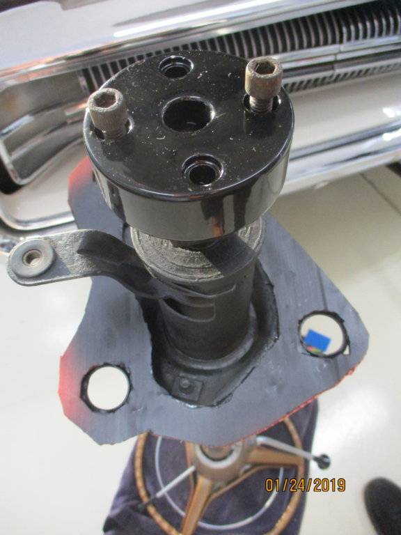

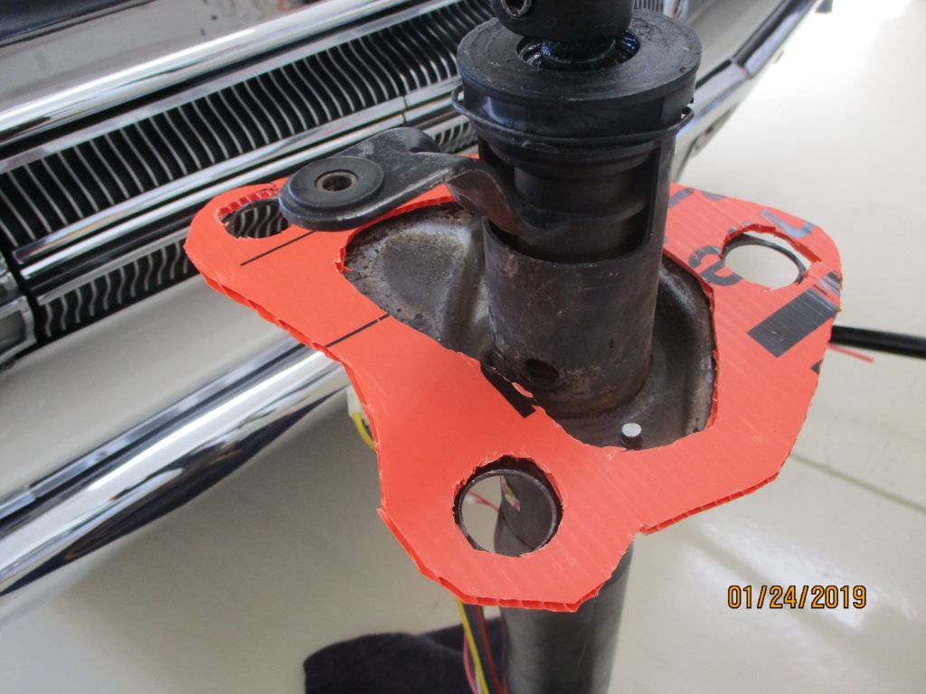

Well, it's not actually the gasket, but a PDF image of the thin cardboard template I made for my own gasket. You can use whatever material you want. I had one of those very rugged plastic outdoor signs laying around the garage, like for a zoning ordinance hearing or a political campaign sign, so I used that. Rubber, foam, gasket material, an old sign....your choice.
This is for my 1970 300. Your results may vary, but I'm guessing you guys know what fits what.
PM me your email and I'll send you a scan of the cardboard template you see below.
To prevent tearing your material, do the following:
1. Cut out big center hole first. I used an Xacto.
2. Cut out three bolt holes. Remember that they need to be large enough to fit over the lip that's formed into the floor plate holes.
3. Now take a scissors and cut out the outer outline. It can easily be 1/4 inch larger than the template, and probably should be.
It's ugly, but unseen once installed. Oh....a little black spray on the firewall side hides any ugly orangeness. At least it's sorta Hemi orange.....

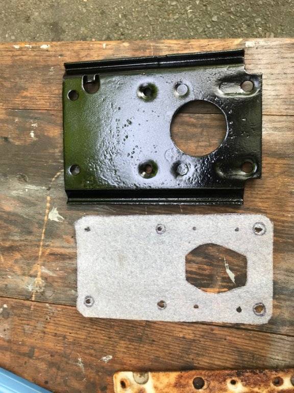

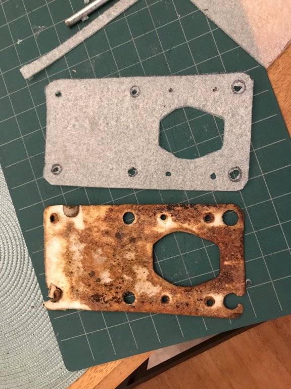

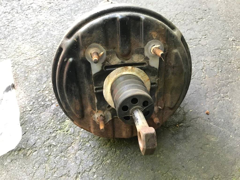

What year model is that reinforcement bracket from. Is/was there a gasket between that and the brake booster? I'm trying to accurately document the different brake booster gaskets. Looks like 64-65?, 65-66, 67-68?, 69-73 are all different.
65-73 C Body brake booster gasket ID help
The bracket is from a 1970 Chrysler 300. There was a small round gasket between the booster and the bracket, along with a stiff plastic retainer pressed into the studs. You can see it in the attached picture below.
The bracket on the left with the integrated boot if off of a 1973 Chrysler New Yorker. It did not have a gasket between it and the firewall.
Hope that helps.
