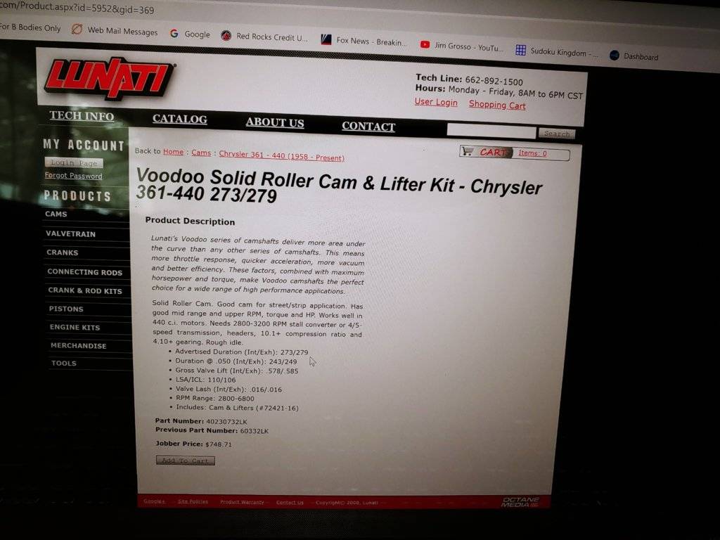

440 sources stroker kit with light weight crankshaft upgrade. 10.5/1 compression , all ARP studs and bolts. Trick Flow heads which flow benched over 300 CFM. Roller rockers 1:6, lunati Voodoo cam . Specs, 273/279 lift 618/620( with the help of the roller rockers) with a LSA of 110/106. TTI long tube headers along with Mopar M1 single plane manifold and a Holley 770. Plans to either upgrade the carb to a 1050 or possible efi setup not sure. Right now I'm having excess blow by through the breathers and will be checking compression later today. Hoping its not any of the rings but if it is, I'll be upping the camshaft for more lift in the range of .700 or so. Trans is a 727 upgraded to a 24 spline and shift kit followed by a Deroit 3:91 rear;)

My rocker system,valve springs and lifter along with pushrods cpuld easily handle .700 plus lift.

what's your full cam specs( roughly)... My lift is arpund .618/.620 with my roller rockers.
My cam is .657/ .661 lift with 1.6 rockers, minus .012 lash.
Full up on the lobe, there wasn't much room between the spring coils to poke a feeler gauge through.
Depending on the spring package, TFS gives anywhere from .650-.700 as the max lift.
With that being said, I know Dad Horvath put more in his TFs (See Rush thread), just something to be aware of before spending time and money to find out the cam has too much lift.

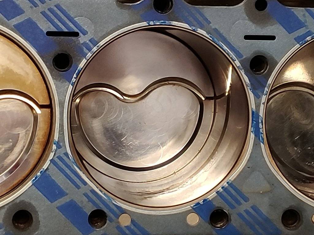

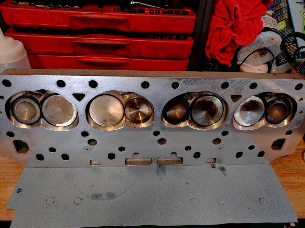

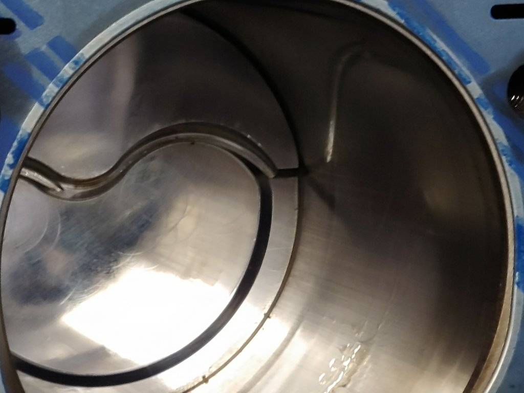

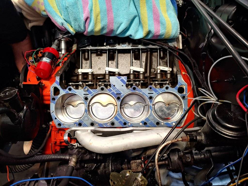

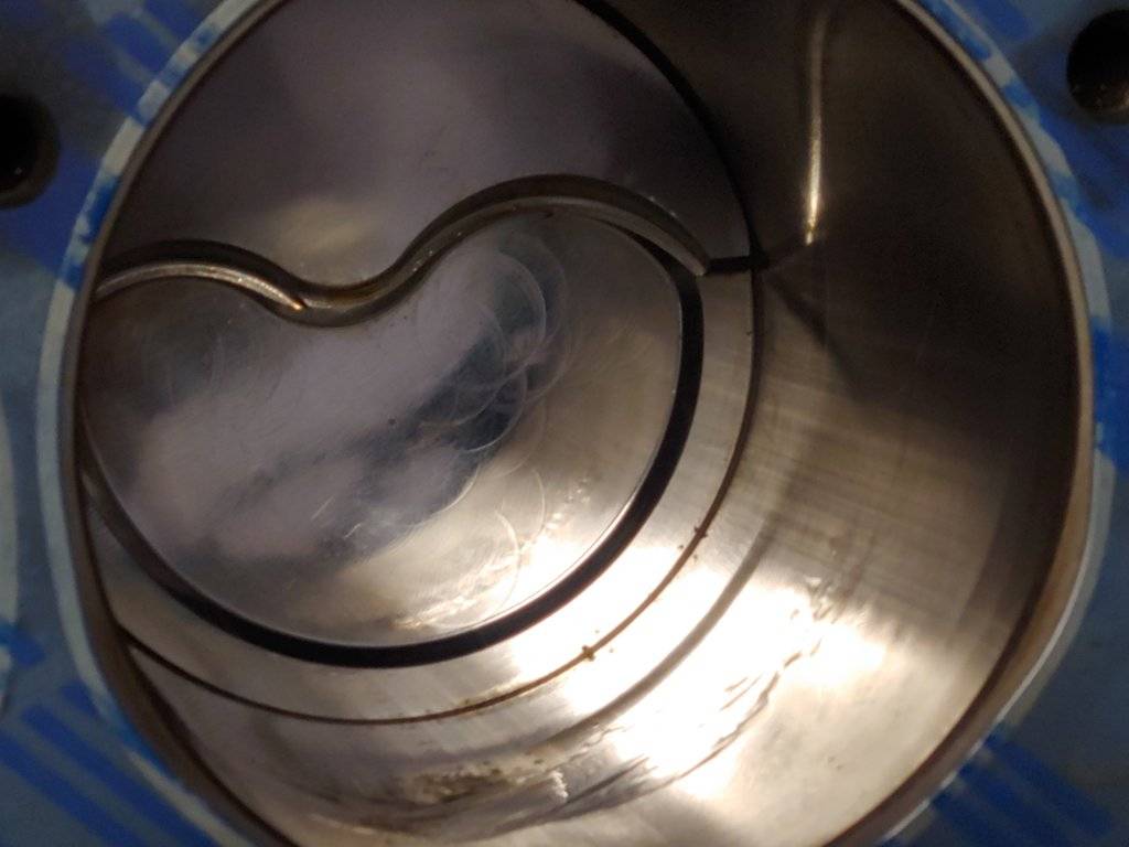

So checked the head and she's straight as can be. I'll be pulling the motor and going for the piston this week. One thing ive been kicking around is running my deep 7 inch pan now that the car is sitting higher in the front, but then there's the tie rod clearance so we shall see;) Ive enclosed some photos of the cylinders. Lets play which one was sleeping lol
Dan
Are you sure the valves are not being held open, i.e. seats settled in and valves held open. 95%seems like a big loss for rings.
That cylinder looks ridgy.Maybe it's just the picture, but, is that from a broken ring end moving around? Looks like horizontal marks.
