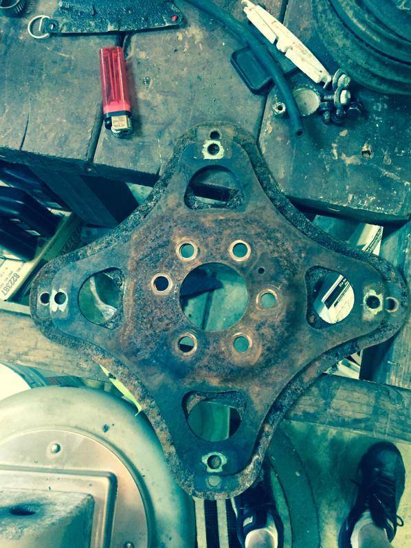

I'm dropping the trans in the morning so I'll find out. I've laid it on top of another big block/727 that I have and the only difference I see is the diameter. The Crank bolts match up perfectly, so I'm assuming the TC bolts must be off some how.
Here's what I've got . The bottom,larger is 383/727 the top smaller is 318/904.

That's what I thought. Then somebody threw a monkey wrench or should I say Mopar wrench and told me the 904 flex plates were different than the 727. Right now I've got 2 large 727 flex plates and 1 small 904 flex plate and 2 small converters.
I can only speak for the 727. If both flex plates bolt up to the big block crank that means it'll work. A 904 trans will not mount to a big block engine. But i dont think the flex plates are different. holes on the converter are clocked. The convertor needs to be in the right position for the holes to all be straight. Line your flex plate up, and turn it till it fits right.

Thanks Mr.MoparCHP. Well I pulled the trans out and in turn have utterly confused myself. The crank bolt pattern on the 318/904 flex plate is of course the same. So for shits and giggles I thought I'd try to bolt 904 flex plate to the 727 torque converter and it bolted up to that too. Now, if it bolts to the crank and it bolts to the TC it seems to me that it would work in my car. What is the difference? I put a straight edge on the bell housing of the 904 and the 727 and measured the depth of the TC lugs, they were the same. I laid the big block flex plate on the concrete along with the 318 flex plate to check the depth at the crank and they were the same! I cannot find a reason (with in reason) that the flex plate that came off my 318/904 won't work on my 413/727. Did they make a run of 7 or 8 flex plates that will fit both and I found one? SMH...
