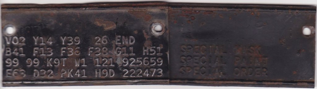

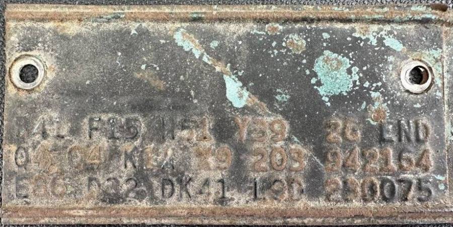

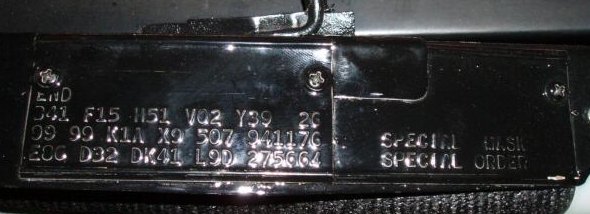

For MY 1969, the year in the original post, there are a couple of letters used to start the VON but , for the most part, 69 specialty VONS are indicated by numbers. For DK cars, the 94**** series seems to be common, yet other VONs exist. For PK, the 92***** series shows up, but, again, others exist. Also, look for the Y39 code on DK and PK cars. Paint code 99 is common on 'cop cars' but regular color codes exist also. Typically, 'cop cars' will have lots of F codes.

As Wyatt showed, you could have a PL or DL police package also, with or without the A38 package, but definitely with the Y39 special order code, as Doug mentioned, usually with quite a few "F" option codes for fleet oriented options.

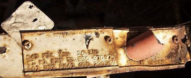

Most police cruisers will also have a "Special Order" next to the build tag as well. Note that not all Dodge cruisers will have the DK designation. DK indicates that the vehicle was ordered with one of the many police packages available. This simplified the order process. It was also possible to manually create a police cruiser outside of the police packages by entering the options individually from the dealer order book. Cruisers created by this method usually would have the DL or DM prefix along with a special order designation. It was much more common for police agencies to use one of the package options but manually created vehicles are known to exist but they are pretty rare. Unless there is good documentation for a specific vehicle, one should assume a DL or DM prefix is a clone until proven otherwise.

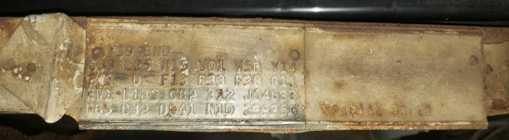

Possible Plymouth version of your example. PE series yet F33, Y39 and 925***VON; same codes as expected on a PK car. Not a 'cop car' yet a 'cop car'.
