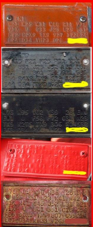

What was coded, when it was coded and where it was coded changes year to year and plant to plant.
Starting in 1972 ALL automatic transmissions were coded D34 on the tag. /6, 318, 400, 440 = doesn't matter. So starting in 72, the tag only tells you the WHAT (Automatic transmission), not the WHICH (light or heavy duty).
Up to the end of C-body production the transmission codes being used are:
D34: Belvidere 1972-1975, East Jefferson 1972-1975 and 1977-1978, Newark 1972-1974
D36: Belvidere 1976-1977, East Jefferson 1976
So in 1977 Chrysler tags can have two codes: Belvidere-built Town & Country has D36, whereas East Jefferson-built Newport and New Yorker have D34.
Just like D34, D36 means only "Automatic Transmission".
(I know, I should have more than just a handful of fender tags, but this is the picture that emerges.)
Update:
In 1977 Newport production was shared between East Jefferson and Belvidere. So theoretically Newport tags can have both D34 and D36, depending on the plant.
Only I haven't seen any 1977 Newport fender tags.

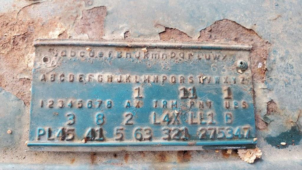

Random fender tag I snatched from the 'net, is from a Plymouth Fury (low) station wagon, been sitting in my picture bin for awhile and I know some here like to collect... Didn't know where else to post it up.
