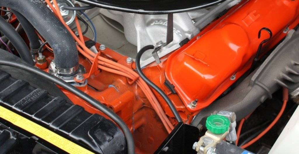

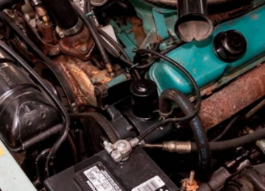

Was this the right location in '68, but changed by 70? I would like to see some early reference material showing the correct location.

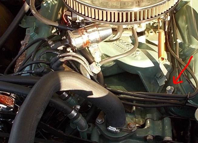

I've never seen one attached to an exhaust manifold. Usually a short bolt in an empty hole on the front of the cylinder head.
I would put it about anywhere before I put it on the exhaust.

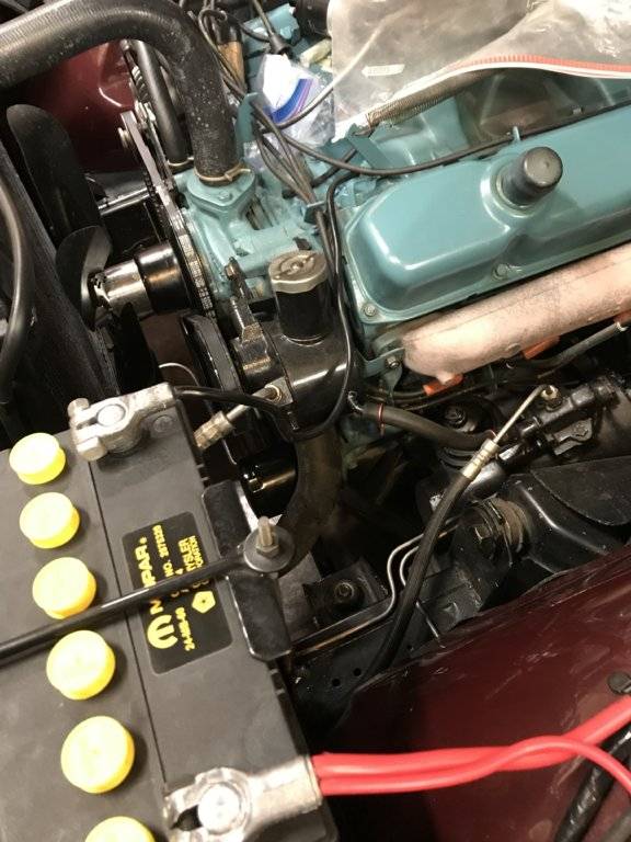

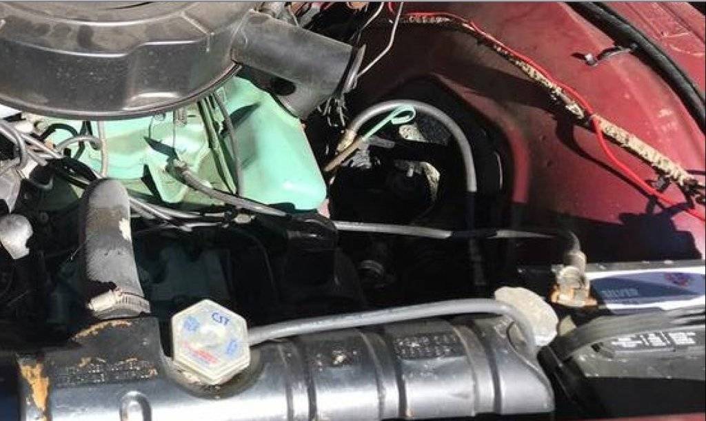

I agree with the crappy cable, but where is the correct location to bolt it to? On my '68 Polara 383 2 bbl it has been attached to the long stud on the (Stock)exhaust manifold ever since I can remember. Manifold secured with nut, negative batter cable, nut.
I did some manual searching and bulletin searching, and I don't find any reference to this connection. Was this the right location in '68, but changed by 70? I would like to see some early reference material showing the correct location.

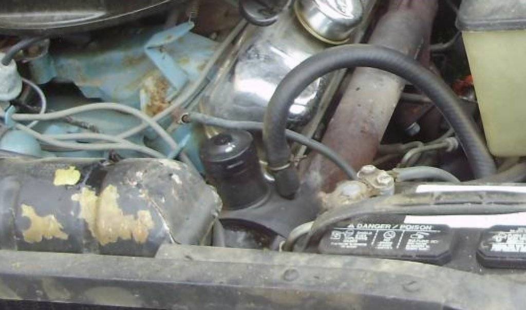

This is how I remember the neg cable back in the day and for that matter any other ferd or chebbie i've worked on. Hooking it to a heat source would give you problems I imagine other than eventually melting the insulation and the funny asks you will get about the smell of that. I'm sure if we found some metallurgist's or electricians we can get a debate going about it.
Figure it out for yourselves.
Most likely if it's anywhere else than the intake manifold bolt it has been serviced by some pump jockey at a filling station that had a just too short cable on the rack, one of them "That'll Work" kind.

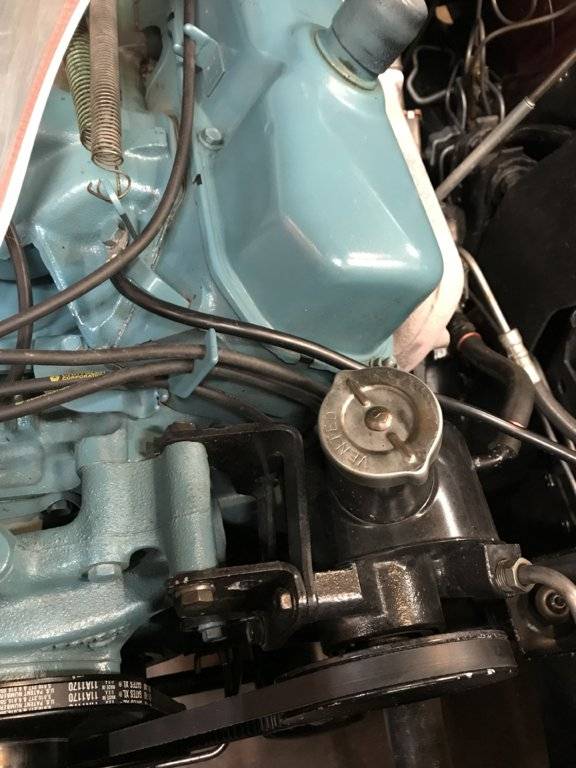

I probably did it back in high school after doing the heads in shop class. We didn’t have digital cameras back then. Plus I thought I knew everything.
I didn’t really like that it was hooked there because of the heat, but mistakenly thought that’s where it belonged. That’s why I asked.
Fixed.
Fixed.
View attachment 337777 View attachment 337778
Giving it some more thought would be, why would you want to heat cycle a crimped on fitting of dissimilar metal? In the end result would be moisture would get in there leading to corrosion which makes resistance and who knows the what the heated properties of the copper wire is vs. conductivity. heh.
