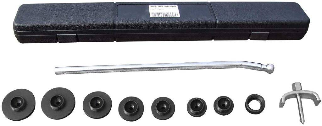

I would replace all of the ones you can get to. If one is starting the others will follow if they are steel. Once out try to flush a the rust out of the bottom of the water passages, it is a mess to do better off outside. This tool is your best friend now. Not to expensive if you want to buy it and some parts stores will lend it to you. Just my 2 cents.

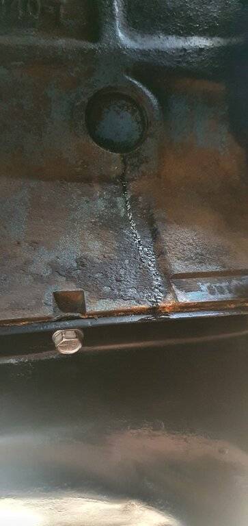

Went outside for a quick pic, this is it. As you can see it's barely there.
I feel like I could replace it with a genuine brass one if I go through the wheel well.
