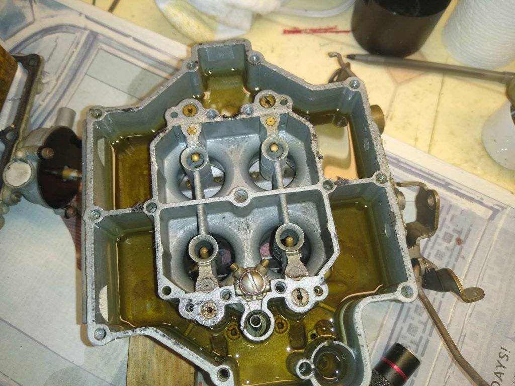

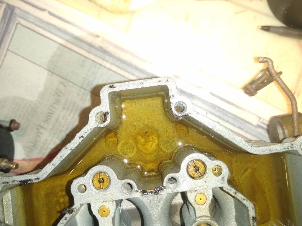

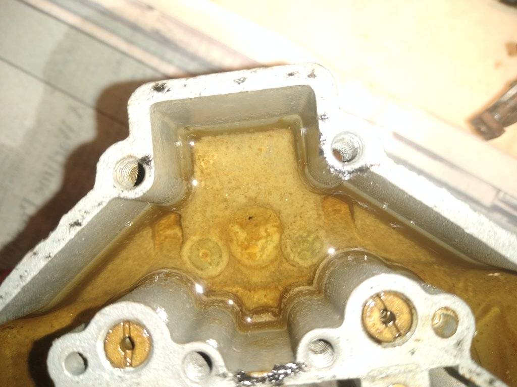

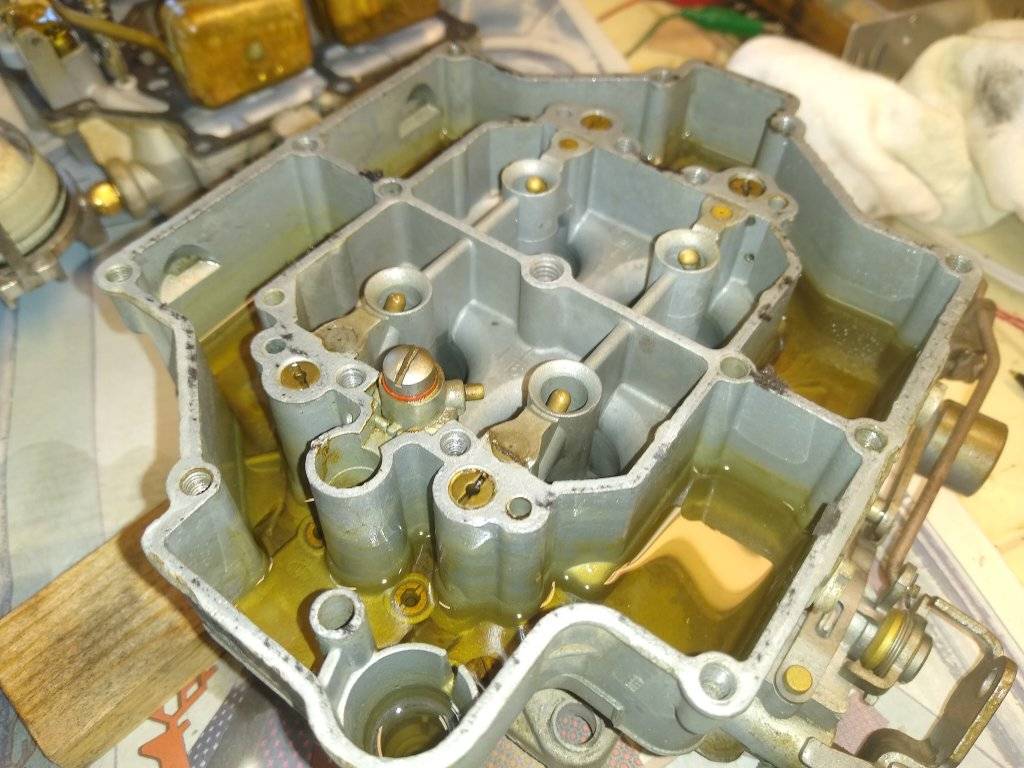

UPDATE: I found the main problem. I took the carb top off and found "silt"? covering the 2 rear jets.(see pics) When I unscrewed those there was still a hard substance blocking one passage amongst other things. This rebuild was used a bit and then shelved for 5 years. Anyway, after cleaning it out it idles with the choke open with only an occasional misfire (points?)
