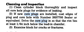

Rule #1: always look at what the FSM says.

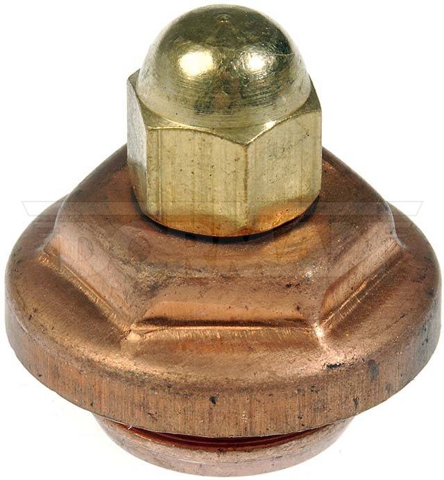

These Dorman copper expansion plugs are supposed to work real well too. Lots of boat guys use them from what I'm told. A step up from the rubber, but still not have to drive in new plugs. You'd probably have to buy them by size rather than application and I wouldn't expect the local Advance Pep Zone to have them on hand.
I've got one of those plugs in the front passenger side expansion plug port behind the motor mount. After flushing my engine thoroughly this past weekend, it started leaking. (surprise surprise!) So, having already spent a weekend replacing the water pump and radiator, I wasn't inclined to get back down under the motor to remove and replace both expansion plug and motor insulator. I bought a $4.5 bottle of Bar Leaks rabbit turdz, poured them into my pristine, clean green coolant solution, and the leak stopped.
That Dorman expandable copper plug has served for over 3 yrs now, and was shellacked into place to insure its hold. IDK if the shellac cracked or what, but that was the first sign of leaking I've had from it. When workspace lacks, those copper plugs do a good job.

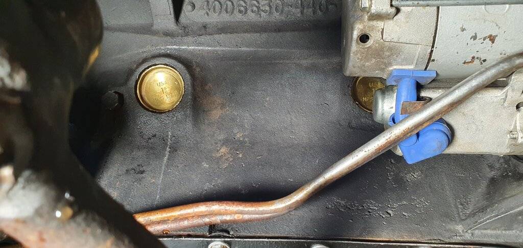

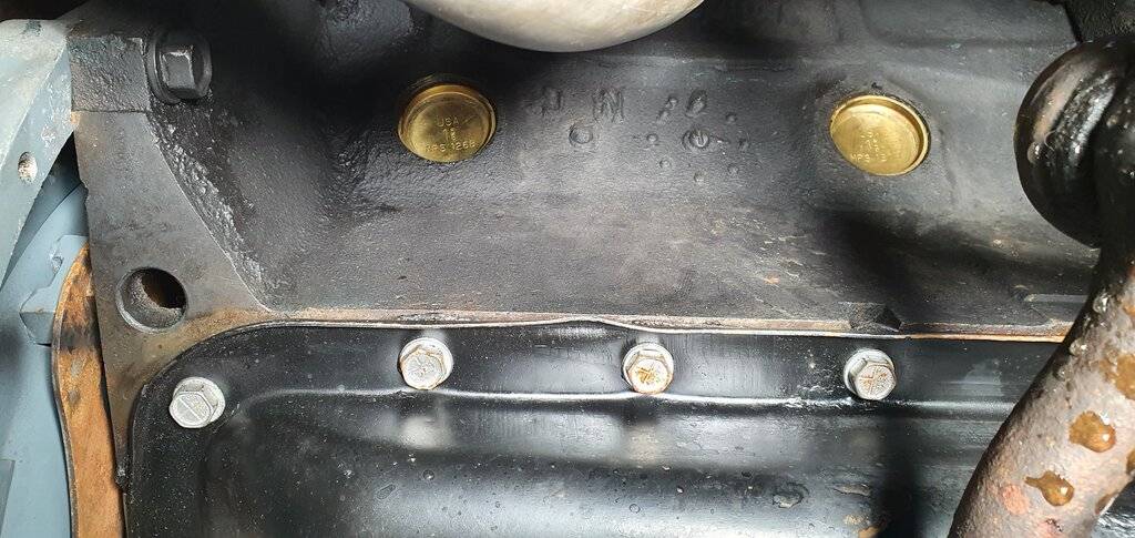

I like that these plugs say "USA" on them. And yes, I did try my best to align them this way. :D
Great Minds work alike! I did the same with mine while I had the replacement motor out! What a RELIEF to have a good running engine with good brass U.S.A. made expansion plugs in it!
