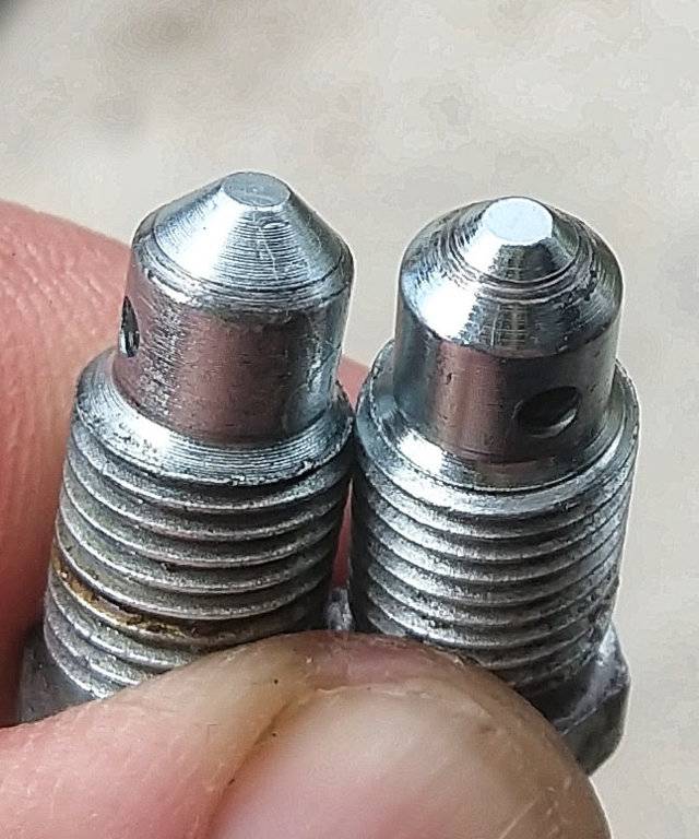

The issue? Bleeder valve(s). Or more specifically cheap Chinesium bleeder valves. Noticed the fluid in the reservoir for the front was getting milky. I know that's water. so moisture was/is getting in somehow. So some google and bing foo later someone had the exact same symptoms I am having and it was traced back to bad bleeders. Since I didn't ship the old ones back for the core charge yet I pulled em and cleaned up. Swapped them out and this is what I saw;
Bleeder on the right was gouged all to hell. Matter of fact internal hole was also dry when I pulled it. The left, the drivers side, the internal hole was wet. The factories were still smooth so what the heck. Bled the brakes and went for a drive. Felt nice, no fade.
So now I'm off to get new fluid and flush the whole thing again. Then I'll let it sit and see if the symptoms return.
