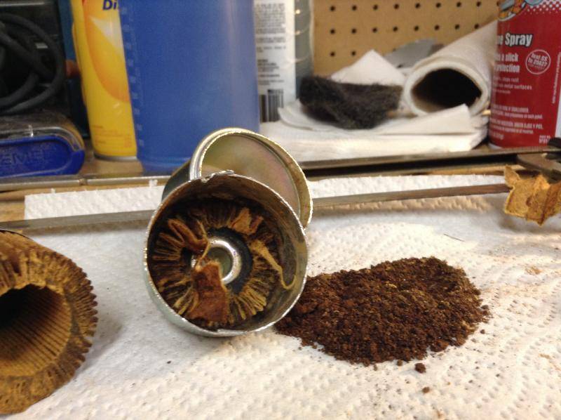

For those of you who have these older cars and use steel fuel filters, I would suggest the next time you change your filter/filters,..is to cut them in half to look inside to make sure you don't have the same issue going on like mine did. I couldn't believe how much rust/dirt was in it only after 25 miles of use.

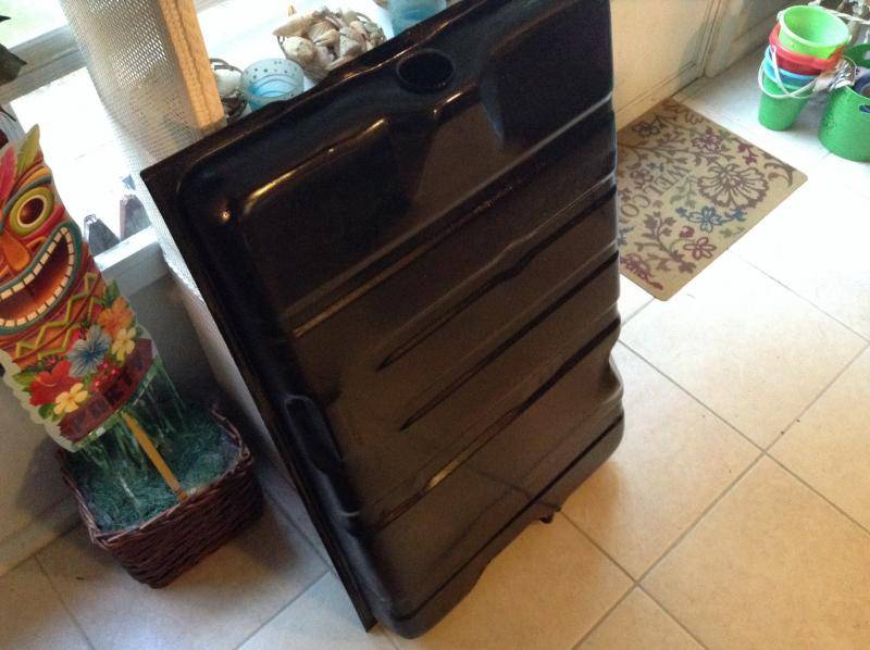

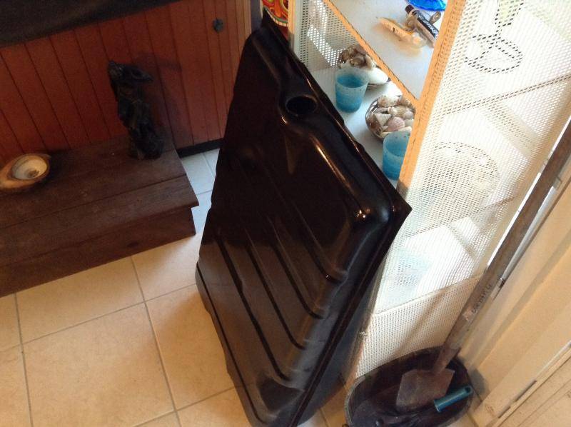

I went to the local parts store to pick up the sock and it wasn't even close to what I would need. I'm not going to bother with a sock. I'm running 2 filters anyway. Going to leave it out. I ended up using small stones inside with a mild acid to clean the inside. I spent about an hour just rocking the tank back and forth by hand. The stones acted like course sand paper inside. After getting the stones out, I flushed it with water, then I fired up the pressure washer and use a power tip inside the tank. Spent a half hour with the pressure washer inside the tank. I got every bit of **** out of it. Fuel tank is now spotless inside and out. Fresh coat of paint, and It came out really nice. It's ready to be installed and filled with V-Power.
BTW, wife is not happy about the tank being in our sun room!!..LMAO.....! She'll get over it.
Did you line the inside?
I didn't bother with lining it. There is a baffle that sits on the bottom of the tank, that sits off the bottom like an 1/8 inch so the fuel runs under it over it. I figured if if lined it that wouldn't work any longer! If this happens again with the rust issue in will pull the tank and put in a fuel cell.
I never thought of that aspect. That is an excellent point to remember.
Good work, I hope you have no more issues.
Thanks man, yeah that baffle is important to slow down the fuel on acceleration and deceleration and sloshing around the tank!!. I was going to line the tank until I saw that inside. My car is not going to be a show car by no means. It's a car that I want to build the way I want to build it, so with that said, if the tank turns to **** again and it probably will in a year or so, I will pull it and put in a 20 gallon fuel cell and be done with it. The only reason I don't do it now, is because I just don't want to spend the money on it right now. I need the cash for the engine upgrades happening this winter.
