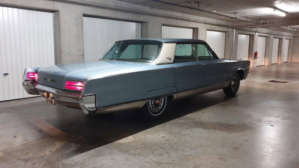

FredNY66: You mention a few makes of brand new wheels that appeared to have the factory black steel wheel Mopar look. Which brand did you get? Do they work fine with factory hubcaps?
I am looking to get 15 inch steel wheels, and would like to just get new as well and match them with some factory 15 inch wheel covers (1969 300 seems like a good looking wheel cover to me).
I've taken what I've been able to find here, they are Wheel Vintiques. The 15" inch hubcap went 100% fine. But I found the powder coating of poor quality, as the center bore edges. Also, the center bore is slightly bigger than the original, which doesn't help when one wants to put the wheels back on the car. The tire size is fine, slightly bigger than the originals, but they look great. To be fair, if I had to do it again, I would not. I'd probably go like cbarge or pomonamissel with Magnum style wheels. Said differently, I don't recommend those wheels.
