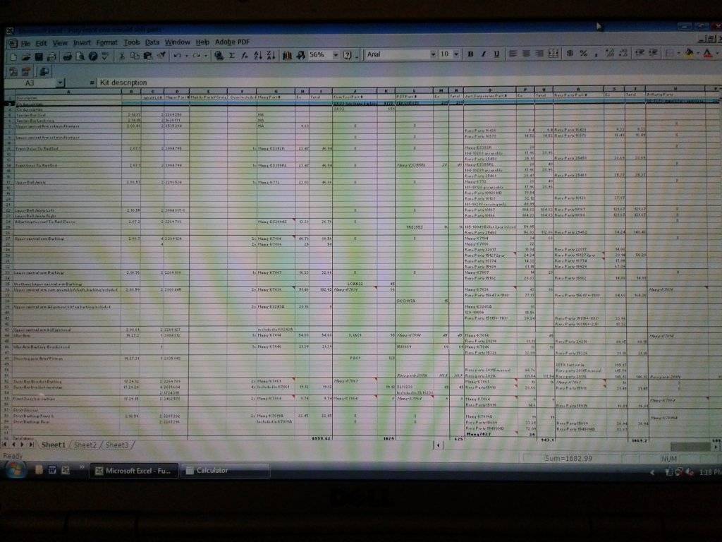

Here is the spread sheet I have come up with
analyzing steering and suspension components from the various suppliers, with cost, kit content and the like, think it's correct. Let me know if you find any mistakes and if there is a better way to post.
So, how do we attach a pdf file. Anyone, anyone, anyone? If interested PM me a email we'll send a pdf off to ua polara71
