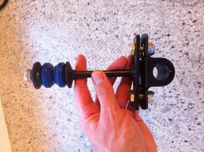

i have found the bushings easy enough but the linkage bar that comes down to the sway bar is bent on mne and just wanted to get a whole new unit but cant find one

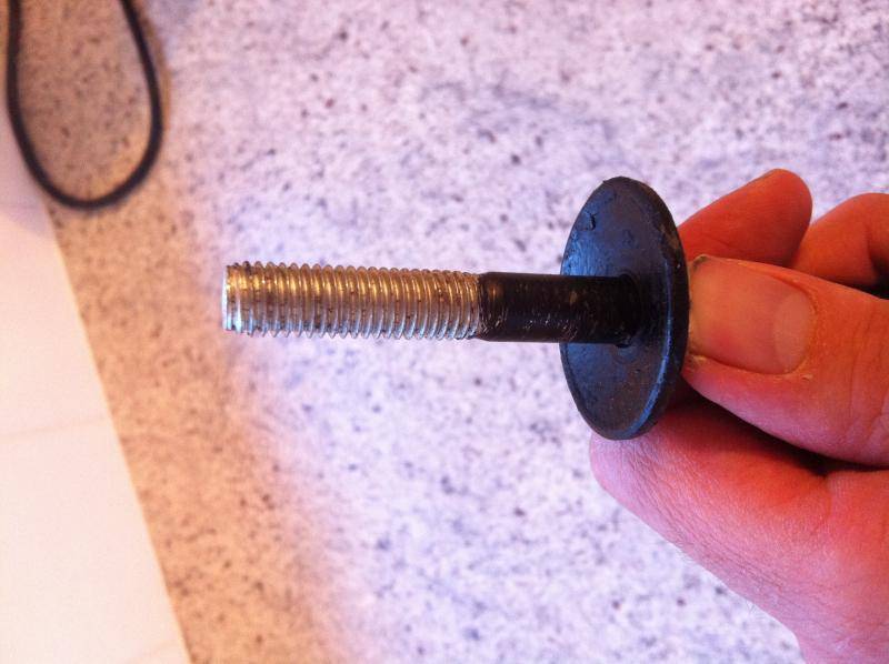

im in new zealand and find it hard to get parts for mt C body, i WILL be buying a PST front suspension kit for my C body in the very near future as i like that ya get the whole kit but no one makes the linkage i was after for the 67 new yorker that has the fully welded in bushing but i had new,stronger ones made for bugger all and it uses a standard d style swaybar bushing and can change the bushing easy as in the future i got 2 150mm M10 high tensile bolts ($3 each) with matching lock nuts , 2 pieces of 5 mm think metal plate cut to 25X100mm ($2.80) measured bolts to same legnth as the standard link cut and welded plate to bottom, lined d shackle up and drilled holes in plate ,measured and welded the bottom retainer in place on the bolt and done, the bolt has a nearly identical looking thread on the end to, sprayed them black and put the bushes in place
View attachment 10729View attachment 10730
