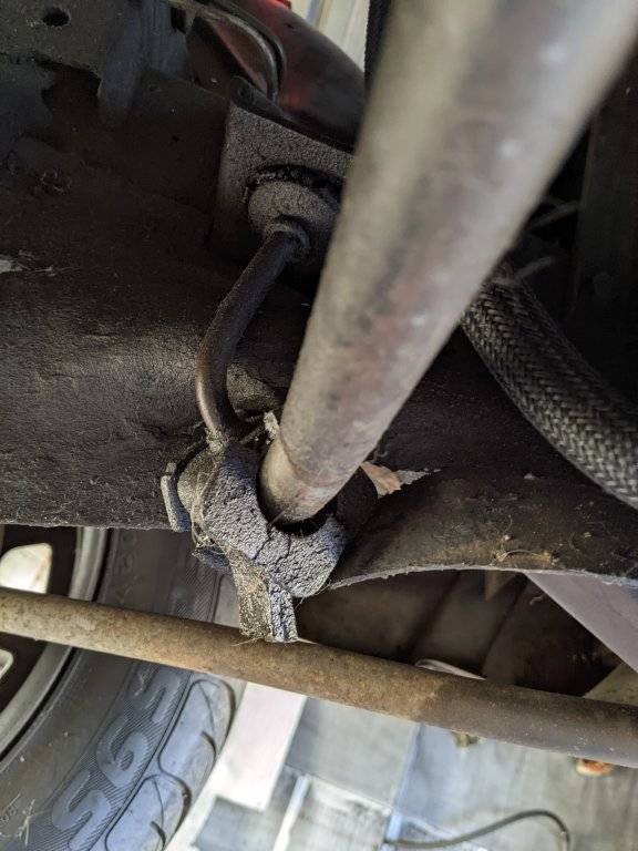

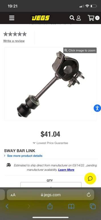

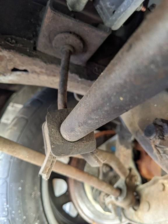

Hey guys. Tried a search but no luck. Are the sway bar link pictured here a stock set up and are they supposed to bent on one side? Obviously all of it needs replaced, just trying to fit the new engine and wondering if this is going to be different in the end any way.
In ‘68 they were straight.
Those look extremely bent. The bends don’t match from side to side.
Not sure what year you have there.
It’s time for new bushings as well and an alignment.
One word of advice: if you intend on straightening and reusing your existing links, spray the ever loving crap out of those nuts on top with PB Blaster before removing them. I snapped off one of mine by hand on a completely rust free AZ car.
Before you spray any crap on them, wire brush off all the rust and dirt. Will go much better.
