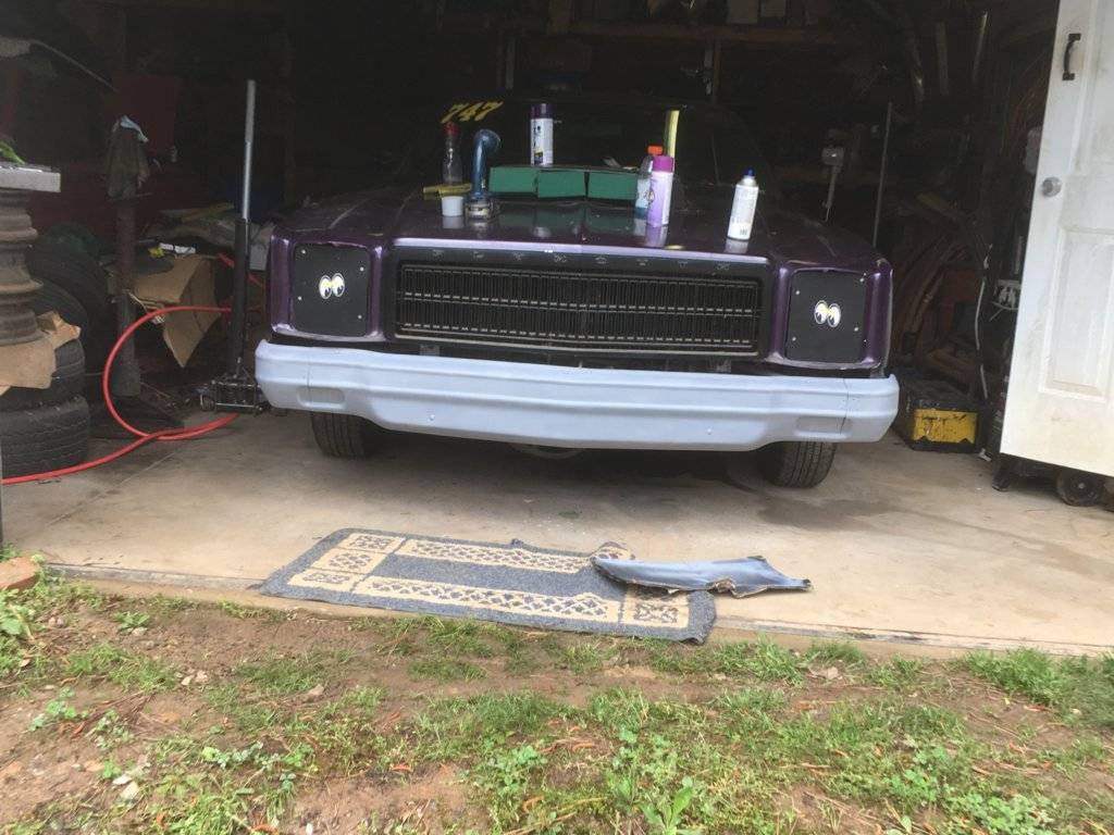

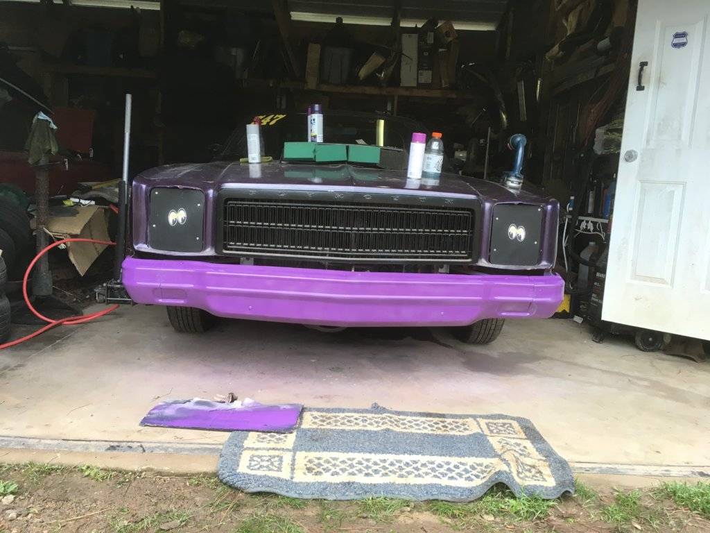

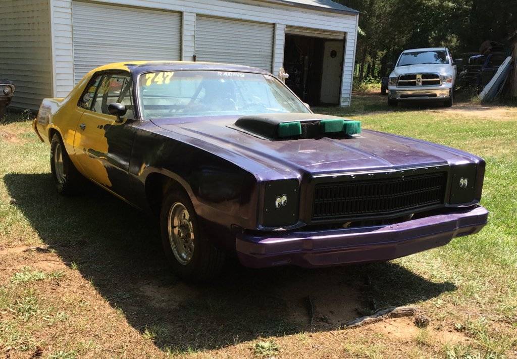

After a pretty decent rain shower passed & dried off some I put 2 coats of primer on the bumper. Followed by 2 coats of base. I wish I had used black as a base but the lite purple should do. I’m letting the bumper dry over night due to the humidity. Tomorrow I’ll put on 2 coats of dark purple. The car is ready to go to the track to start some shake down runs. Just a lot of rain. And scheduling conflicts. Hopefully soon I can start with that process
So June will make two years I’ve owned this car & it’s not made it to the track yet. A lot of improvements have been done. Here’s a summary of all that’s been done starting at the front bumper & working rearwards

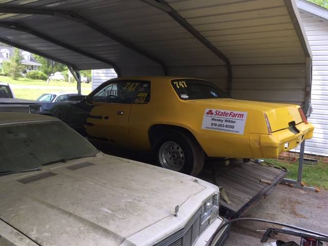

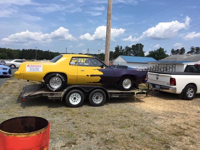

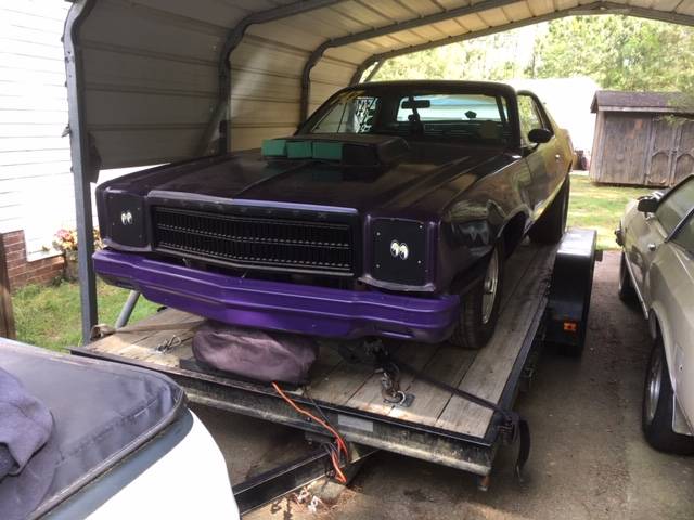

I loaded FURYIOUS on the trailer & pulled it under the carport. She awaits a date at a local track. Scheduling is weak as far as test N tunes. Freed up a bay in the shop so I pulled the Land Shark in & will do some work to it.

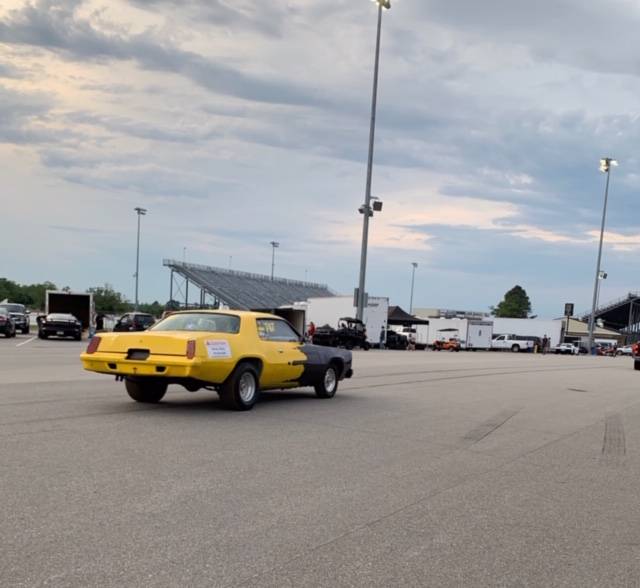

Look what went out to play tonite. Very pleased with the test. I got a strong horse. I also got a LOT of chassis tuning to do.
Ok I made 4 passes. First two just lazy checking things over. Pass 3 I tried a burnout & botched it due to shifter issues. I do not like this shifter & it’s comming off. I deep staged & left at 1000 RPM. Rolled out to the 60 at half to 2/3rd throttle & then floored it. Shifted at 5000 to second. Went to shift at 5 again to third & shifter just wouldn’t shift. Finally it went in. Ran a 9.01 @ 80 MPH. It was getting late & only a few cars in the lanes so I let it cool 20 minutes & headed back up. Much better burn out. Staged good & I had got mixed in with the no time carss & they had tree set on Pro. I left at 1200 still rolled out about to the 60 ft untill I floored it. Shifted at 5000 & then just before the traps the shift lite came on & I shifted to third. Clicked off a 8.75 Those last two passes the car was floored at half track. It lifts the front up like a gasser & floats all over the track. It’s a handful. And I’m running a 3.08 gear so that’s why it traps going into 3rd gear. So taking the 8.75. If I leave at 2000 full throttle & can trap 5500 in third & dont have to chase the car all over the top end I believe it’s costing me a half second. That would make a 8.25 & then I can improve it from there & should find another tenth or more. So I went out to my shop & as I thought I have a pair of CE adjustable front shocks. I will put them on & see if it stiffens the front up. And I’m going to order a brand new set of 30 x 10.5 biased ply slicks. Then I will build my case with a 4.86 gear that I already bought. That should fix a lot of the problems.

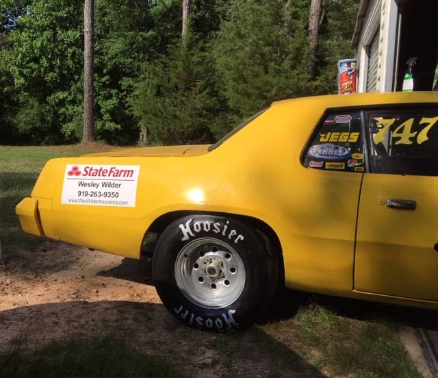

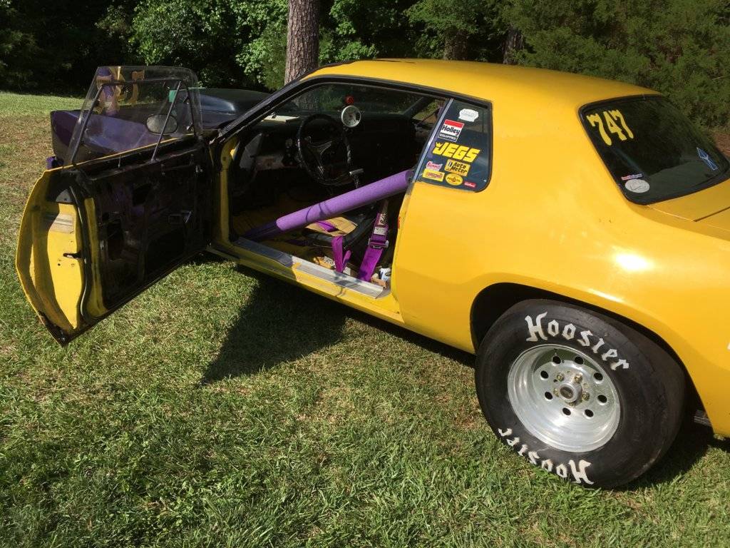

Well she’s about ready for some more shake down runs. A couple minor things to do yet. Since her first outing I’ve installed new front shocks, rear slicks, lowered her 1 inch. Plan was Galot Motorsports Park this Sunday. Same track as her debut but the heat index is off the chart the next 4-5 days approaching 100 so I’ll let her sit till the heat wave passes. If you are in the area come on out & meet FURYIOUS & myself
Ok lowered the rear 1 1/4, new slicks on & new shocks on the front. Pulled her out in the sun shine & gave her a bath. Hope to go out this weekend if the weather holds out.

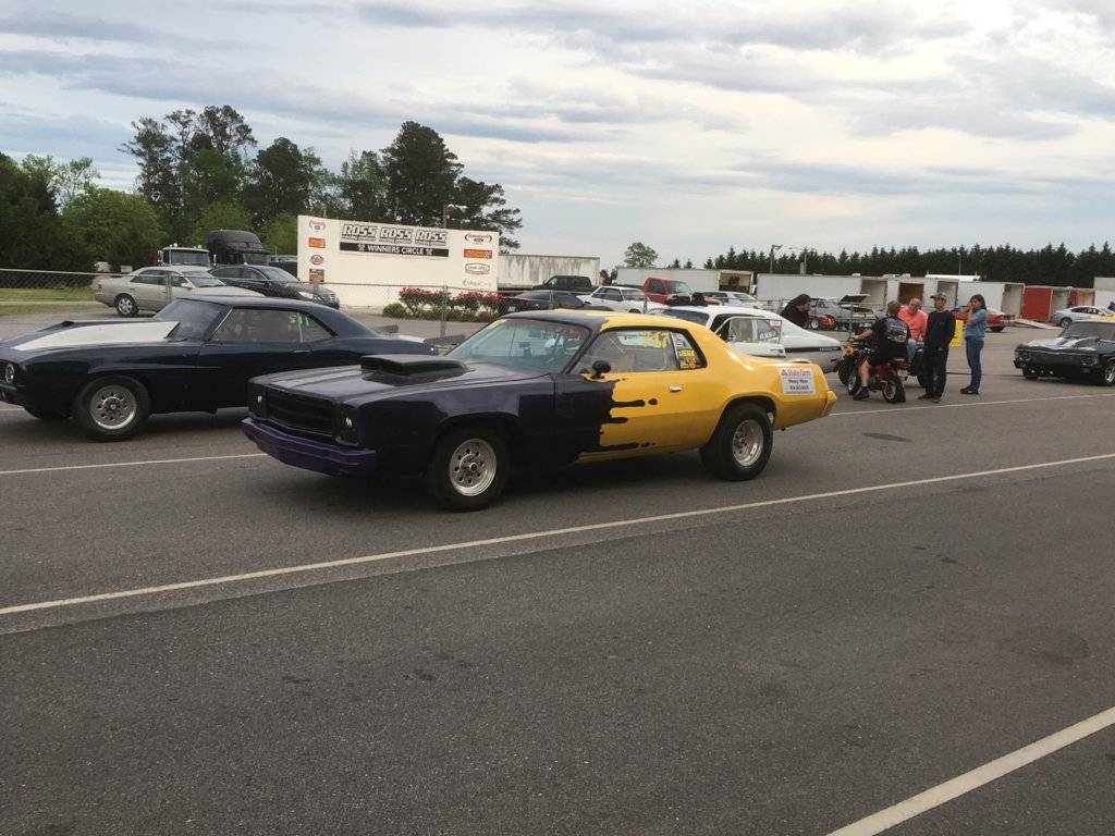

Ok some more progress. I took the car out to a local track & made 5 passes. The car was no longer bouncing down the track so the new shocks fixed that. The handling was much improved but still a little twitchy on the top end especially after crossing the stripe & the car settling down. So I lowered the front T bars 1/2 inch & dropped the psi in the rear slicks from 18 to 16. Went out on pass 3 & it handled much better. Straight as I can drive it & down right smooth. However the car dropped off 2 tenths. Looks like it spun despite a killer burnout that had smoke rolling out of the wheel wells. So pass #4 i shifted at 5200 & the car picked back up one tenth which was good as it was 95 degrees now. So it ran a 8.71 @ 83 mph on #2. 8.83 @ 83 mph on #4. So I went out for one final pass. Temps had cooled to 93. I decided to shift at 5500. Car hooked good & went 8.73 @ just a tick under 84 mph. With the 3.08 rear gear I only have to shift once on these 1/8 mile tracks we have around here. It crosses the stripe in 2nd gear at 5000 so I’m thinking about putting a 3.55/spool in it. That will help it out of the hole & should be able to still shift just once & trap under 5500. On another note I’ve scaled the car at two different tracks & it was 3230 with out me in it at both. Surprised it’s that lite. Yea I could put a 4.56 gear in it & pick up 4 thenths but I like the one shift strategy. Kinda like a torqueflyte/powerglide. Now that I have it driving good I can work on Performance & consistency.
If you use a conversion table, your 8.7-8.8 comes out to mid to high 13's at around 103-104
Why the low rpm limit? Engine should breathe to 6k I would think?
