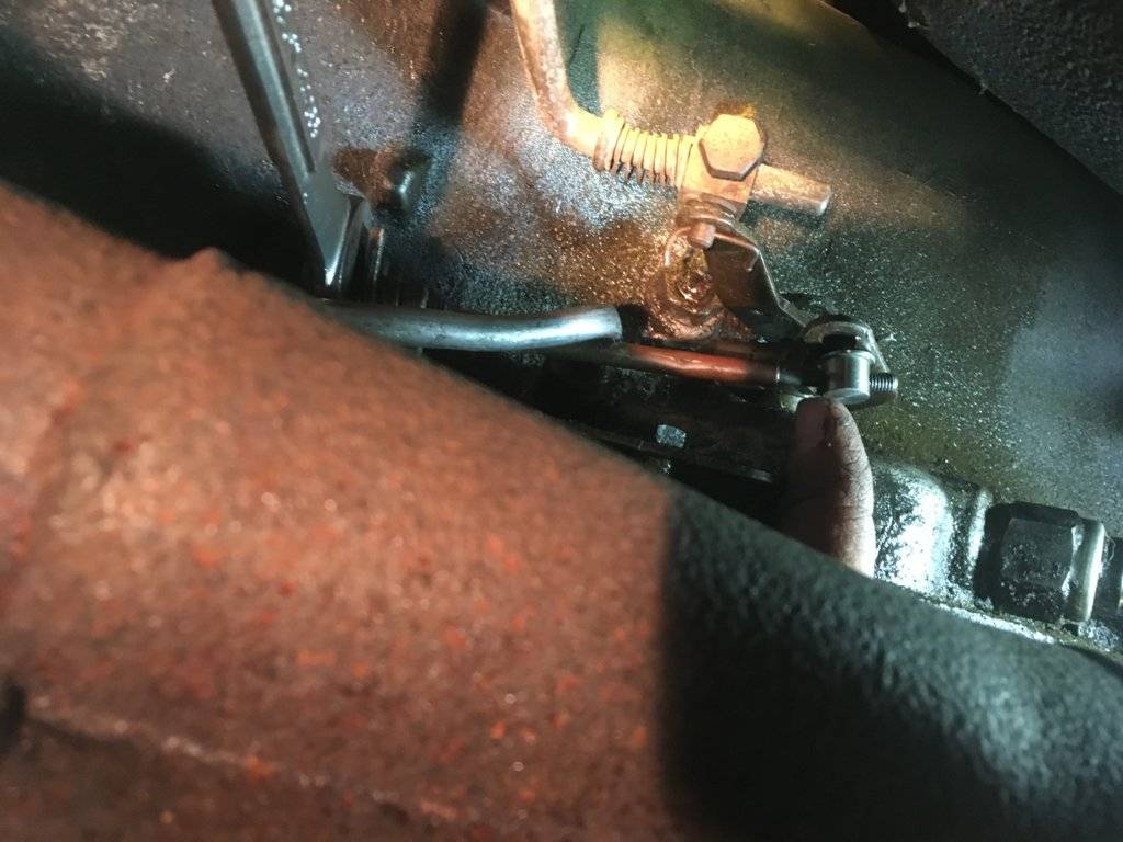

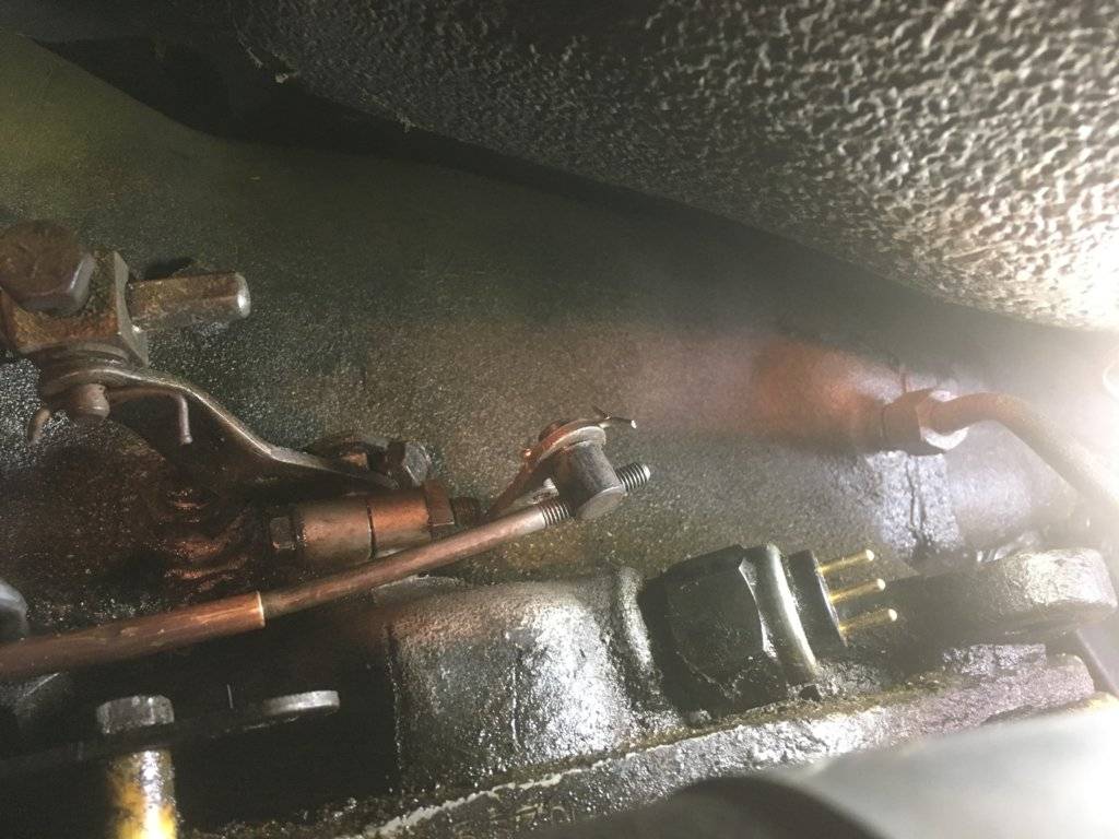

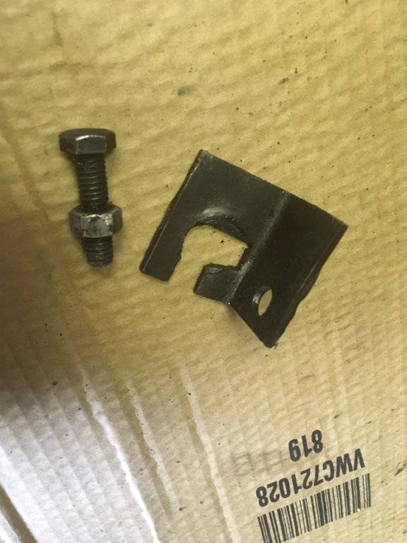

As I continue to mark off things on the punch list. I made it to the shift cable. The car has a B&M ratchet shifter that didn’t ratchet well & was in a bind. Especially in low gear. So after looking things over I decided to try and adjust the Morse cable to get a more positive detent feel in low. Very difficult to do as the big block with headers & torsion bars made for a tight fit. After several hours I had made it worse. So frustrated I put it back to how it was & watched a video on YouTube explaining the proper way to adjust it. So went back at it & got it to detent good in low but then it wouldn’t go into park. No matter how many turns in either dirtection I couldn’t find the sweet spot so I looked closer & noticed the trans linkage arm has 3 holes. The clevis pin for the Morse cable was in the center hole & that appeared to be incorrect & causing the bind. So I found a pin from another shifter I have that fits the outer larger hole & installed it & a few turns of the wrench & BINGO ! That fixed it. Shifter hits every position much better. As you can see in the pic the cable end is bent so it still binds if I put it in park too hard. So I need to fab up a stop block to prevent it from going past that section on the detent. Run a bolt through it & lock it down. This will prevent the shifter from going past the detent & binding up. I spent 6 damn hours on this frigging Morse cable Saturday. Only to find it was in the wrong hole. I also took this bracket off. It was in the way of the wrench for the jam nut & I’m leaving it off as I can’t tell it does anything. Thank goodness I had that larger clevis pin from that spare shifter or else it would have been another trip to the hardware store.

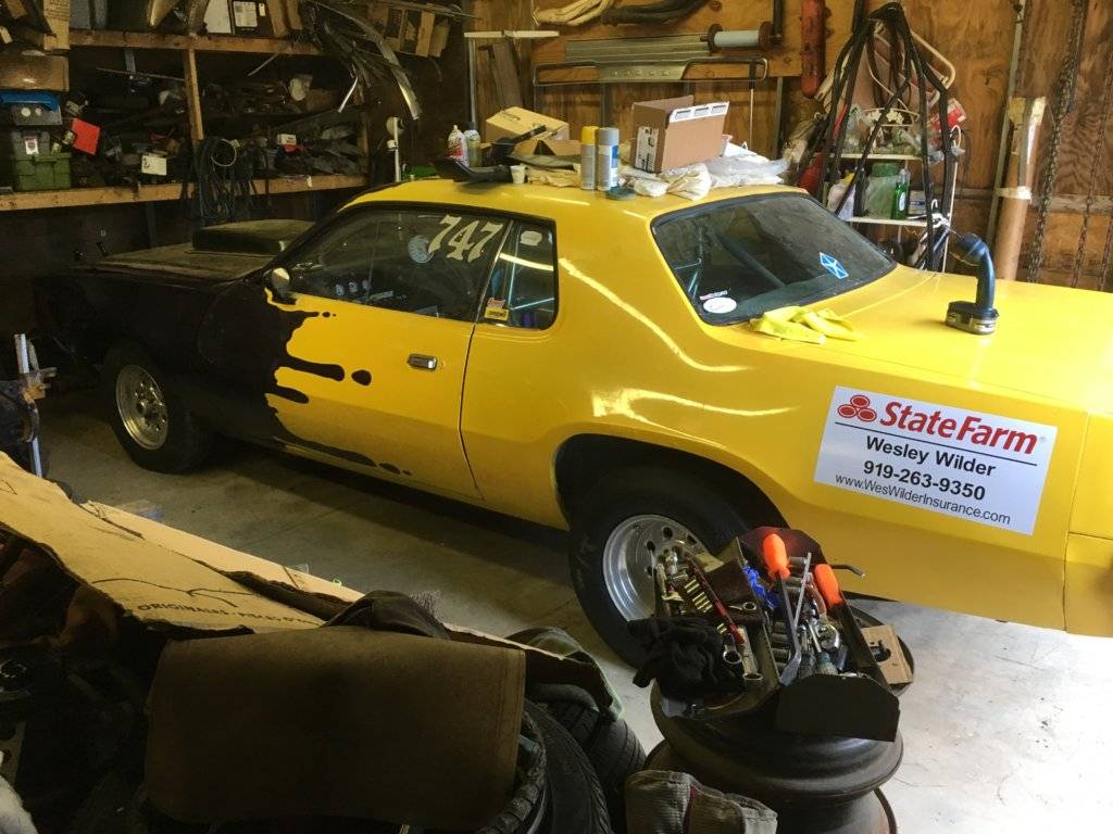

Brush strokes

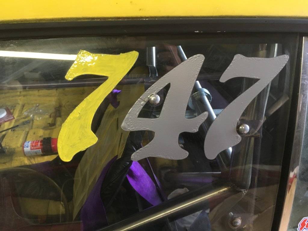

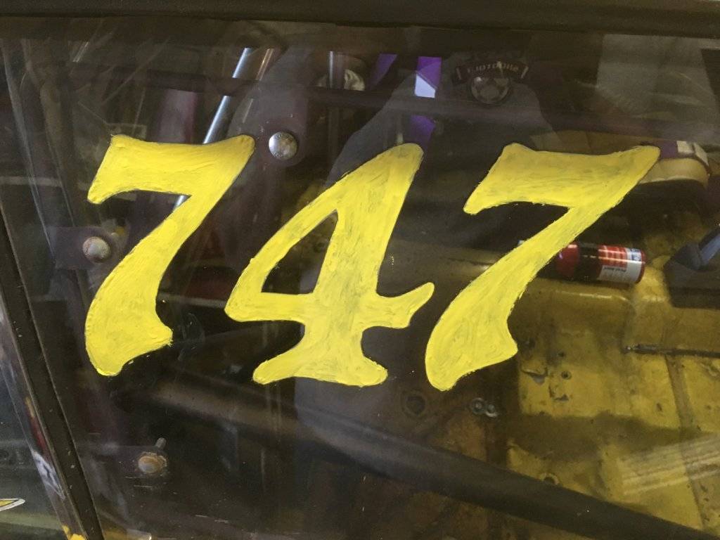

Yea I didn’t like the grey vinyl numbers on the windows. Didn’t fit the car at all & hard to see. So I painted over them today in yellow for that old school brushed on look. I’ll add another coat for better coverage. Stands out now & much easier to see. I also fixed a bunch of piddly things. Little loose ends here & there. Her debut is getting real close.
Why is the arm bent up so high? Is it just the picture?
No, unfortunately that’s how it is. The jack-leg that installed the cable did this. I tried to straighten it & did some. It shifts pretty good now just a little tight going into park. For now I’m going to leave it.

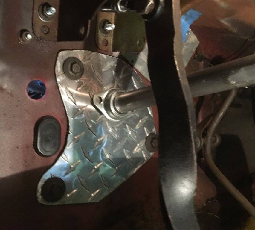

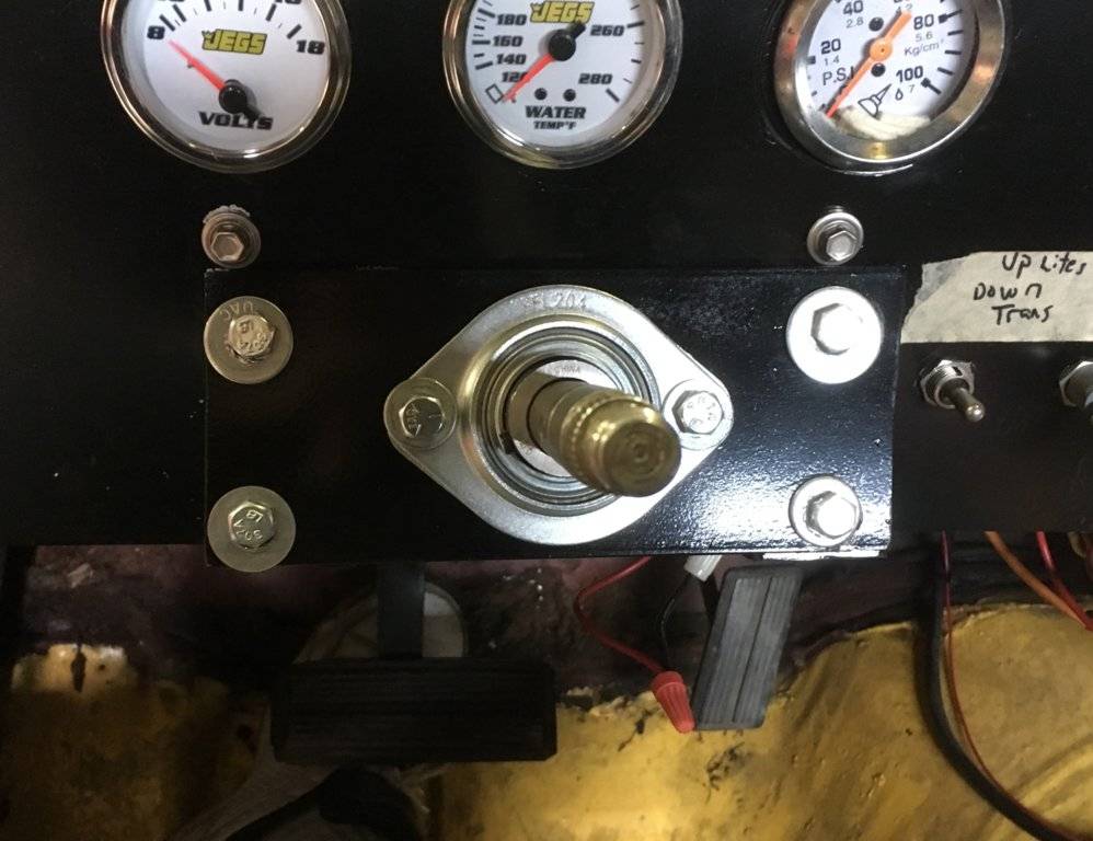

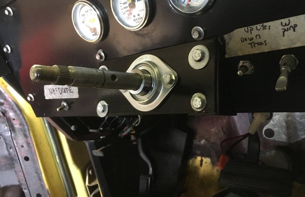

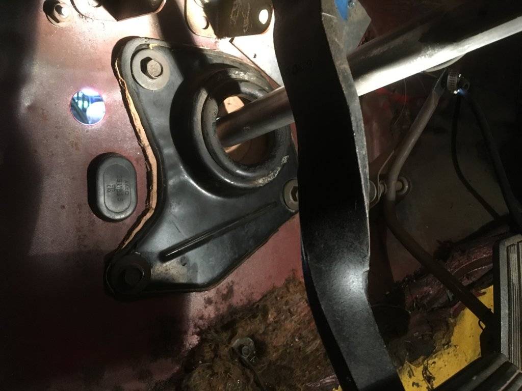

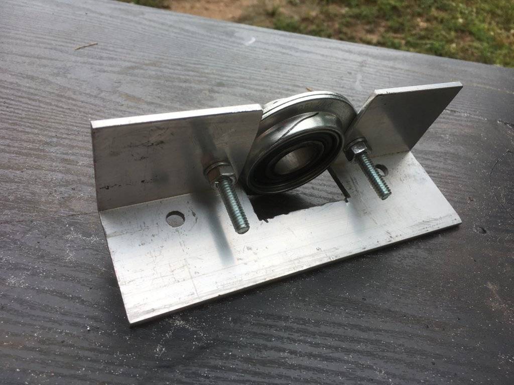

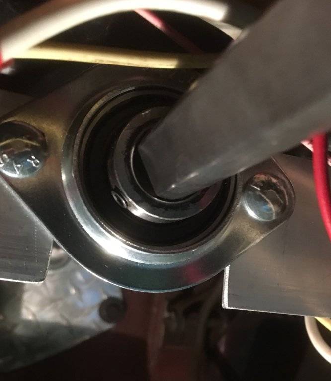

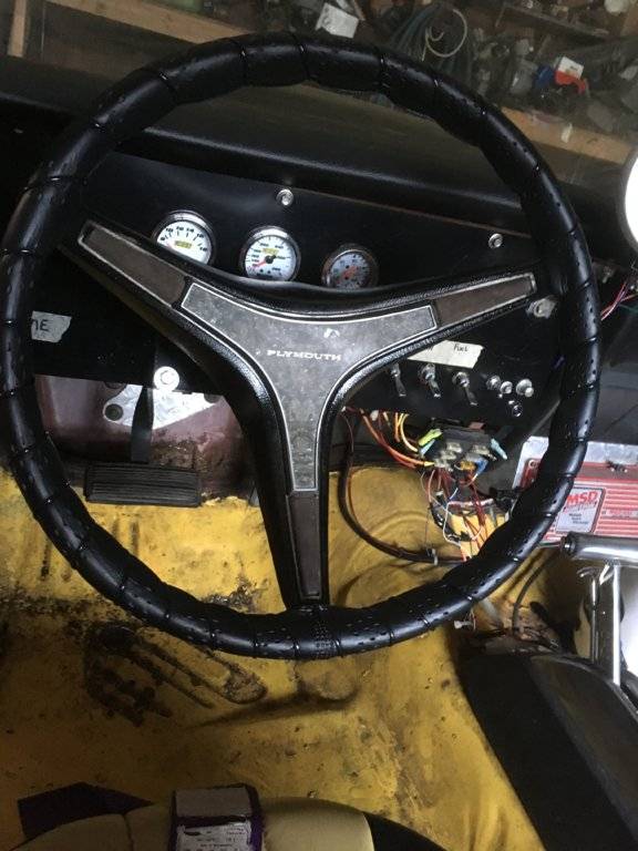

An awfull lot of work has been done to FURYIOUS over the last month. I finally have the steering shaft in place. I am using just the original shaft. I stripped the column down. I had to install a Flaming River adapter at the steering box because I installed a B body aluminum manual box. Then I made a plate at the firewall & installed a bearing there for the shaft to go through. I then cut a piece of aluminum angle & fitted a collar bearing to the angle plate. Bolted it to the original steering column mounts. The shaft still had too much span & didn’t feel secure & strong. So I got a piece of steel angle & fitted another collar bearing to it & bolted it to the outside of the sheet metal dash. Both collar bearings have set screws. Now much improved & I feel safe. Painted it & got a 72 Plymouth Fury steering wheel. Painted the center black & installed a black wrap around the rim. Looks good.

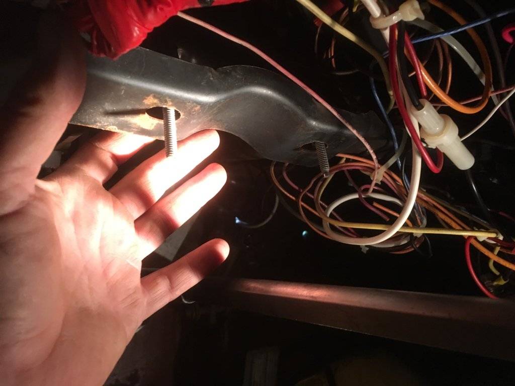

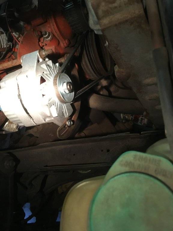

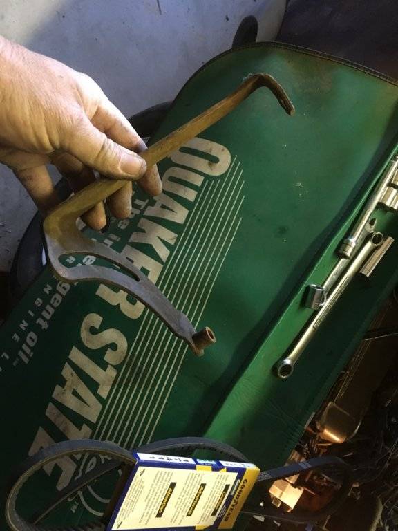

New AC Delco plugs & a new GM 60 amp alternator. Also a new Holley 30 cc pump diaphragm installed. Had to cut down & modify the Chrysler bracket to fit the 60 amp alternator. That’s it on the bottom & you can see I now have plenty of travel. The old 78 GM alternator was maxed out on travel.

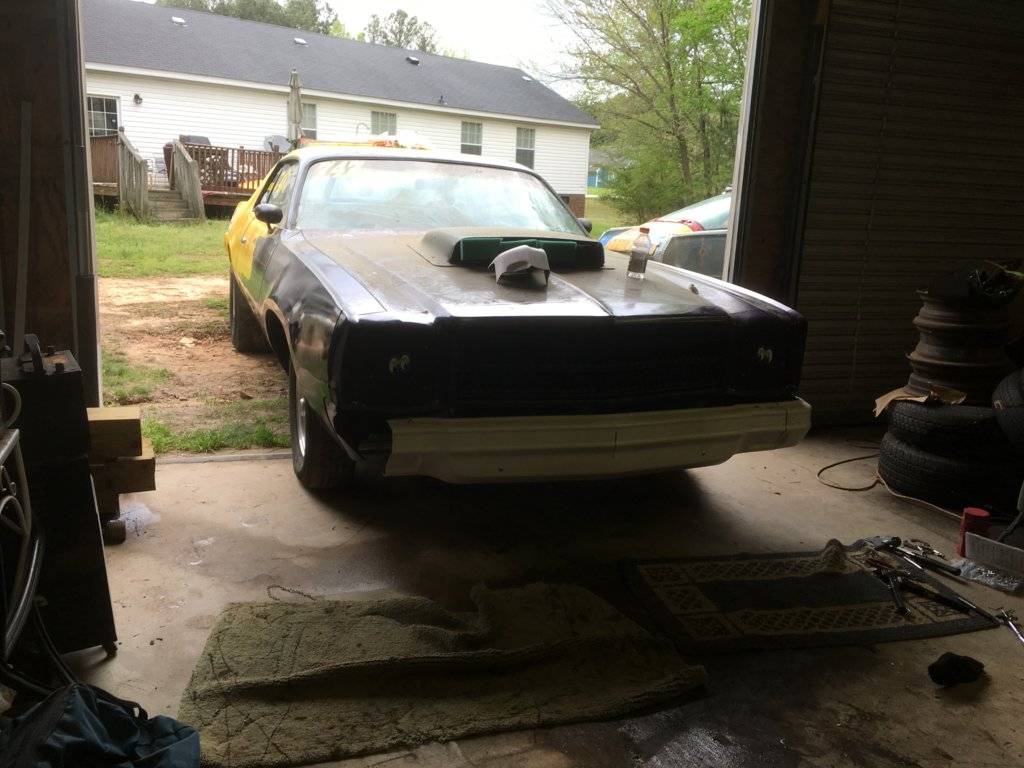

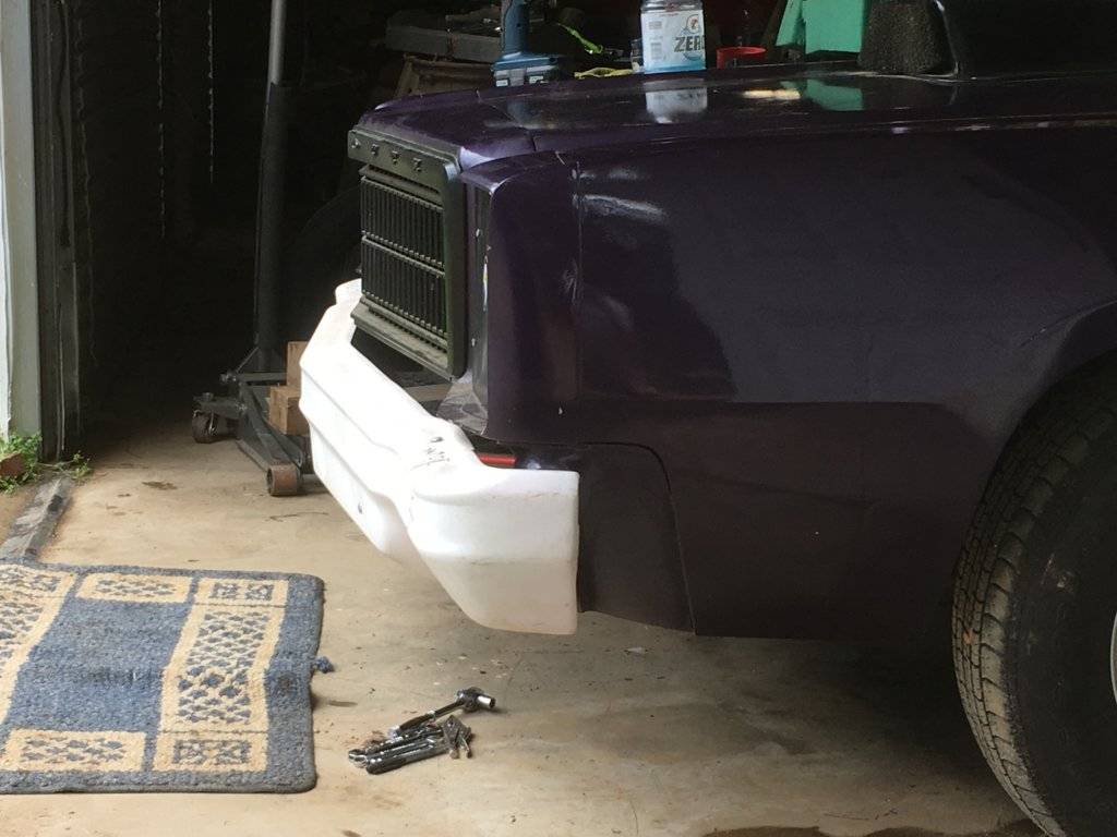

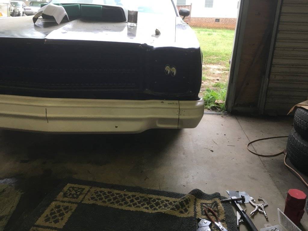

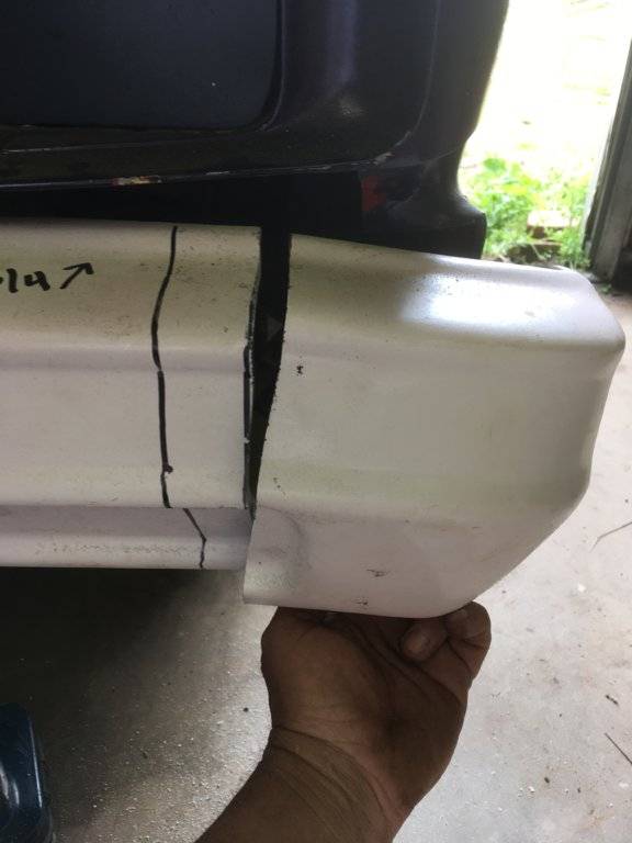

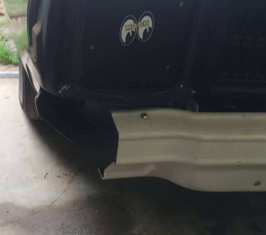

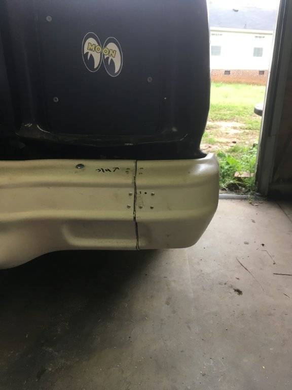

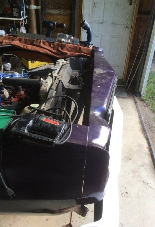

Then I turned my attention to the front bumper. The stock bumper is heavy. An online search turned up no fiberglass bumpers so I bought a glass bumper for a 75 Malibu from a company in Canada. It was drop shipped out of Florida 5 weeks later after 3 calls to Canada asking where it was. I mocked it up as seen in these photos. It’s too wide. About an inch each side. 50 pound weight savings so I had to make it work.

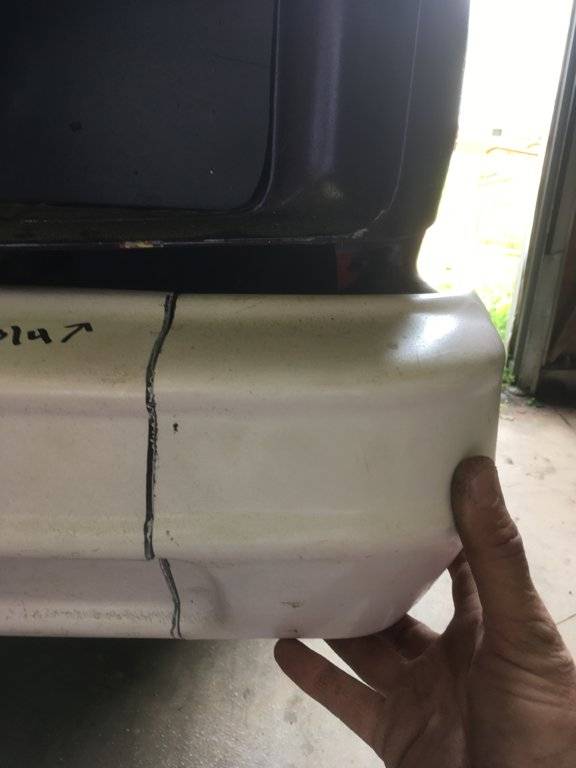

Since I was happy with the look of the bumper. And the quality. I decide to section 1 inch from each side. As seen here

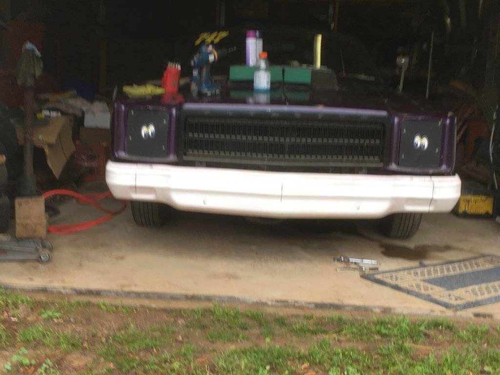

Then I cut out some sheet metal plates & drilled 2 holes at each end. Matched those to holes drilled in the bumper & putting the plates on the underside I pop riveted the bumper ends back on.
Now the bumper looks correct & I doubt anyone will know it’s a Chevy bumper. I also decided to add a brace in the center just to be sure since that’s a long span. And yes that helped form it up
