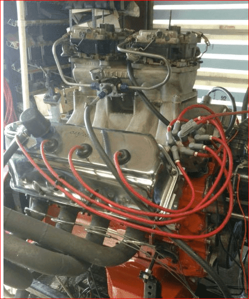

well my friend fast cost money sometimes . it will run good with a couple holleys or carters sitting atop a tunnel ram , just less wow factour . and perforance . and money isn't that for spending , lol . your just thin do the spread of projects , i know the feeling believe me , lol .
How about a pair of Thermo-Quads
i guess , never ran them as a pair , square bores carb plates mounting are what tunnel rams and blowers use , but i guess you could put adapter on there . maybe a couple 650 cfm . with those small primaries it should get good fuel mileage , lol ;) .
I talked to a guy that had a pair on a stroker 340. He said they ran very well
Fella near here runs a pair on his truck, but I think he's at 572" (hemi) or something silly like that now. And he's not satisfied just using TQ's, he had to modify them to run E85 in it too. Runs pretty strong.
Okay - had to go check, he's running a pair of 850's, and he's now at 605" on the block. Last number I heard was just shy of 820 Hp

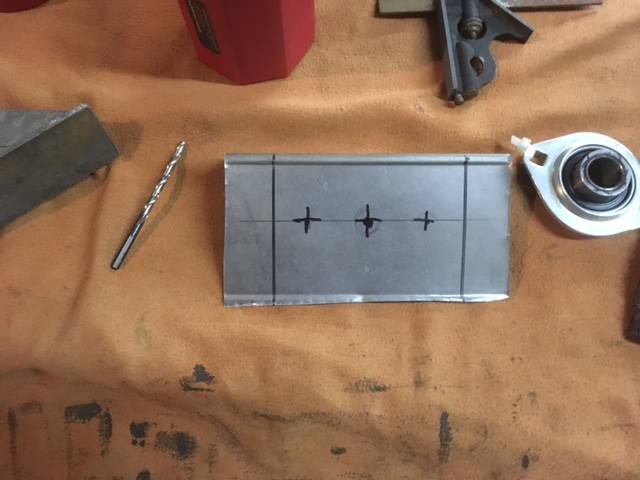

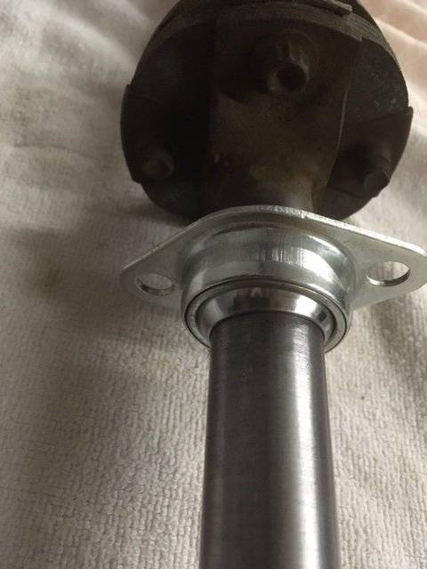

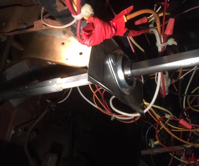

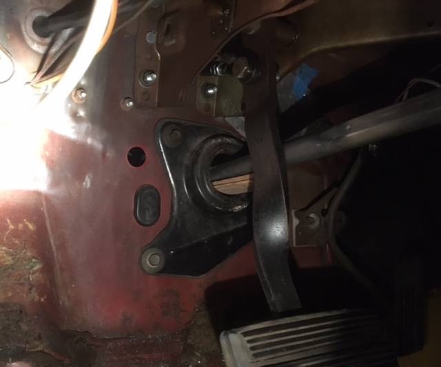

Weather was horrible so I spent the day in the shop working on FURYIOUS. I started mocking up the steering column. I had already stripped the stock column done to just the bare shaft. And bought two steering shaft bearings from Speedway Motors (they have a lot of cool stuff) One bearing fits at the firewall. I need to fab up an alunimum plate to fully mount that. That part will come later. Method to my madness. Today I fabbed a piece of tin to mount the upper column bearing in. And have it bolted to the factory column mount. After I'm satisfied I will transfer it over to a angle steel plate that will be lightened & ground down on the edges.
Then I installed the column & connected the pot to a manual to power adapter. Bolted the tin piece with the column & upper bearing mounted. I didn't want to use the pot adapter but I could not get the factory p/s pot to fit on the manual gear box. Next is to reinstall the seat & get the height correct & then I can go down to the firewall & fab up the mount for that bearing to help maintain the steering shaft alignment.
It will be a lot of trial fitting & trying to get it all safe yet as light as possible. All this to save about 12 pounds. I enjoy doing this kind of stuff.
