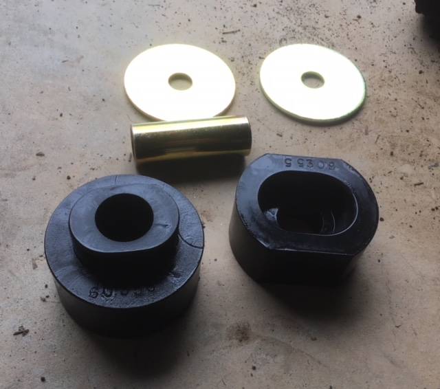

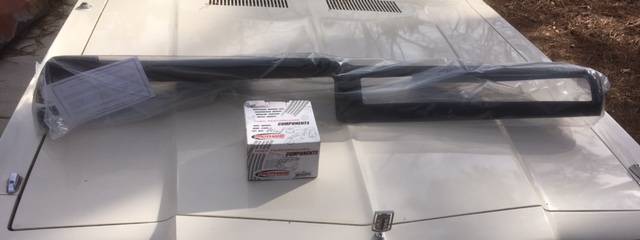

Some more new parts arrived today. A dash cap & polyurethane K frame bushings

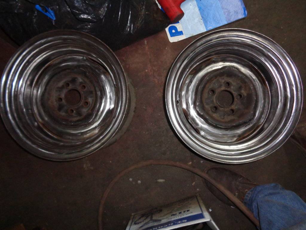

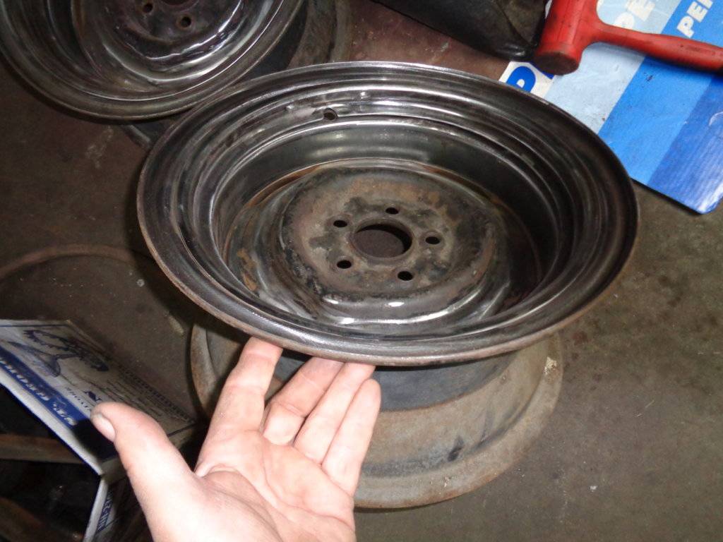

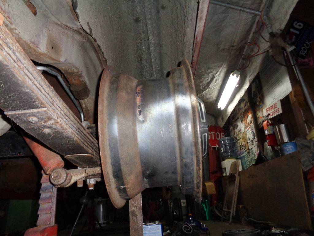

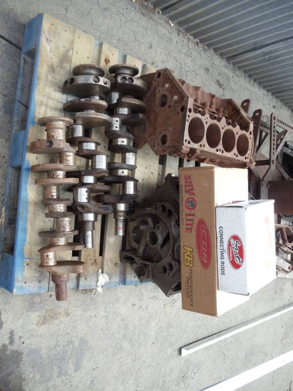

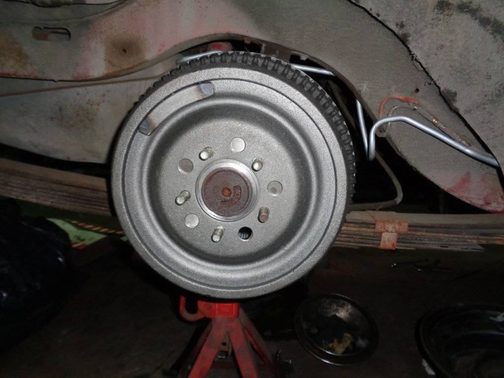

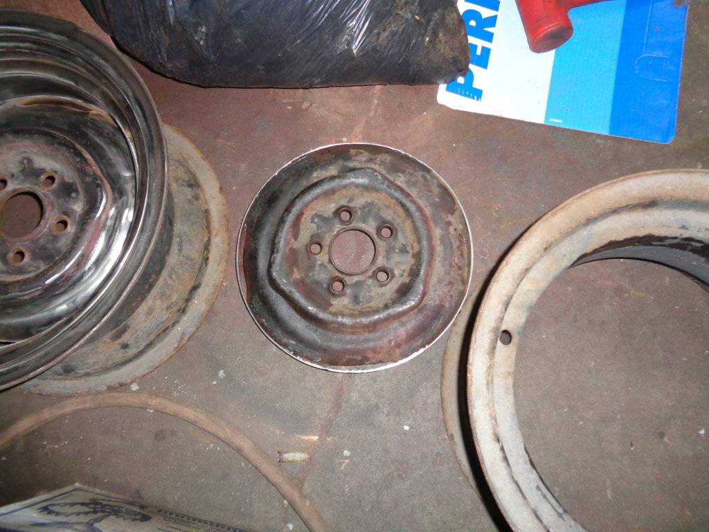

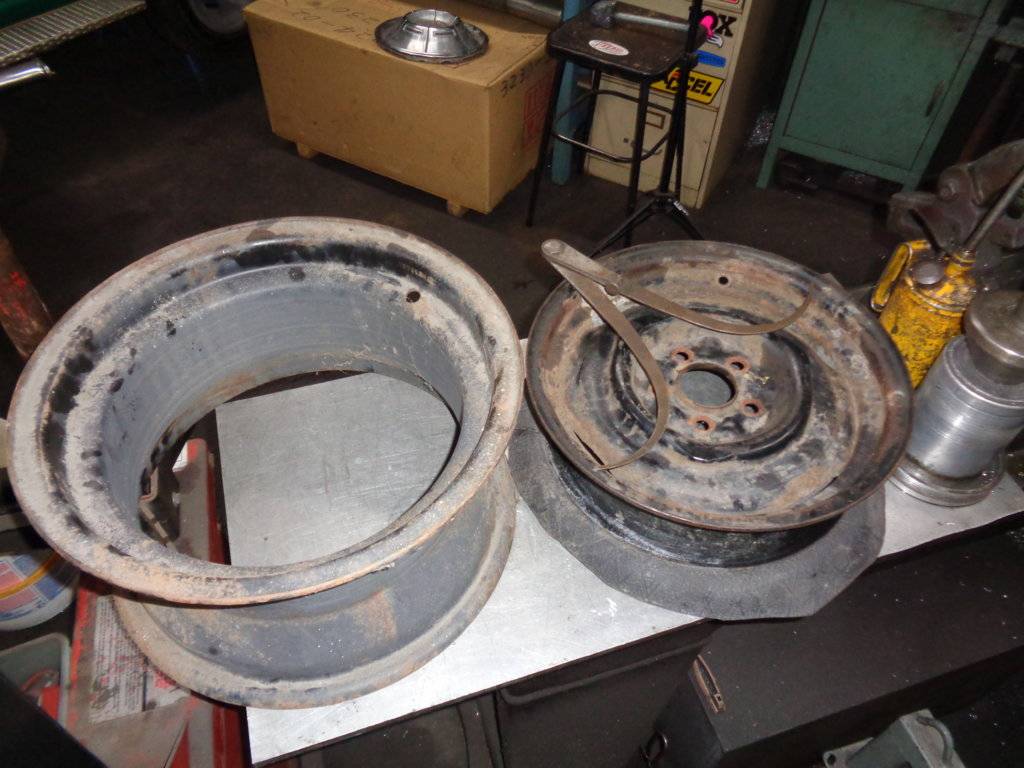

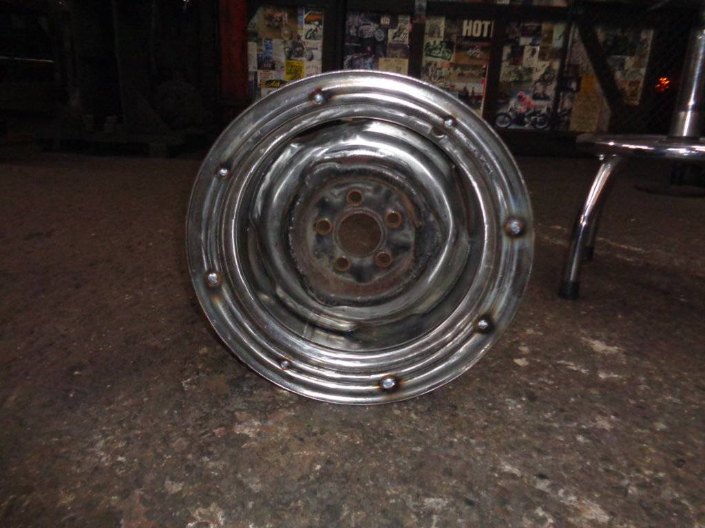

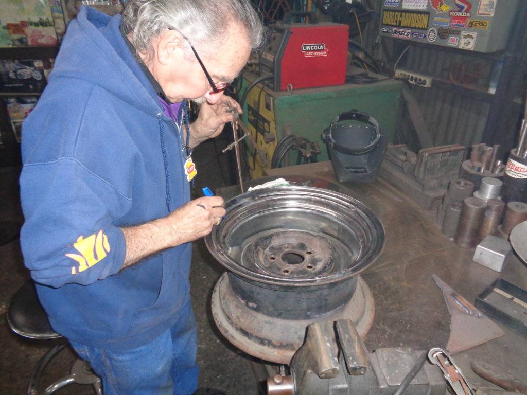

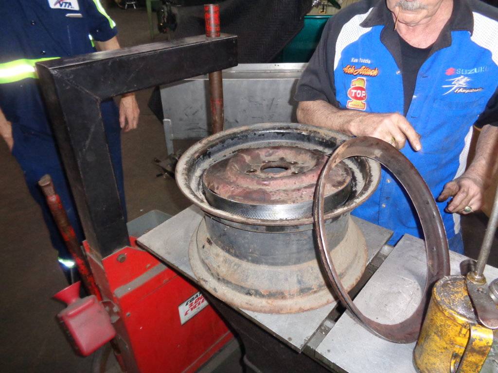

bob , your racer is getting better . just pulled out some pistons from a older street racer engine , bores got some water in them . that block will need new slugs . so these will get another block bore to them , added some h beam rods from another motor , and a good stock steel crank . and it will be a great runner . the little sleeper dart i'm doing for a customer is waiting for parts to show . the balancer is taking his sweet time getting the rotating mass back . and i ordered up the hp hd suspension for the dart . again still waiting . here is a couple pics of the dart build , the rear wheels are 15x8 now . used the centers from a pair of 14's and the rim edge ring so the customer can run his full dart 14'' wheel covers . had to get the ford 11x2 1/2 drums off his dana 60 , and put chrysler 11x2 1/2 drums on it and turn down the wheel
reg hub on the axles . so the 14'' rim center would fit . oh ya thats ken puccio at the lath n welder on the rims . he is crew chief and head machinist on the ack attack streamliner bike . they've set some records with that machine .
Ok educate me. You put 14 inch centers inside the 15 outer ring. And why is the Dart hub cap welded to the wheel
yes , i found some 15x8 rim bands that we can put the 14'' rim centers in . did a set for my 67 300 rag that i had . and did a pair for the rear on my 69 dart . the rim area for the 14'' wheel covers were cut from the 14'' rims and laid into that 15x8 band . just so i could get some meat on the rear of his dart , and put his wheel covers on , so it can match the fronts with full wheel covers . this thing is a sleeper bob , its going tobe a 500 hp 500 plus fpt 440 at 5500 rpm with headers and a torker intake , alum heads , custom roller cam , quick fuel carb , a built 727 with a gear venders od on it , dana 60 with 4:10's n a track locker . its a 70 dart more door sedan . its going tobe granny's church ride , that super stock dodge , lol ;) .
bench seat auto on the column with torque boxes and subframe connectors . and it will have sway bars big t bars and rear leafs firmed up ps , 11x2 1/2 rear drums , k/h disc's up front

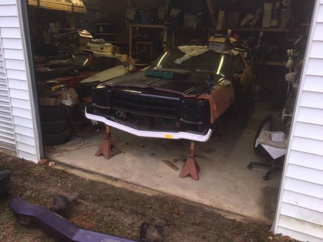

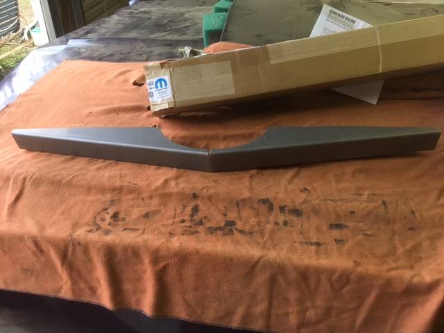

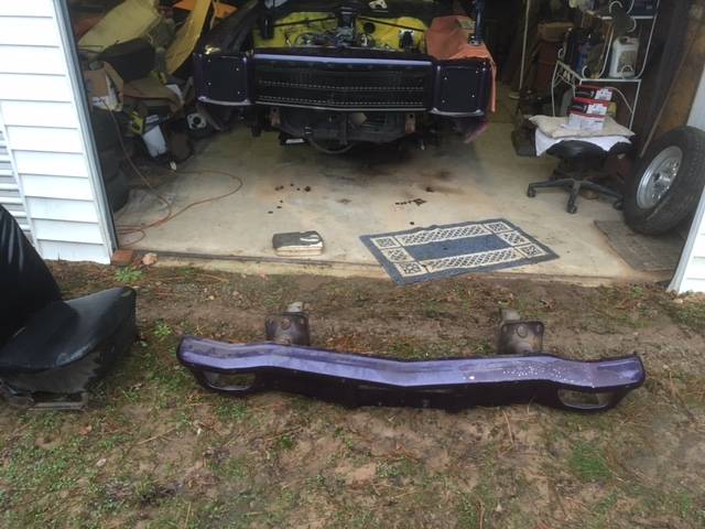

Well it started raining so I went in the shop & started working on her. Removed the stock steel bumper & started mocking up the brackets for the glass bumper.
you know for a racer , everything that keeps it on the track works . sometime it not pretty , lol . hey i'm looking at a 72 fury 3 2dr ht this afternoon , and some prewar dodge p/u's and parts . i'll shot some pics .

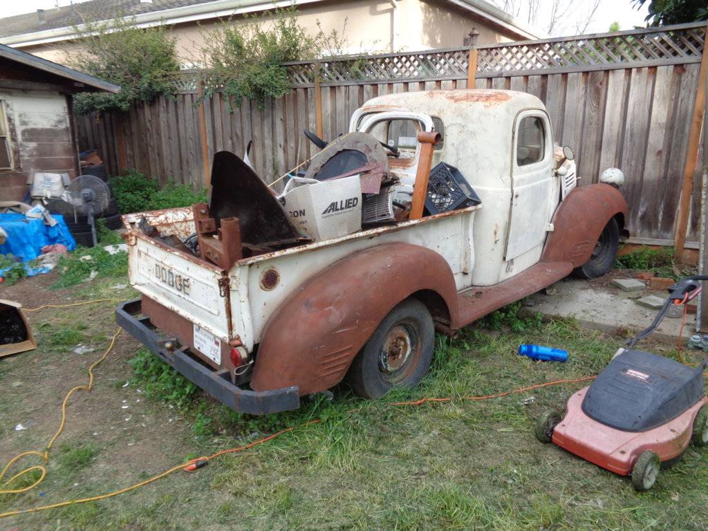

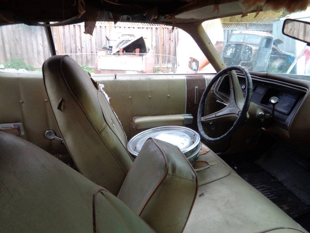

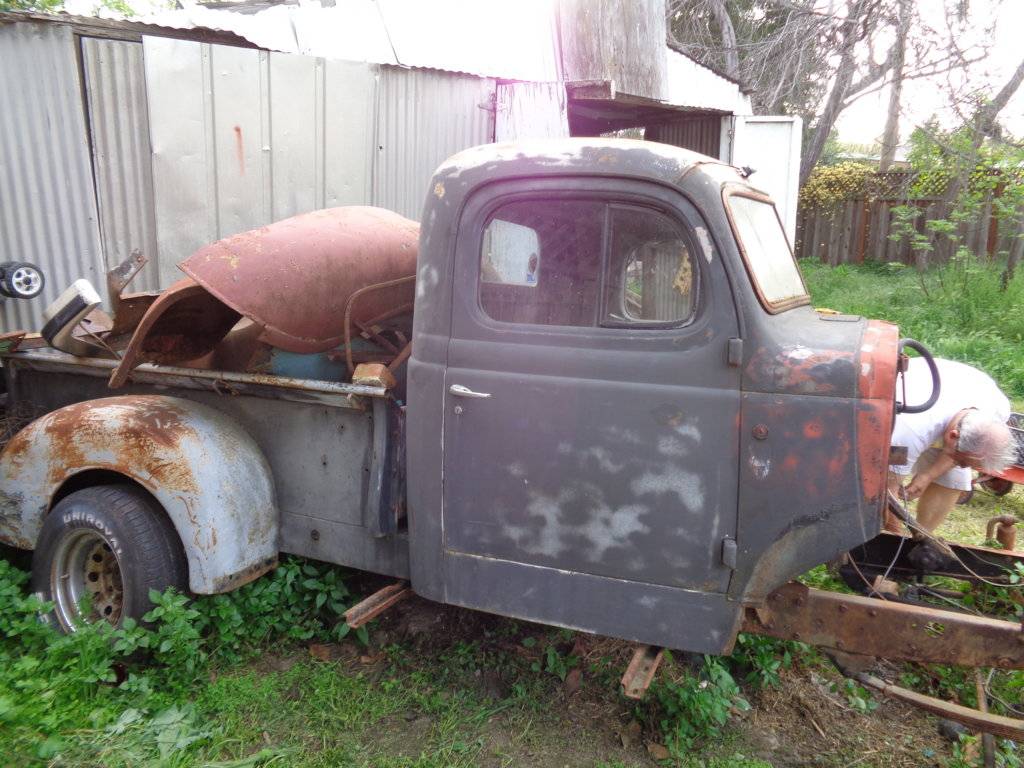

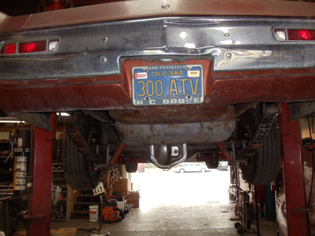

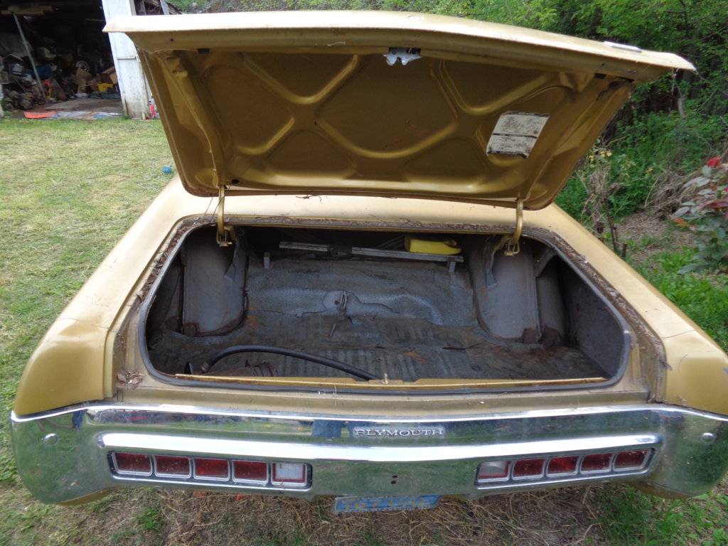

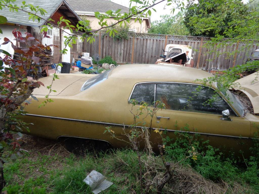

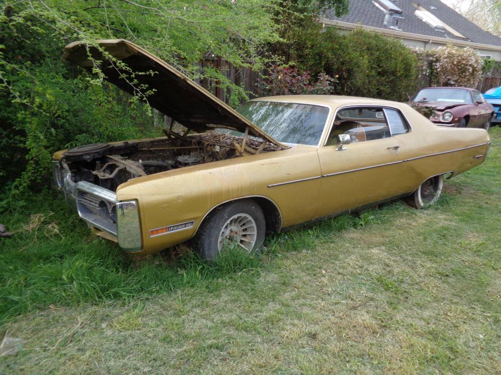

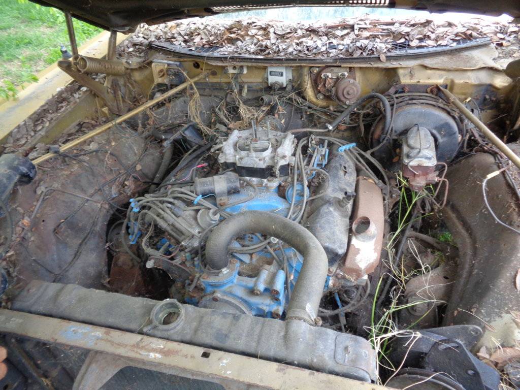

did i say i bought it yesterday . its coming down to the shop for its tear down . nice rust free car , oem paint . but its just
parts , and there good ones . the whole disc brakes package , spindle rotors calipers all the mounts , m/c , pwr bstr , valving n lines , running b 400 with 727 trans and a 8 3/4 r/e . lots of lots of great body and other good parts .
unless someone wants the body whole . i'll peel it and scrap the unwanted carcass . and i'm bartering a deal on the rest of the stuff . a couple 46ish p/us and a load of parts .

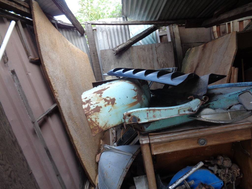

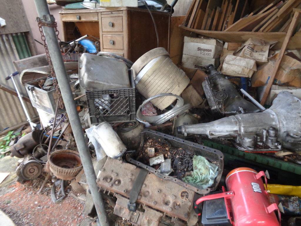

did i say i bought it yesterday . its coming down to the shop for its tear down . nice rust free car , oem paint . but its just View attachment 178954 View attachment 178955 View attachment 178956 View attachment 178957 View attachment 178958 View attachment 178959 View attachment 178960 View attachment 178962 View attachment 178962 View attachment 178963 parts , and there good ones . the whole disc brakes package , spindle rotors calipers all the mounts , m/c , pwr bstr , valving n lines , running b 400 with 727 trans and a 8 3/4 r/e . lots of lots of great body and other good parts . View attachment 178964 unless someone wants the body whole . i'll peel it and scrap the unwanted carcass . and i'm bartering a deal on the rest of the stuff . a couple 46ish p/us and a load of parts .
73 with an 8.75?
