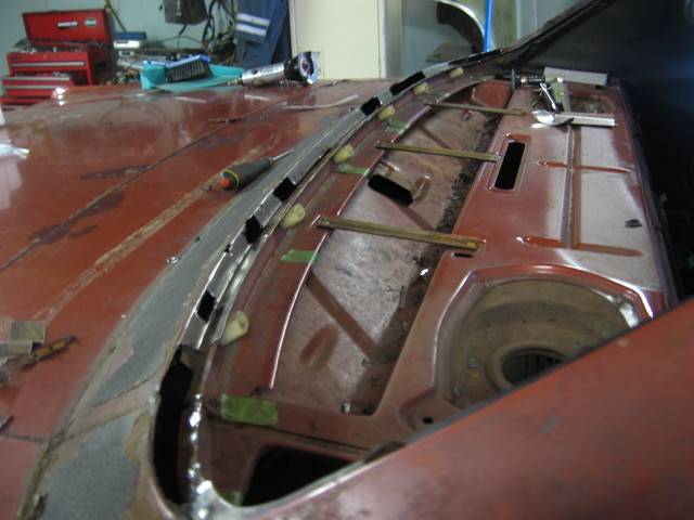

On the 69 F3 rolled buytl was used to install rear window after repairing the rust damage and new top installed..
Urethane caulking finished the sealing process after pounding down the glass into the channel.
On Maggie's car,typical Fusey unpainted roof and poor drainage.
Luckily we caught it in time before it got worse.
