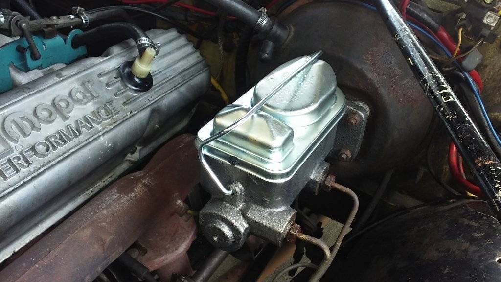

Wuts the best way to drain the MC....turkey baster? OR maybe it doesn't have to be drained...I've got plugs.

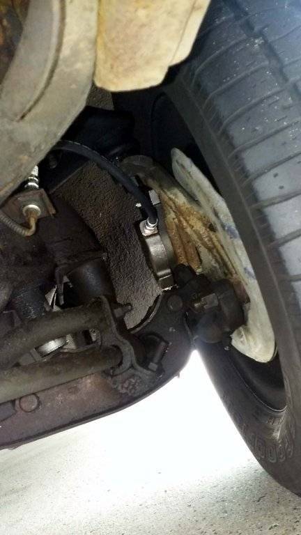

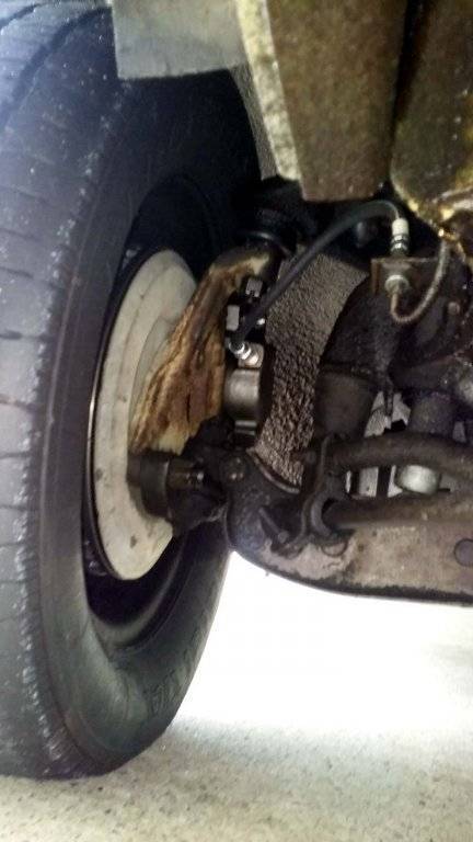

Did a "pre" - test last evening in the driveway. Back down the driveway and back up....slow stops, and a couple hard stops going forwards and backwards. The pedal feels pretty good...no spongy feeling, but its not hard as a rock either. Once the discs grip....they stay gripped. Got enough guts to drive around the block last night ..after all the traffic mostly cleared. Again the brake feel great coming and going. I parked in the garage over night so that if there were any leaks it would show up on a board I have underneath the parking area. NADA.

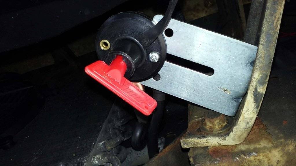

So went out on the roads this morning..into traffic. Didn't seem as if there were any problems. If they calipers are dragging can it be heard? Rode around for a good while, came back and took some shots. Oh, and found a great spot for the disco switch.

Disco switch is ground side, right? That way even if it gets dislodged or pinched, it wont do any unauthorized welding for you. I like it though.

Battery DISCOnnect...
Thanks Stan that's what i was thinking but wasn't sure
