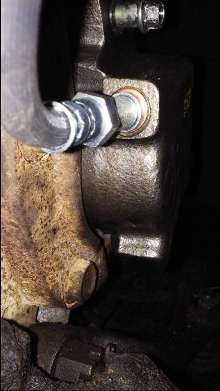

So I'm bleeding the pass side caliper.....and I noticed there is fluid dribbling from where the hose connects to the caliper as the brake pedal goes down. It's barely noticeable...but its there. The hose came with a washer (looks like copper). Should there also be a rubber seal or "O" ring on this? The same thing is occurring on the drivers side as well...leaking.
No O ring. Try tightening it more. The copper gasket has to deform to the surface to seal.
IMO it just needs to be re-seated, at least thats free to try.
unattach the hose from the caliper, and while putting it back on, keep slight tension on the hose, pull 'away' from the caliper while screwing the fitting on - trying to keep the hose straight in line with the screw. i dont know how to say it. i think it was not flush, and needs to be.
i also tend to spin threaded things 'left' until i get to the start of the threads, then tighten. you can feel it in your fingers when it hits the start of the threads.

I've got both of those screwed in pretty tight...I'm afraid if I bear down on it more it could strip the thread.

I'll give that a shot.
Then take it apart, check for dirt or rough spots on the sealing surface and put it back together.

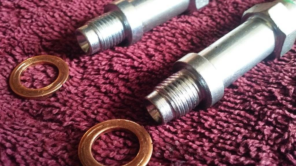

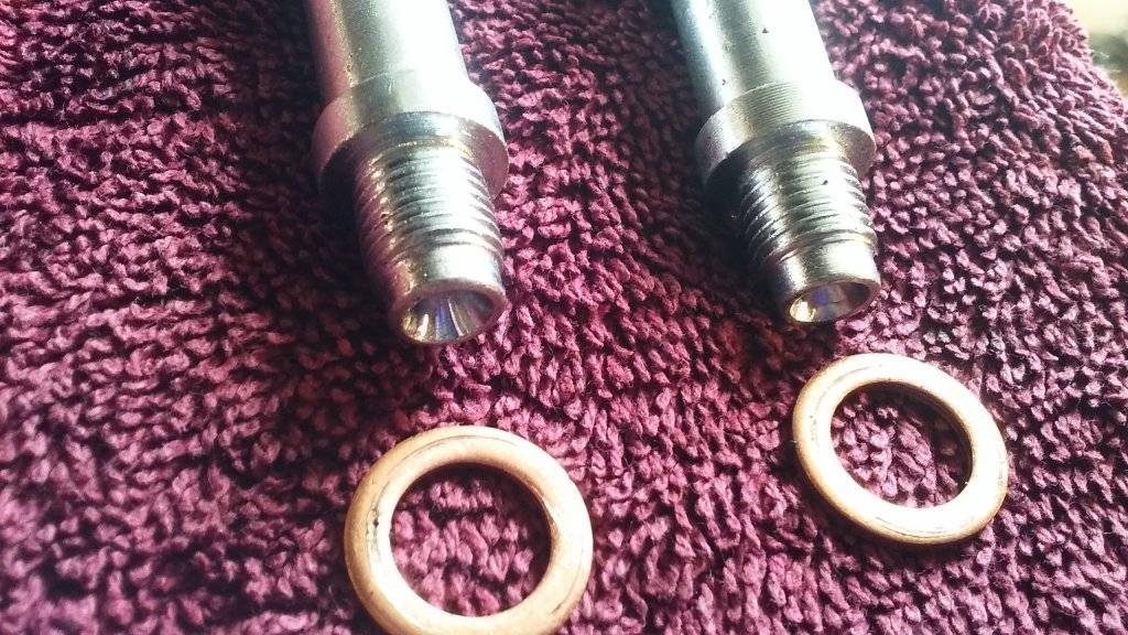

Does not appear to be any damage to the threads; washers seem to be in decent shape also - safe to assume each hose is screwing in properly then?
It isn't the threads that are in question. It's the sealing surfaces that contact the washers and the washers themselves.
Those washers don't look healthy. Replace them.
When you install them, keep in mind they are intended for one use only. Loosen the hose at the other end so the hose is free to rotate. Wipe everything off, some brake cleaner and a clean rag. Pay special attention to the surface that the washer contacts on both the caliper and the new hose.
The old washers look like they have been "squished" (for lack of a better word) so any worries about the threads are moot.
Tighten them once... very tight... don't worry, you'll break the fittings well before you'd strip the threads. Remember, one use only... don't tighten and take them back off. Tighten the other end of the hose and rebleed your brakes.

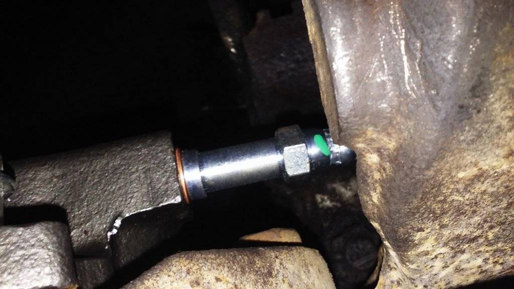

Ok. I think I have a couple of brand new washers exactly like the "squished" ones. This is not something that normal occurs though, or is it a hit or miss thing? I wasn't expecting brake fluid to find its way out from that area...and on BOTH calipers. I initially thought it was the bleeder valves were left too loose.
It's hard to say because the view is from my recliner and we're not looking over your shoulder.
It could be anything from there being crap under the sealing surfaces to something as simple as it wasn't tightened enough.
