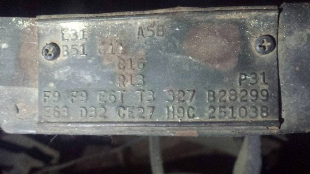

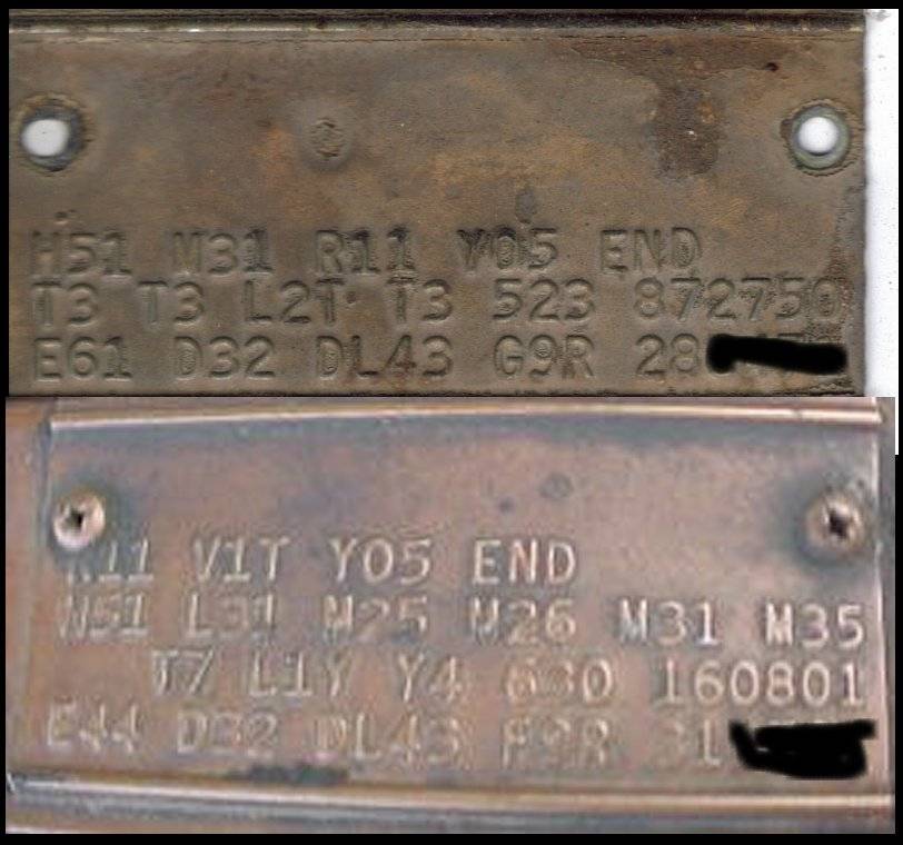

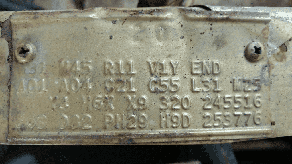

The tag is surprisingly devoid of options, was that the norm for that plant?
Early yes. By later in the year, Windsor coded a lot more. You start to see the change in May. (what was coded, when it was coded and even where it was coded on the varied by year, plant and time of year)

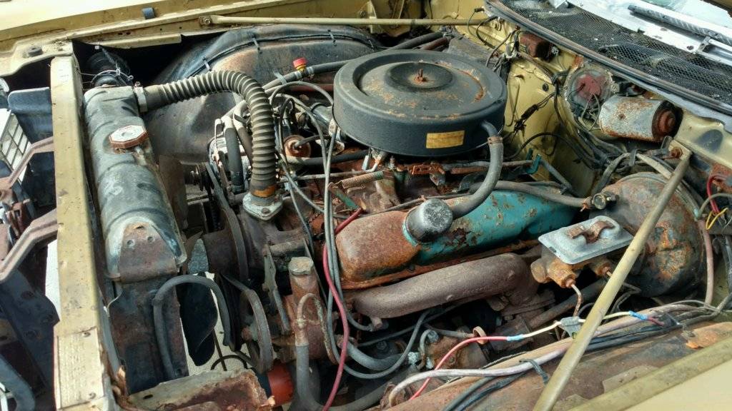

In regards to the air cleaner,correct me if I am wrong, 69 saw a shift from dual snorkel to unsilenced version.
Both are C body correct depending on build date and/or plant or what was available during manufacturing.
The 440 375 horse still used the dual snorkel air cleaner.

Thanks, the only thing I would add is that my late production 440 HP had the unsilenced air cleaner.
