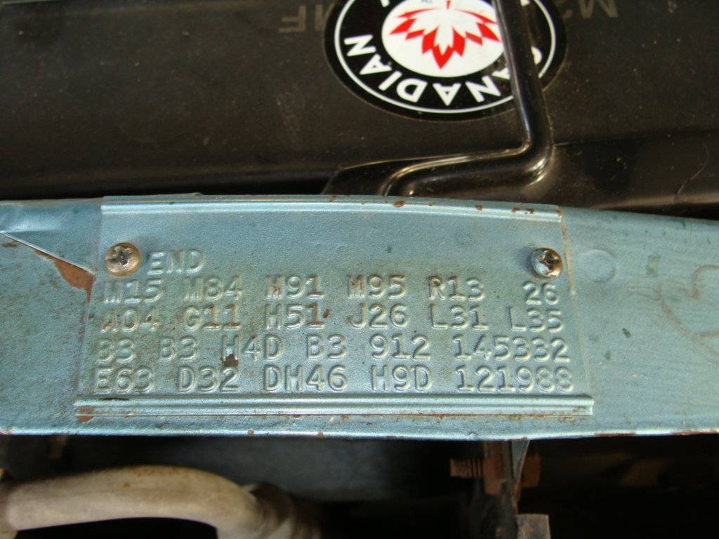

You are 100% right on this. My Challenger is a non R/T. It has everything a 383 magnum would have, taller pistons, good valve springs, dual snorkel, same AVS, N code in VIN, E63 on tag but no HP on the block, and no Magnum on the pie tin.

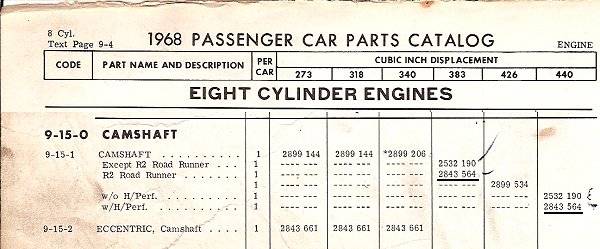

68 and 69 parts books. The 69 reads easier than the 68.
The 330 horse 383-4, 383-2 and 440-4 350 horse used the same 190 cam.
The 383-4 335 horse and 440-375 horse used the same 564 cam.
IF the C body 383-4 used the high lift cam, then the block will be stamped HP as an external indication to the assembly folks which cam is inside.
