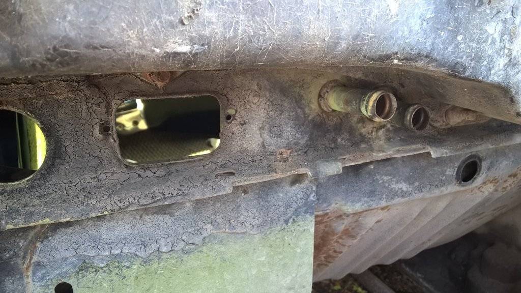

Here's the spot I was referring to, I just pulled the fender off today. This car ('71 Newport) had the same symptoms as you describe only on the passenger side though. The small raised portion below the rectangular opening (vac lines ATCTWO) no roman numerals on phone, sorry, is the main culprit though there are a couple other small spots underneath the heater tubes.
On the rh side, the a/c case CAN be a culprit, although both sides might indicate the kick panel seal against the cowl vents.
The a/c case (if equipped) is "plastic"/fiberglass. There is a rubber gasket that seals the two halves. The bolts that hold it together use slide-on "nuts" the bolts screw into. The slide-on clips go on one side and the rubber gasket is placed over them. As I understand it, there is no "drip pan" to direct condensate/water to the drain tube, so the bottom seam gasket is the main sealing area, other than the gasket for the case to the cowl.
When the bolts are torqued, the gasket is stiff enough that it usually will NOT conform to seal the edges of the clips, so there can be seeps there, that will later drop to the rh carpet and soak it under a rubber floor mat (OEM or similar) without it being noticed.
Before I knew of this issue, I was at the local dealer one day and a lady's '69 Fury had been resealed THREE times, with poor results each time. I thought it might be poor work, but when I later looked, as our '72 Newport had a similar issue, it was the way things were designed to work. A softer case gasket that would better conform to the clips would go a long way toward fixing the problem. As would dabs of silicone sealer on the edges of the clips before the case halves were installed together. Or a thin bead of silicone, smeared over the sealing flange, before the normal gasket is laid against it at the time of installation Several ways to do that. Might even just do the bottom half of the case rather than apply the sealer all around it.
