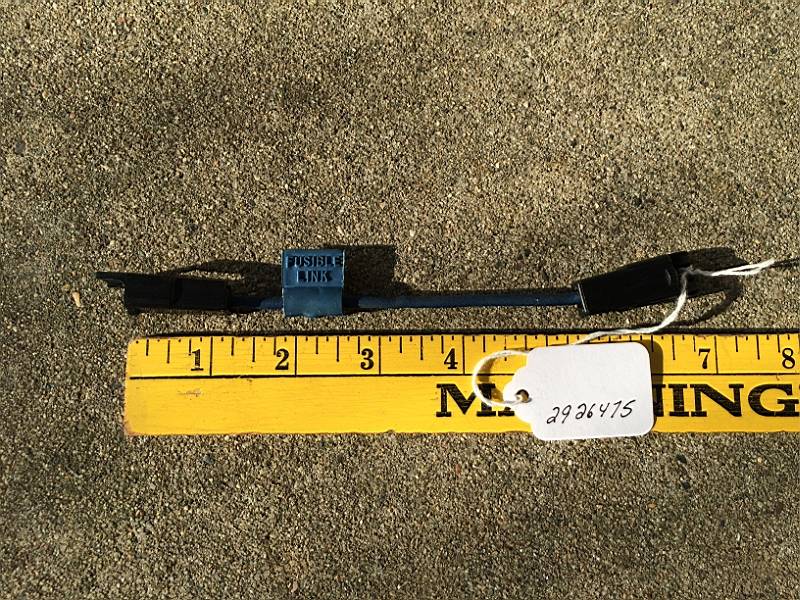

I didn't disagree or ignore what you said. It's just that the NOS parts and the parts manual don't identify the gauge. I think I need a # 14 fusible link, but that information is not given for the parts. How do you know if the one pictured is a 12 or a 14? My guess is part number 2889419 is a 14 and part number 2822692 is a 12. That's why I said I should avoid 2822692.
Fusible links normally come in colors to identify them. I use #8 AWG from my alternator to the battery with #12 AWG fusible link in light blue, the standard color. If you stick w #10 AWG, get a 14 ga fusible link. You can buy fusible link wire in a roll. A 10 ft roll runs from as little as $3 to $10, depending on who you buy from. Most Mopar links were 6 inches of insulation with 1/2" of conductor exposed on each end, crimped by the factory into their female slide connectors. I make my own links out of the right wire. THAT is an important point, use ONLY fusible link wire of the proper size. You can solder and crimp the connector onto the link, then use shrink wrap to protect any bare conductor, making a professional grade link.

The fusible link needs to be 4 gauge numbers smaller than the wire you are protecting. Example #10 wire needs a #14 fusible link. It also needs to be 9" long maximum.
Do as I do. Buy yourself a small SPOOL of fusible link wire in the size(s) you need. I use #12 with my 60A alternator, which I've wired in #8 AWG from the alternator charging post to the fusible link, cut to 6" under insulation, + an additional .5" stripped at each end for termination.

So, I'm a curious cat and would like to know why the two lengths were mention. 9" maximum? Or the 7" recommendation. I have a guess in regards to the max length, but would like to know. What was available locally was a 10' spool of fusible link. Looking at the one on my 68 it seems to be in the area of about 6".
I don't think it matters a lot, but the 7" length will work just fine.

Cut it at 7", strip 1/2 inch from each end, giving yourself 6" insulated conductor, and use what you need of the bared ends, trimming excess. I buy my fusible link wire in the 10' spools too and that's the only way I will. I tin the ends to keep the strands together and insert one end into a ring terminal usually, then make a mechanical joint into a split bolt or even a Scotchlok wire nut when joining it to the 2 sizes larger conductor its protecting.
I would hesitate to go as far as 9" in length, given the higher resistance of a conductor 2 sizes lower than the standard ampacity which is supposed to be protected by the fusible link. Longer links will in fact melt SOONER than shorter ones, given their higher resistance.
