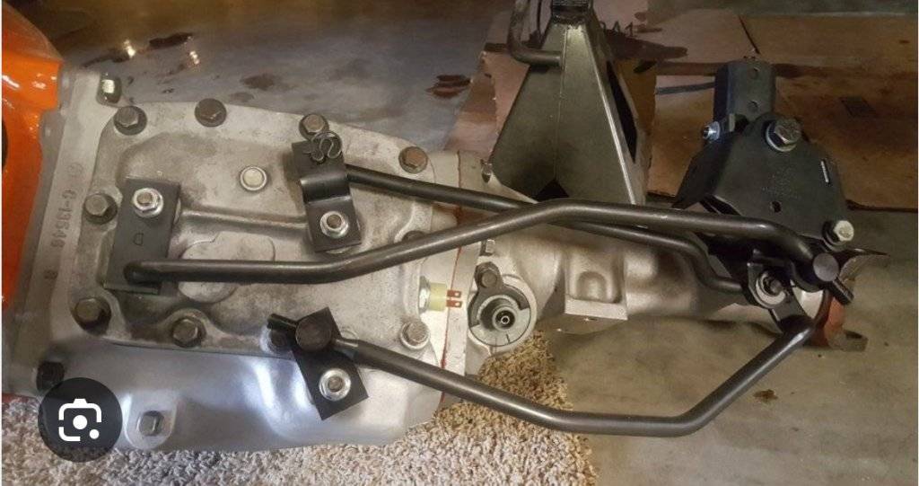

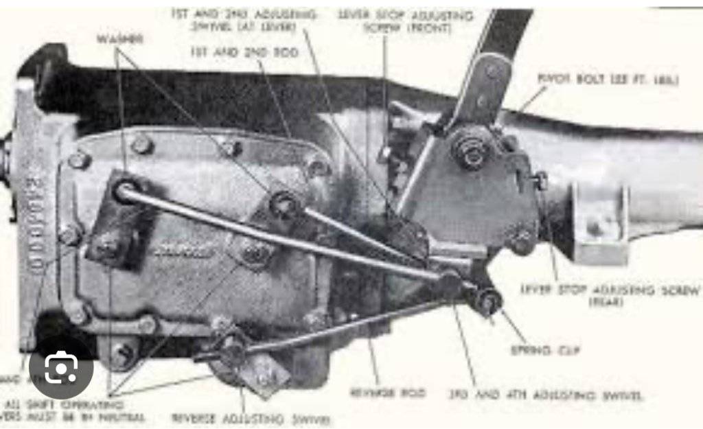

FYI if you switch from the 4 speed to the 3 speed with OD the 3-4 shift lever is upside down compared to the non OD 4spd. Don’t know what kind of shift linkage you have but might require some rod alignment. In the OD trans 3rd gear is where 4th gear is in the non OD trans and 4th(OD) is where 3rd is in the non OD trans. My OD trans was an aluminum housing and I finally ended up braking the housing after to many bang shifts. I ended up putting all the guts from the OD trans into a cast housing from a regular 4spd
Below are the Non OD and OD linkages for comparison.
