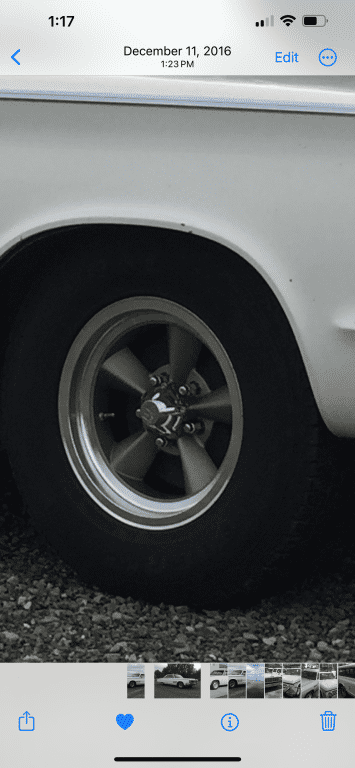

I have 3.23 gears in my 66 300, 383/auto with a 30” rear tire and it works pretty good for me. 265/70r15 on a 15x7” US Mag 5 spoke (like a torque thrust original but better looking in my opinion)

Here ya go. I like the straight spoke, and I think they nailed the dimensions. There are other straight spoke wheels that I do not like.

This is yours @Dads300 This is the US Mag? that looks the same as the one I was looking at. gives me another option.... It's a ways out anyway. not even thinking about it until the tires on her now are needing replacement.

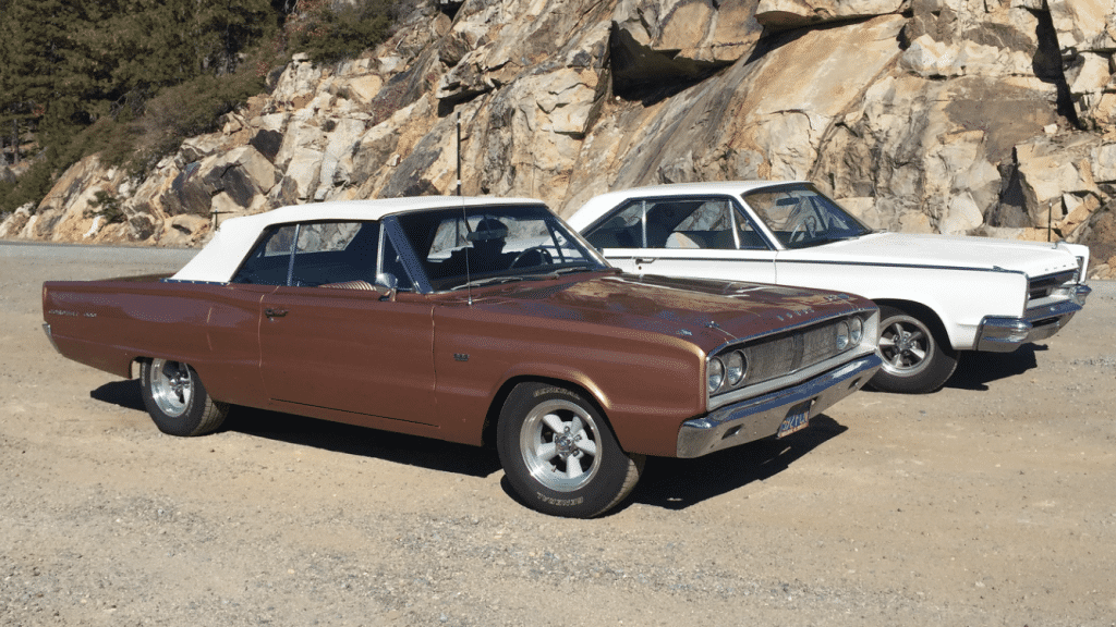

Yes, this is my wheel on my car. Yes, it is from U.S.Mag, 15x7. I really like the look of them. Here’s a shot with my 300 and my brothers coronet. His has torque thrust original (not D) and mine are U.S. Mag. I prefer the spoke shape and color on mine.
