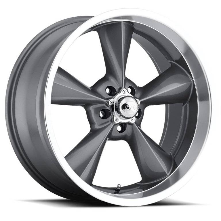

I like those wheels too. Torque Thrust Ds!
Technically I like these slightly better. very similar, but I like the sharp crease in the spokes rather than the curve... after all, a 65 slab side has very few curves but lots of sharp angles!
