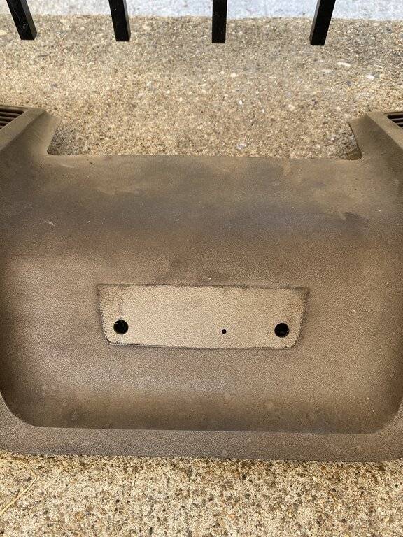

Biggest question is for you fellers who have dealt with discoloration of plastic products... for example, my rear seat frame (the plastic part that wraps the top of the back seat and frames the package tray), while it’s solid, is pretty severely discolored.. as is the console base. Likely from the decades of Texas sun.
I’m hoping to get some time in on that minutiae but am wondering where you have turned to for product? I’m aware of a lot of products but I’m just not sure about color matching. Did you take a decent example in and have it mixed? Was there anything out of the can, cleaner or otherwise?

Did mine 2 years ago.
I found a color match close enough at my local H.D.
Had to eyeball the color match from a sales brochure as it had been painted black years ago.
Found a nice Antique Bronze in a fan spray can to match the console and dash pad. Hit it with some satin clear to knock down the gloss.
As I had it out I Gorilla glued some alum sq. shaped tube at the defroster opening to take some of the warp out of the panels.
I'm happy with results!

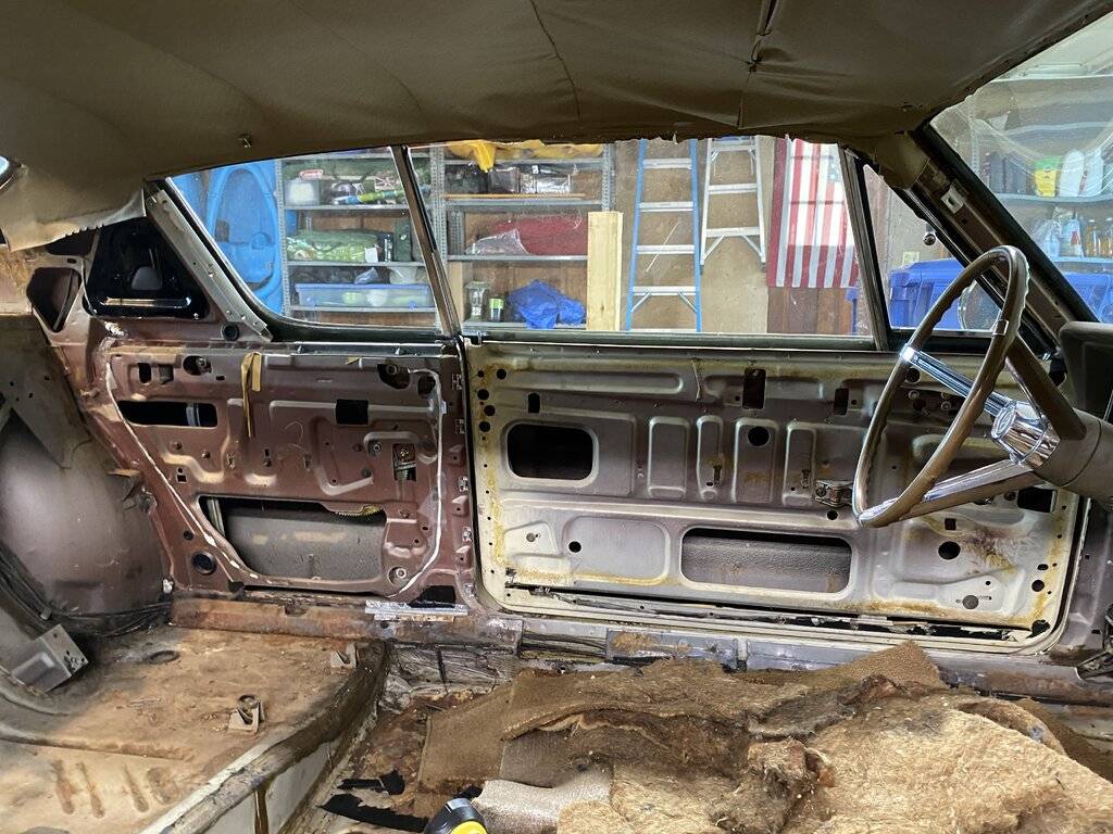

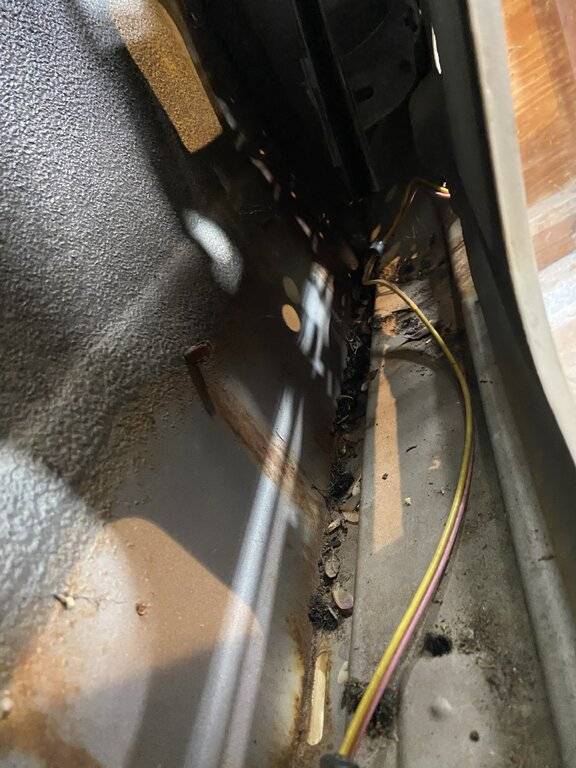

Digging in a little today, got the sail panels, door cards, rear seat panels, upper chrome, visors and rear view mirror out. Pretty surprised at the cleanliness inside the doors considering the sweeps are virtually non existent.
Front cards are savable, rears will require some creativity
hoping I can snatch the side windows and mechanisms out this weekend as basically every single one needs to be rebuilt.

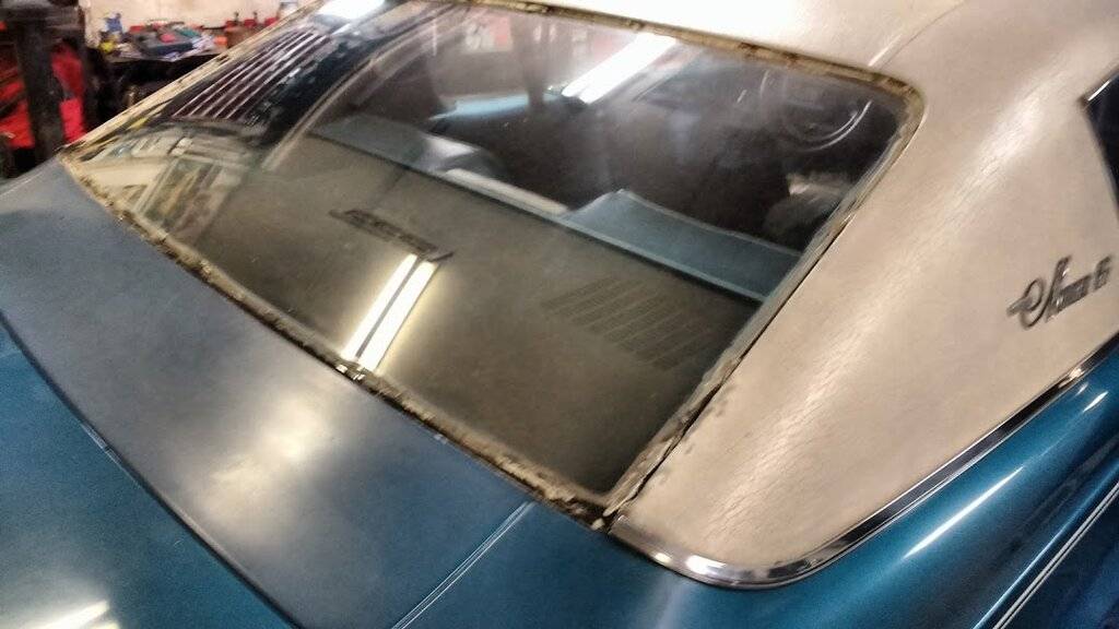

I haven't posted in a while, but have been following this thread, you project is coming along. The car looks real solid. My car is not too bad but with the back seat out I could see the 500 trim from the inside. The wide trim holds surprises, but I don't think it's a problem for you.
I don't have a good picture but maybe this gives you an idea. Made a patch panel a few years ago

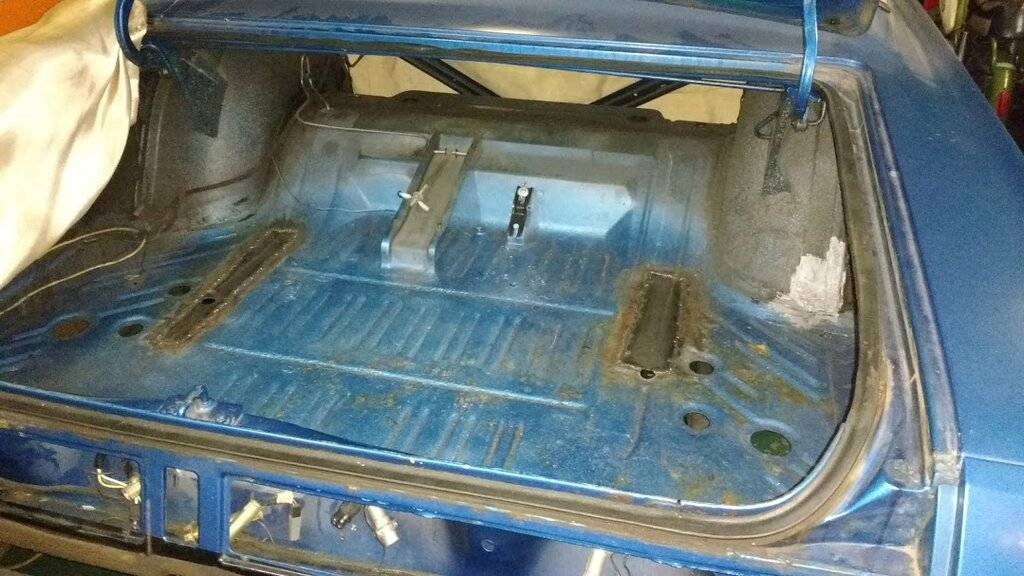

Yeah, I wouldn’t doubt it. Esp in the trunk area on mine, the rear window was leaking for some time... not sure how much weather this car saw but a enough Have the window channel for our and put a few holes in the trunk floor. We’ll see when I get the trim off.
I have similar issues with the rear channel, which had a driver quality repair years ago. I sort of postponed a proper major repair and vinyl roof removal by running a bead of butyl below the chrome. I saw pictures of yours at the beginning of the thread, you may be slightly worse off than me though. If your car was mainly out of the weather hopefully the trunk may not have fared too bad. Although driven daily, mine was garaged, and was rusty where the water would have pooled, above the sub-frame area.

My trunk is weak in the same areas. The issues with my window channel extend a good 1/4" beyond the lip of the trim into the dutchman's panel ... also out toward the sail panel on the driver side. It's pretty crappy but I'll pick away at it.

If I remember your sequence of posts, you were aware of the rear window from the beginning, so hopefully the extent of the rust is not too much of a surprise.
