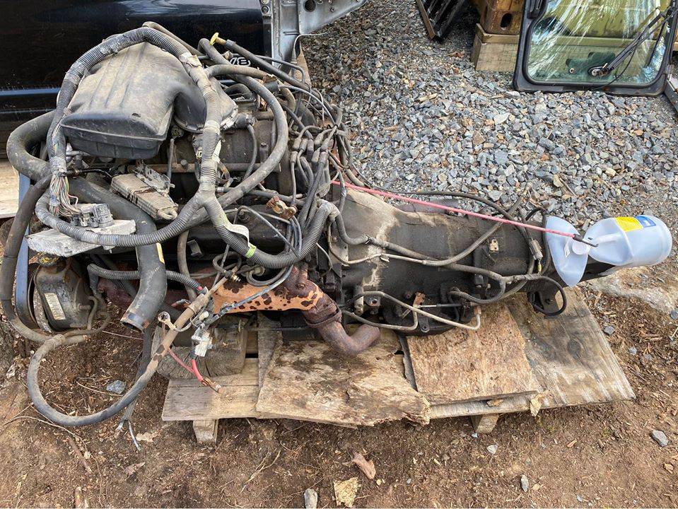

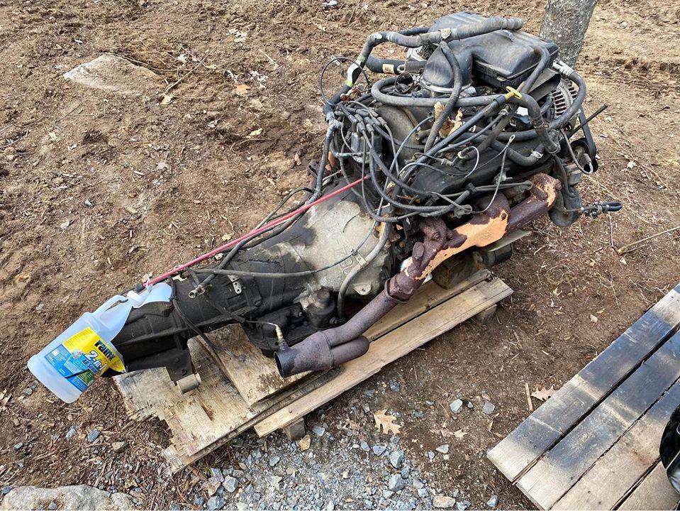

I am thinking about picking up this drivetrain from a 2000 Ram 1500 2wd with 100K on it.Have a video of it running before it was pulled and it sounds real good.The price is right and it's not too far...thoughts?:confused:
Sounds like a great project.
If the price is right and you in need of a refreshed engine, I say go for it.:thumbsup:
Looks good and would probably be a great option. Because I have never done this type of implant before I always wondered what you do for an ECM to control the engine. In this case you could likely use the existing truck ECM but how easy is it to change the settings.
Heads are cracked, but will never leak. Transmission was a POS when it was new.
It will not rev past 4500 RPM, and has nothing to speak of below 2200 RPM so rear gearing is very important.
If it is dirt cheap like 2-300 dollars maybe. Otherwise I would look for something without the factory screw ups built in.
For general information, when were those things "fixed"/upgraded? Just curious.
Just because it sounds good when pulled doesn't mean it's pristine/unworn internally. Buy it as "a rebuildable core" and NO MORE. Not to mention the issues of getting the PCM reprogrammed to fit your application, IF the Chrysler units will allow that without having to purchase some aftermarket gizmo for that purpose.
Enjoy!

1993 was when the cracked heads went on, along with the not great AMC valvetrain (fine for stock use). The beer barrel intake most likely will not fit under a c body hood but I do not know that for sure. If you change the intake to a more convention layout they are more geared toward higher RPM, but the cam is not, not to mention the intake that fits it is more than my suggested pricing for the entire combo. A 5.9 is a better combo hands down, bigger bore, longer stroke, 42 cubic inches all lend themselves toward a big car. You can get a regular manifold and redrill the bolt holes, but most people do not want to do this. Block wear wise, I have never seen one with a ridge at the top or the crosshatch even worn off so material is excellent.
It will be cool and fine just as long as it is cheap. The POS trucks those came in were a dime a dozen, so engine should be appropriately priced, nickel a dozen. Around here the asking price of a 4wd 5.9 gas truck is around $800 running and driving. Cash price after a few weeks on marketplace 4-500 will get it so engine is really not worth much.
I know the "Allure of the Hemi" is still alive and well, as it should be, but as so many of the balancing acts of getting the performance, fuel economy, and low emissions are handled electronically, how much better might these engines be if they have a dual-plane intake, a 650cfm carb (AVS2 or Street Demon) and longer-tube headers? In a 4200lb car?
MUCH of the improved performance of these (and the GM LS-family) engines is due to the 6-8 speed automatics, by observation. So how much might the performance of a LA or B/RB engine increase with such a trans behind them? With an appropriate rear axle ratio?
Personally, I was not a big fan of the Chrysler automatic with "two second gears". Seemed more of a marketing deal as others had 5-speed automatics with evenly-spaced ratios.
Just some curious thoughts,
CBODY67
There's a thread in here of a Gen III Hemi in a '67 Fury. The way it was done was quite neat and easier than expected. Seems like there are some adapter motor mounts for the engine and a need for a new rear trans mounting mechanism? And it seemed to work pretty well. Everything's laid out and was somewhat easily sourced from the salvage yards of his region.
There's also a thread or two on putting the later-model 6 or 8-speed TorqueFlite behind a non-electronic controlled engine. Not that hard to do, either, but some COST involved in the adapter to the engine. Plus pressure switches for the shift functions.
When everybody was going nuts over the then-new THM700 OD automatic, they quickly found that unless they went to a about a 3.42 rear axle ratio, OD wouldn't work until about 80mph, with the existing highway-oriented axle ratio with their THM350. With a carb'd engine and such. Some sort of EFI is needed to support a 60mph cruise rpm of 1500rpm with good performance and economy, plus electronic engine controls.
So, that still makes me wonder what a good LA or B/RB (in the form of a "torque motor that will easily turn 5000rpm and be comfortable with a 2000rpm cruise) would be like with the 6-speed and a 3.42 axle ratio?
Enjoy!
CBOODY67
How do you know all this ****?? :BangHead:
I have found a good, cheap '91 5.2 pre-magnum engine up north with less than 80K on it.A few advantages to the late roller cam LA motor.Good heads, better valve seals ,more accurate cam actuation and higher compression to start.
