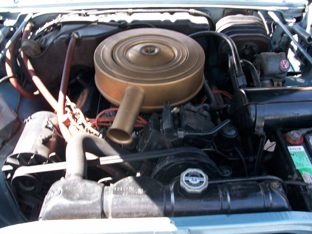

I agree with you assessment. I had my '59 Imperial starter rebuilt by Fondyautoelectric.com in Fond du Lac WI. perhaps you have a rebuilder closer but if not give them a call. My starter was rebuilt 36 years ago with my generator by the same company.
